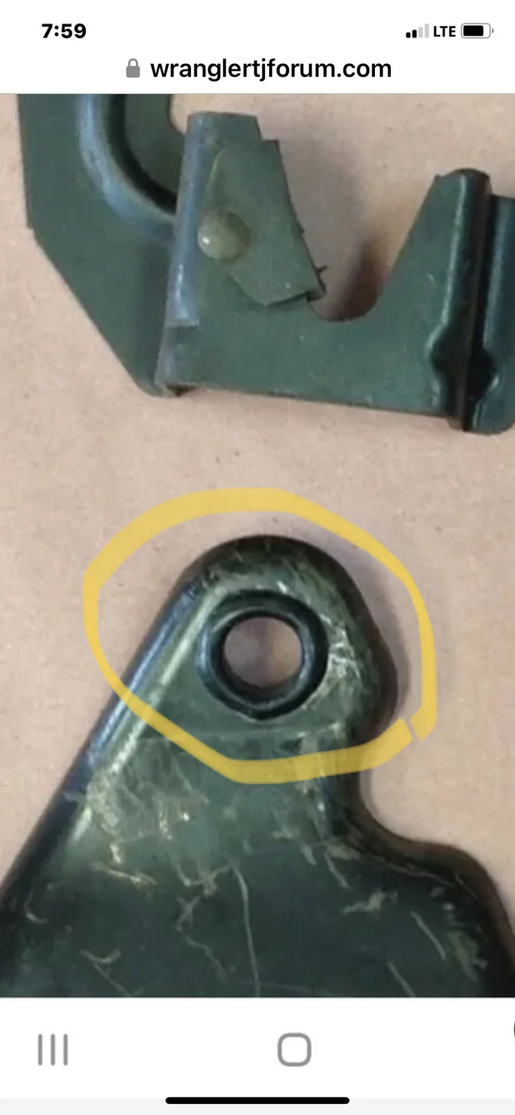

I have been chasing down a metal clank and rattle in the rear that I hear when I hit bumps etc. I have checked and tightened all suspension parts and finally figured it out today. One of the plastic grommets that the rear seat pin goes into is missing so it bounces around slightly to make a metal on metal sound. The driver side has it but the passenger side does not.
Anybody know I can find one…or exactly what it is called?
It is circled in the photo. Thanks!
I would just go to an Ace Hardware that has a good small parts selection. Chances are you'll find something that will work.

You were right. Went to local hardware store and found a rubber grommet that would work.
When installing it…I pushed the seat pin through it too far and the new grommet came out and went behind the bracket. While fishing it out I found the original grommet. 🤓
