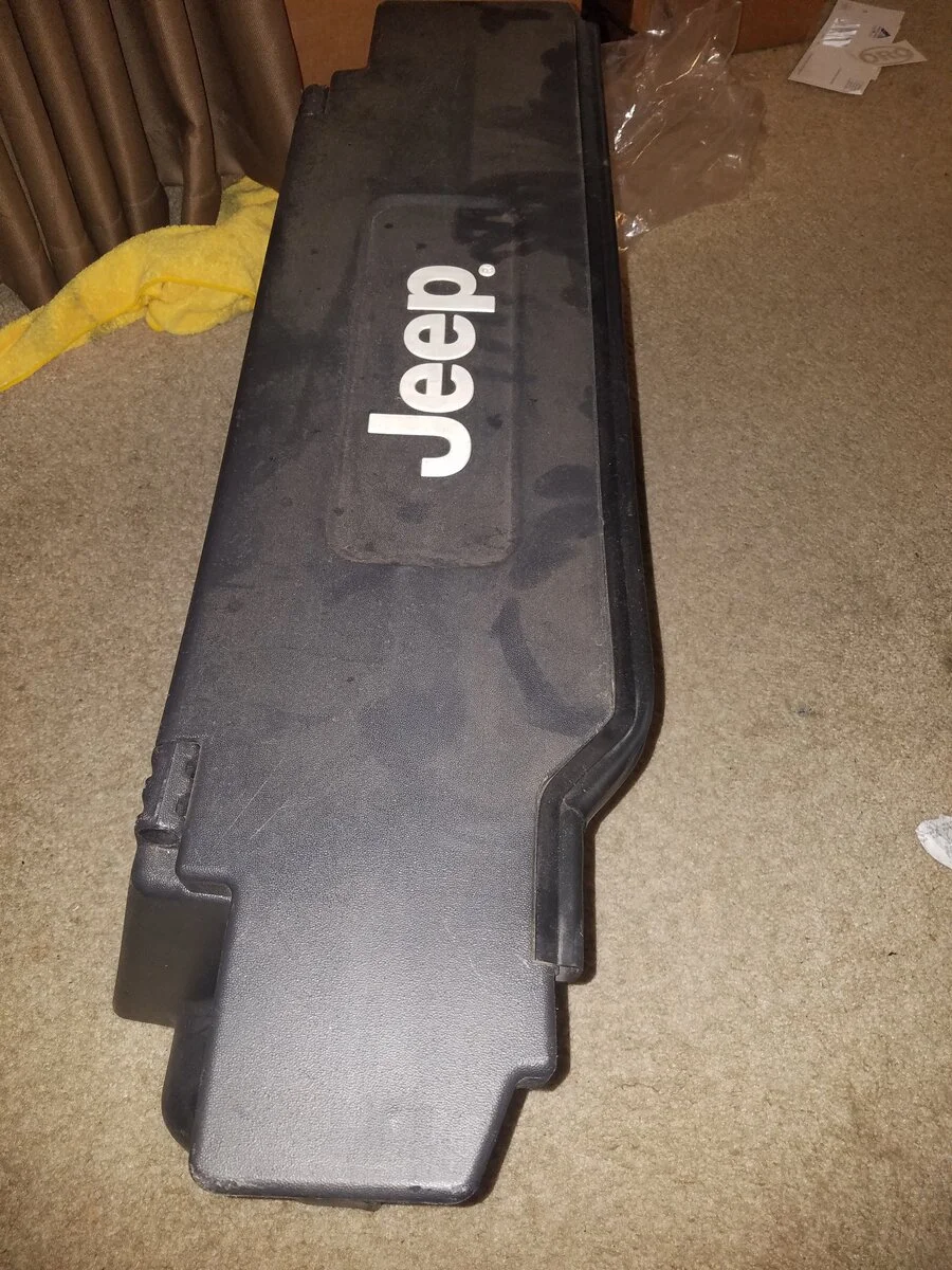

Mine (96) came with a Jeep insta-trunk installed. Held in by 4 or 6 bolts and completely block the front and top. Seals against the tailgate. Just shy of being as high as the tailgate. So about perfect for groceries to fit. Good quality plastic panels. I'm not sure the actual name, but it's made to work with the rear seat and looks like it belongs, unlike some 'boxes'.

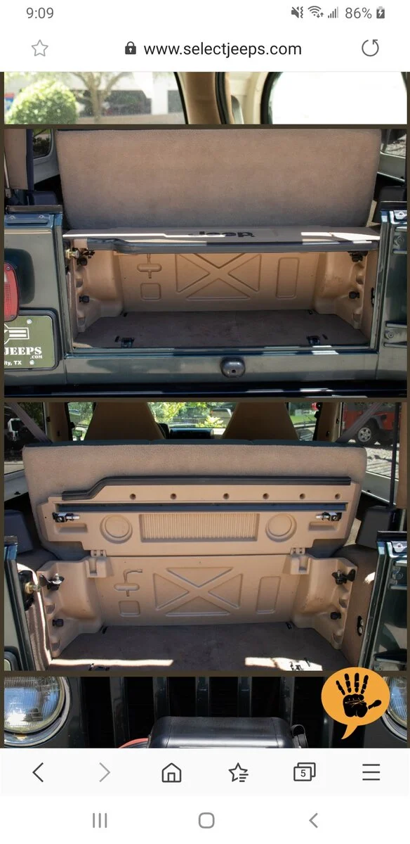

Was it this?
That is exactly what I'm looking for. The issue with the tuffy and instatrunk is the deck is solid on the top so I would need to unbolt the whole assembly in order to use the anchors in the trunk when I want to put the kiddies in the back. I'm assuming the top deck of that folds up or looks like it does by the hinges in the back? Is it any higher than the rear seat when folded up? Trying to find one is proving difficult in Canada but that is my ideal setup. Do you have any pics of it installed by chance?
