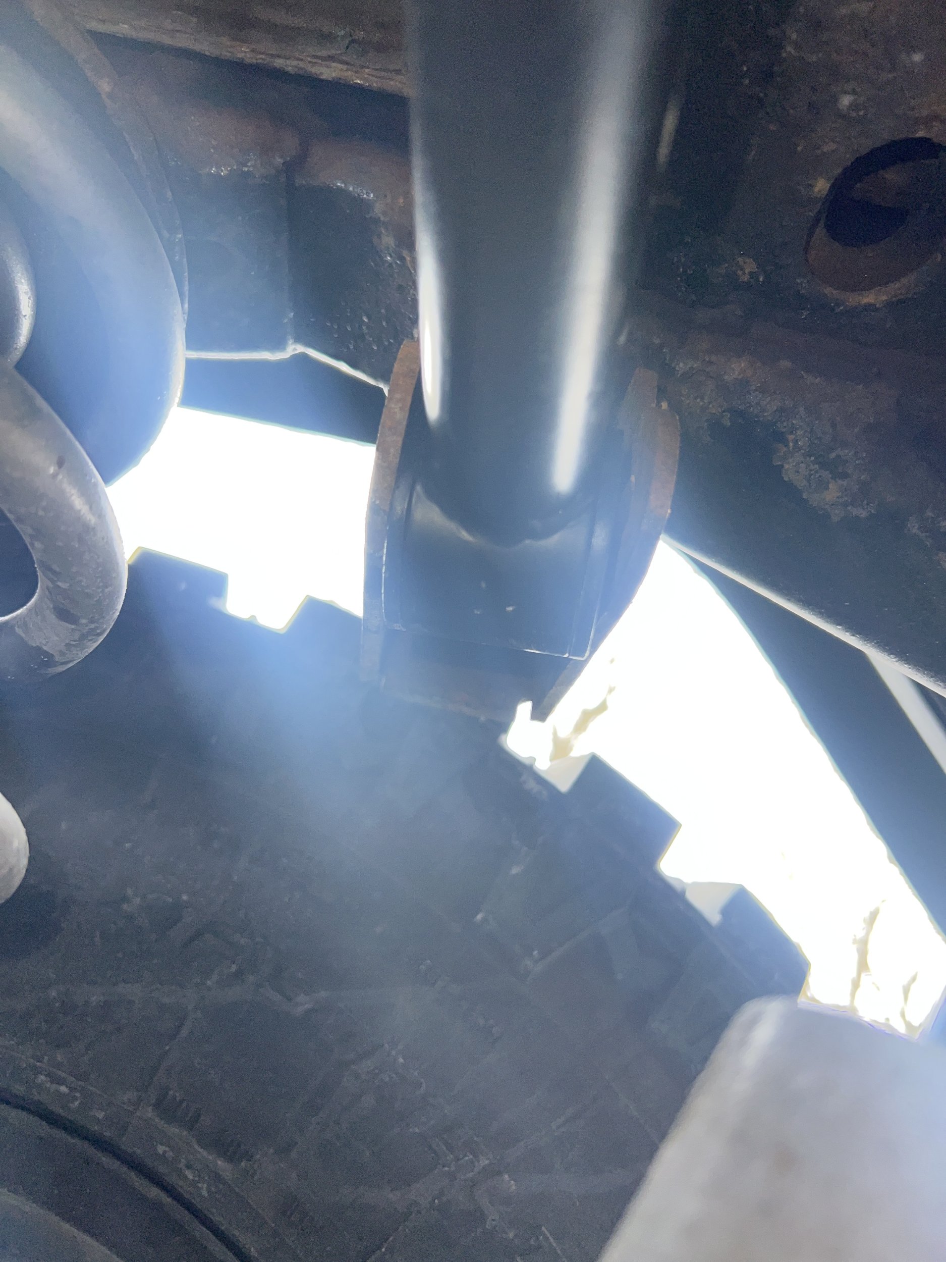

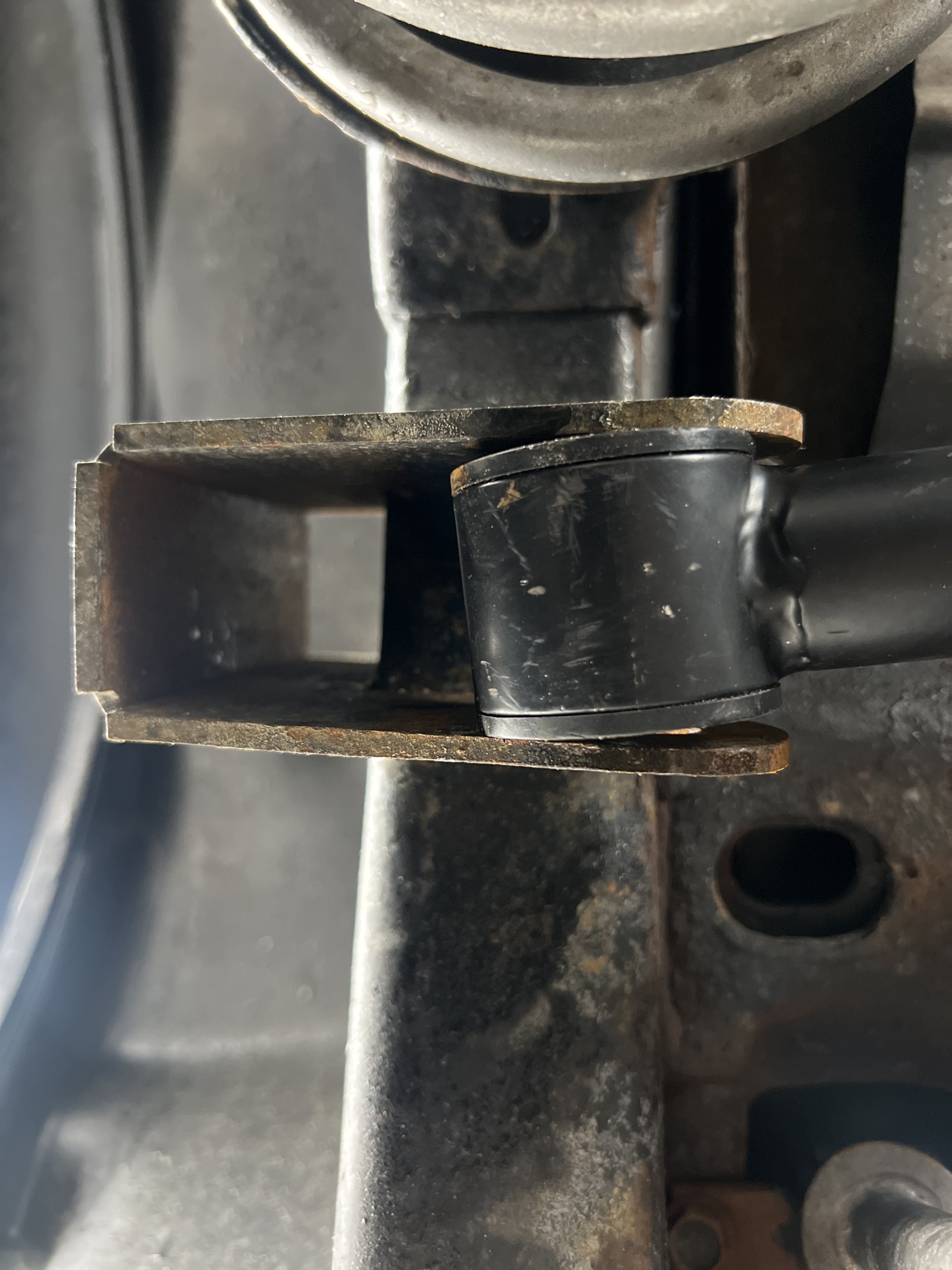

I was able to get a couple pics of my problem they should be below:
(i know the bar isn’t that close to the holes but it does this no matter the length of the bar)

To confirm, I'm assuming your axle is moved forward in the control arm arch, so it's like the track bar is pointing a bit rearward at the frame side, right?
I'd assume in a short arm the CAs would be pointing down with 4" of lift. If so, squatting it should push the axle back and make it easier to align. Could load up the trunk with something heavy or have a fat friend stand on the back. If you were closer, I'd come weigh it down for you, lol.
Doesn't look like it will be very happy in the long run, but should get your bolt in for the short term.
You are correct, the bar is pointing a bit rearward. I will try your idea out and see if it works. I might also take some measurements to confirm if the axle somehow shifted back or forth

If you get a relocation bracket, it will resolve that. The bend forward in the bracket will cause the track bar to align as it should. As @gasiorv stated. with an adjustable trackbar it will be that much easier. if your track bar is not adjustable, then the relation bracket is needed that much more.

I didn’t have that problem,looks like they maybe welded it misaligned,maybe rust made the location options limited?
