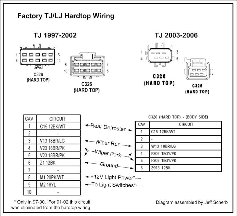

I have a 2005 wrangler sport. It has switches for rear window defrost and wiper/wash.
I believe the hard top is from an earlier version, because of the wiring harness attached to it. Different plug than the internet shows for a 2005.
Previous owner tried to join the 2 electrically. I need to uncobble his mess, and rewire it correctly I hope.
What is the difference between the rear wiper motors for the 2002 and prior and the 2003 and later hardtops? Rock auto has a listing for the 2005 flavour, but nothing for the 2002 model.
And, what setting does the rear wiper run in when the switch is turned on? Does the wiper run constantly or is it intermittent? I have constant power on one wire going to the wiper, but nothing on the other two. But I’m not convinced it’s wiring correctly.
Thanks
