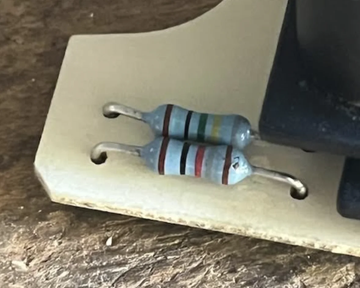

Removed the switch and tested the bulb; the bulb tested good, but there was a overheated resistor on the circuit board which heated up the copper traces; I could not repair the circuit board and was not sure of the specs for the resistor due to overheating.

Received the part in todays mail, tested the bulb, components and traces; the components and traces tested good, but as I suspected... the bulb was bad. Replaced the bulb on the circuit board and installed the switch; the red Passenger Restraint indicator on the instrument cluster went out almost immediately.
My suspicions are that the resistor had been going bad for some time which caused the bulbs to burn out prematurely.
