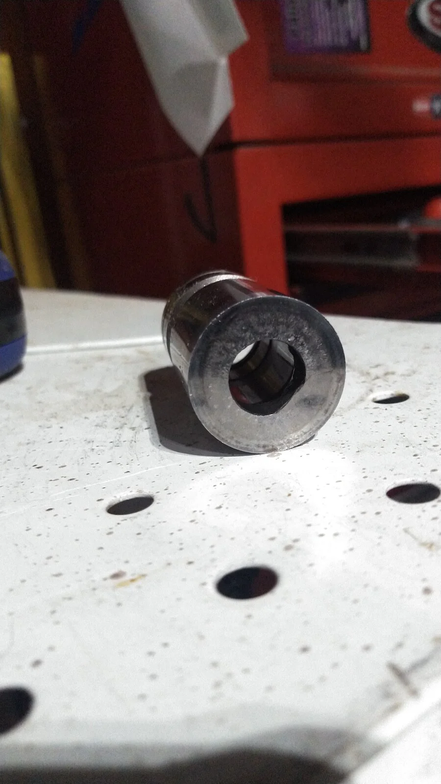

So next we decided to do a leak down test. We had done a compression test earlier and found each cylinder between 125 - 132 psi. The leak down isolated the problem to cylinder number 5. We manually turned the crank and the #5 exhaust stroke was leaking badly. Pulled the valve cover and sure enough, one of the cylinder #5 rocker arms was limp. Pulled the head and found out why......
