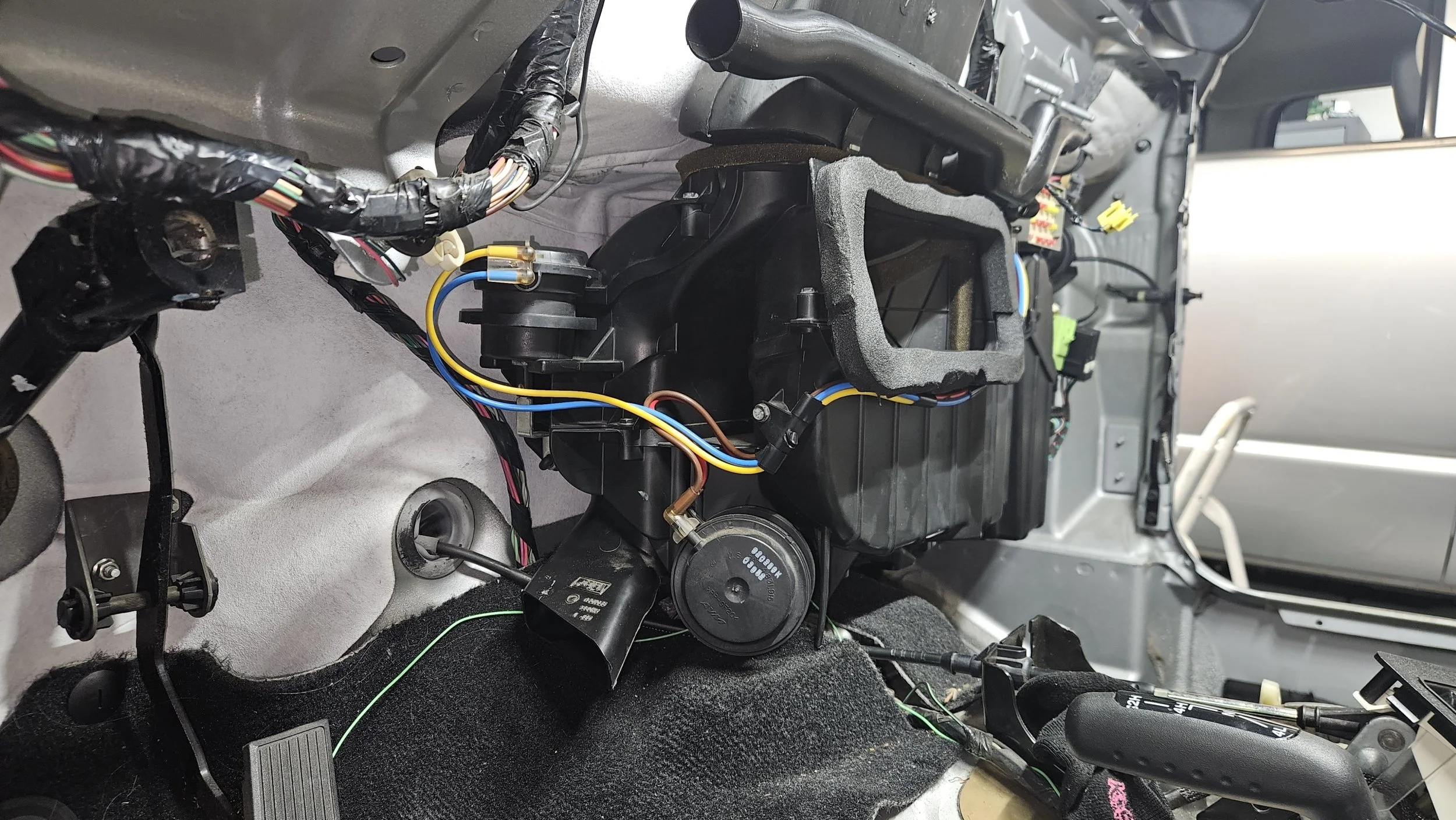

Make sure the vacuum actuators accessible from the driver's footwell are operating while changing modes and that they're connected to mode door levers on the HVAC box. There's one just over the transmission hump that may be hard to see. Check the vacuum line connection while you're there.

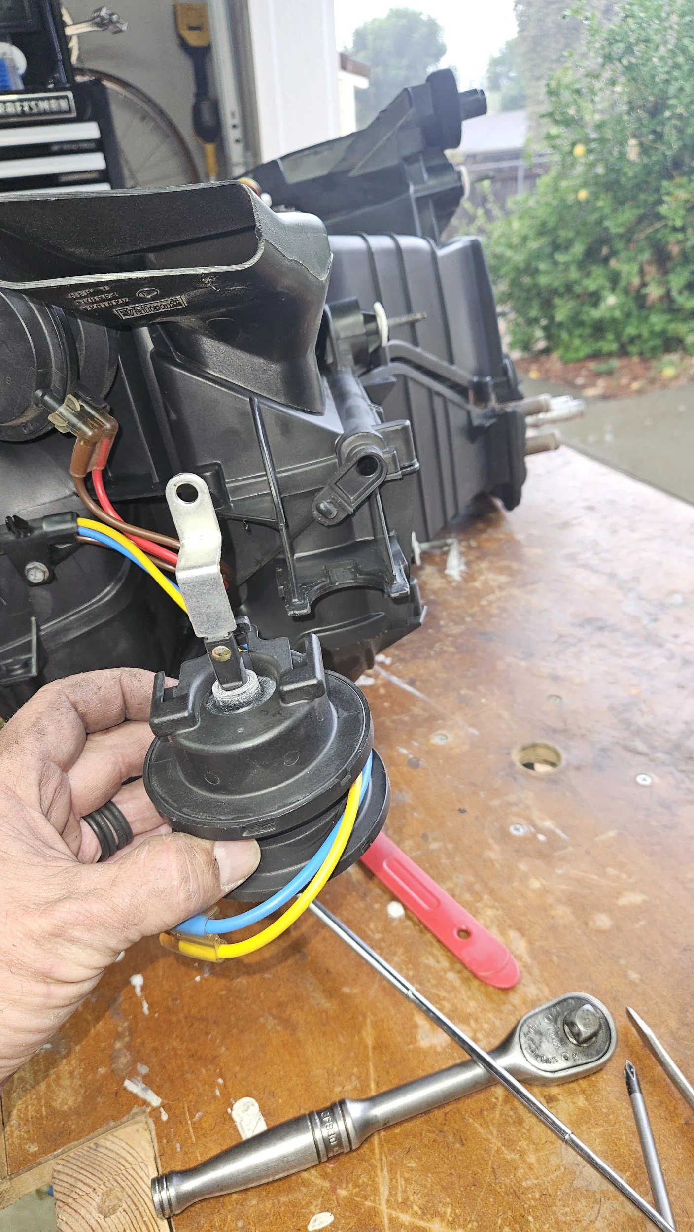

You would have removed this (top) actuator from the lever to separate the upper and lower halves of the box...

Before I reinstalled my box I used a Mighty Vac to generate vacuum and cycled through all the positions and verified function and tested for leaks.
