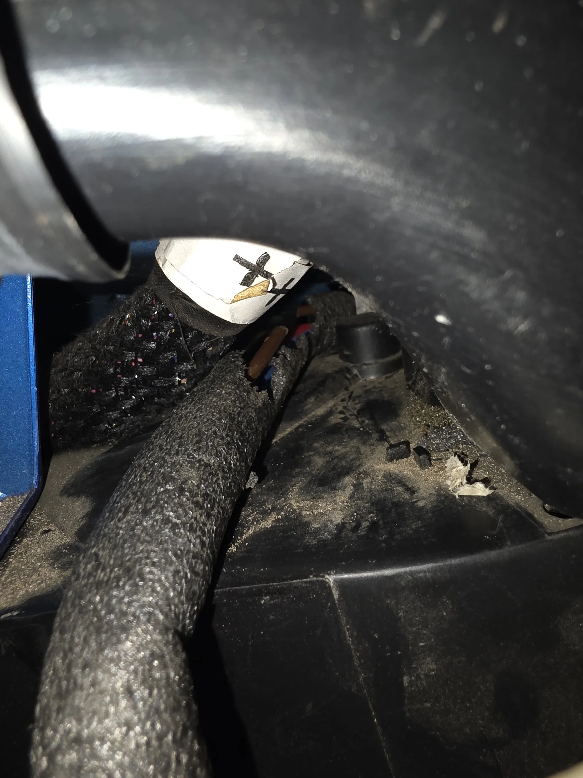

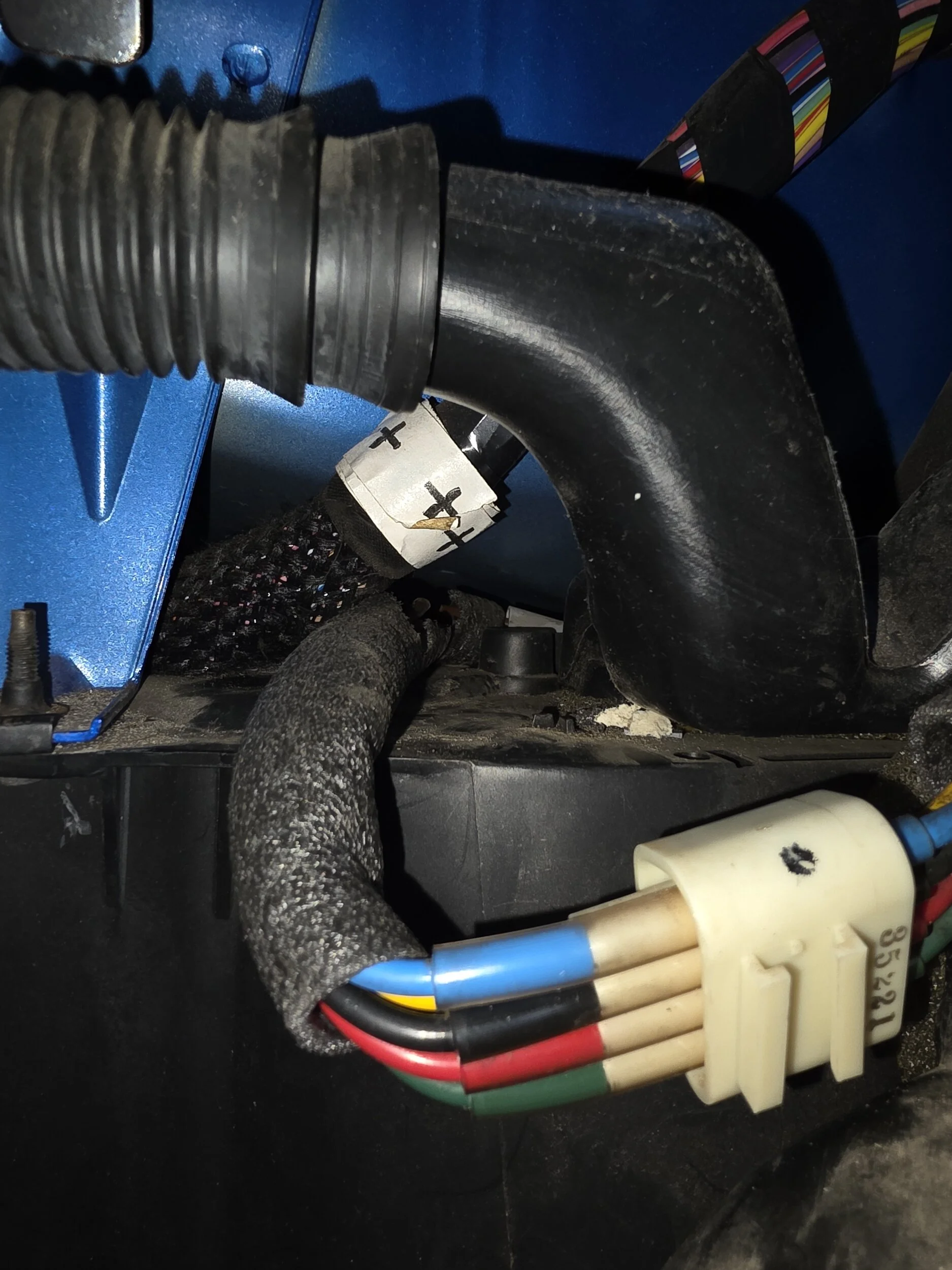

The mechanic pointed out where they found the leak, this is behind the glovebox (remember it's RHD) in the first pic you can see the hoses coming from the control panel appear to be ok, but the hoses heading back are chewed - the brown one is definitely missing an inch or so but it's hard to tell if any other hose is damaged. But I can't see any easy way of getting back there without removing the dash.

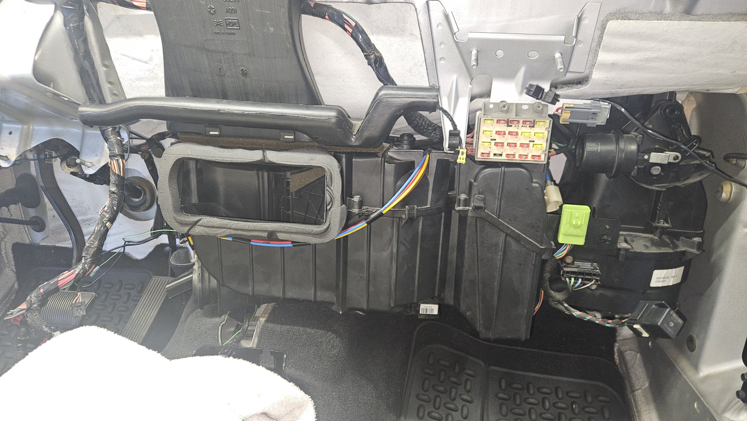

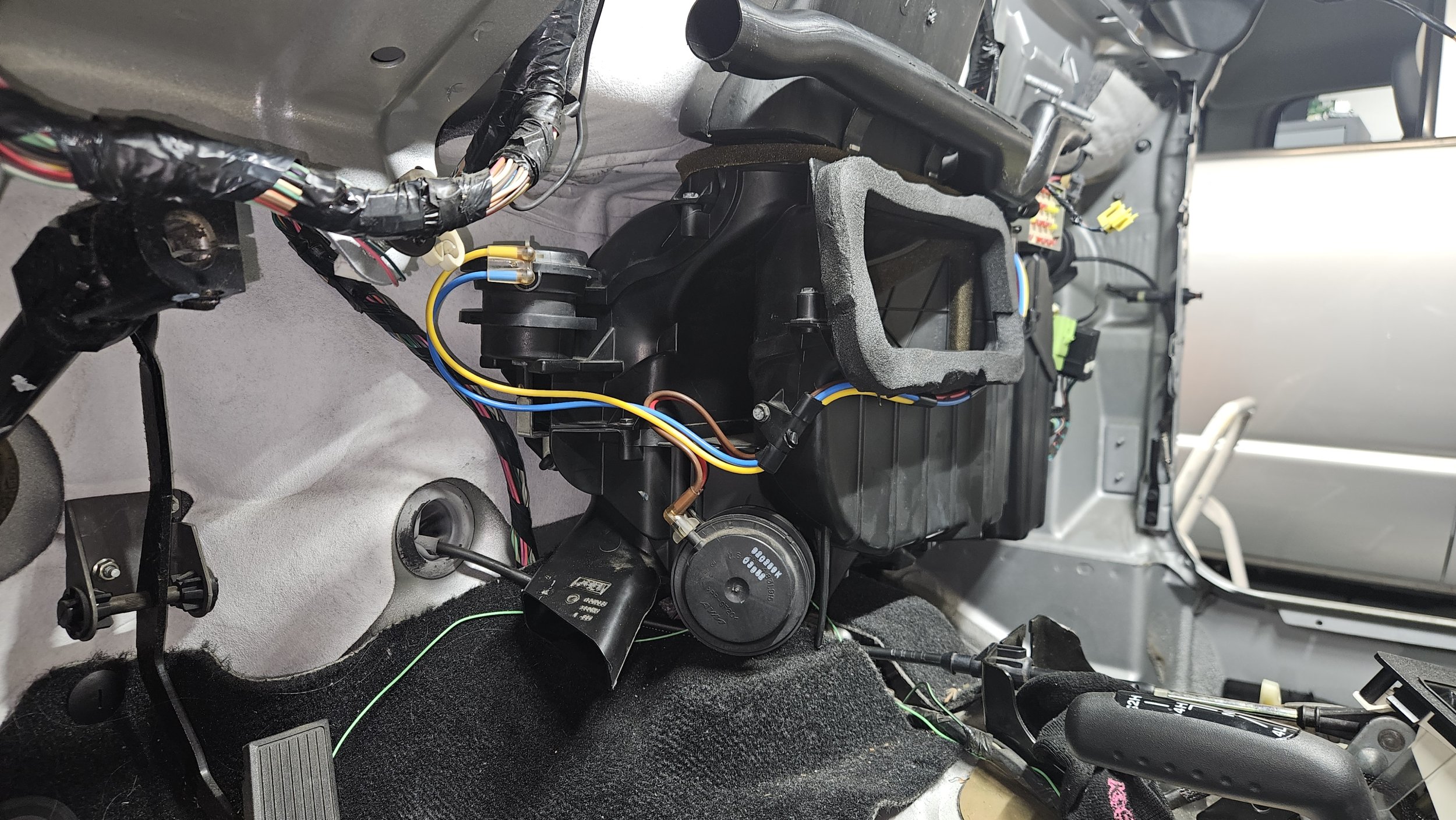

Here are a couple of photos showing how the actuator vacuum lines are routed on an 05 LJ. Your HVAC box made different depending on the year. If nothing else, it will give you an idea of what to look for under your dash.
There are two actuators that are accessible from the driver's side footwell under the dash, and one actuator visible from the glove box for the recirculation door. The lines are routed behind a HVAC support bracket behind the glove box. If you remove the screws on the fuse block and move it out of the way, you should be able to feed the vacuum line harness out after disconnecting the the lines from the actuators.
Thank you - very helpful pics!
