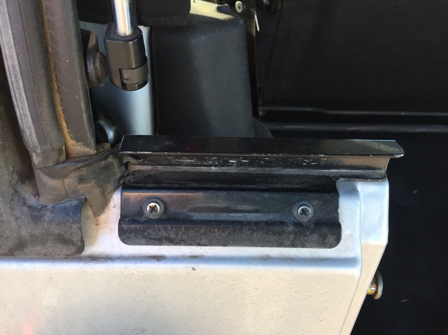

I will take a picture for you in a couple of hours.
Here is a picture of one of the rear brackets. There is a bar that slides inside the softop rear window bottom and that bar tucks under these brackets. My Jeep already had the brackets but what I don’t remember is whether the top comes with the bar, or does the bracket kit contain the brackets and the bar. I ordered the bracket kit and then learned I already had the brackets.

Forgot the picture.
Ah. Yea I don’t have that. Looks like drilling into the tub will have to happen in addition to the brackets. Thanks for the info and picture. It helps in making the decision when the time comes

Your tub should have some dimples where those brackets mount. They usually come with self-tapping screws. When I ordered the door surrounds last from Bestop, they came with the tailgate bar and brackets in the kit.
