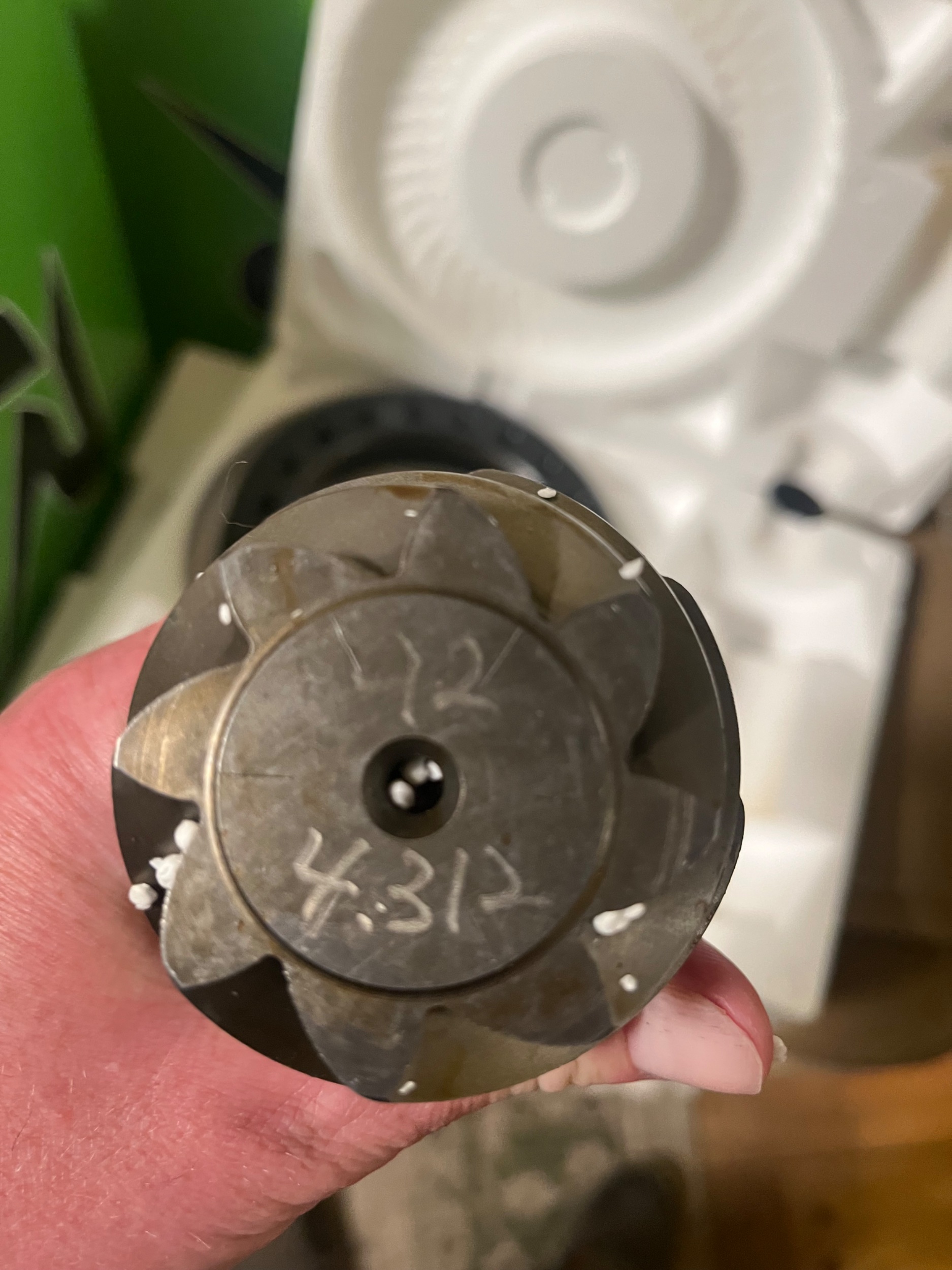

I am getting ready to do my gear install and had a question on the numbers etched in the pinion. They are revolution thick cut 5.13. There are two number in the pinion, 4.312 which I understand is the standard pinion depth of a Dana 44 and the other is 92 which I understand is the gear set ID which matches up to the ring gear. There is a 006 on the ring gear. I didn’t see a + or ~ number to give a deviation from the standard pinion depth. I figured I was missing something here. Just looking to see if can get a comparison with the stock pinion to get a starting spot for shims? I attached a picture.
The easiest thing to do is start with the shim stack that was in there. It should be pretty close.
