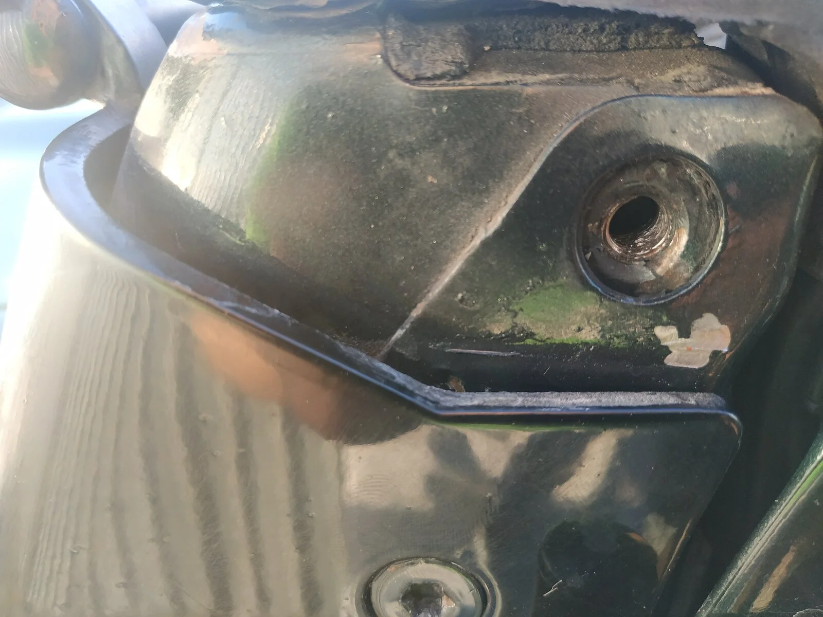

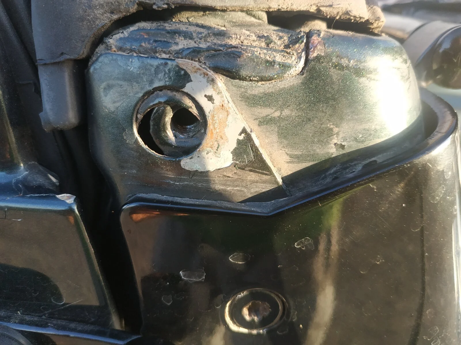

Could this be also the reason? The nest for windshield to tub attach bolts are not even. The bent nest side actually seats correctly and correct nest side's sports bar is unadjustable

Hope i found the problem. The roll bar is bent/different height. Fingers crossed that new roll bar will solve the problem. Its still on its way to me, also i guess rhd tub will have transfer case mount and boot at different side, firewall conversion would be enough for me simce i will do everyting alone at someones backyard given for time.
