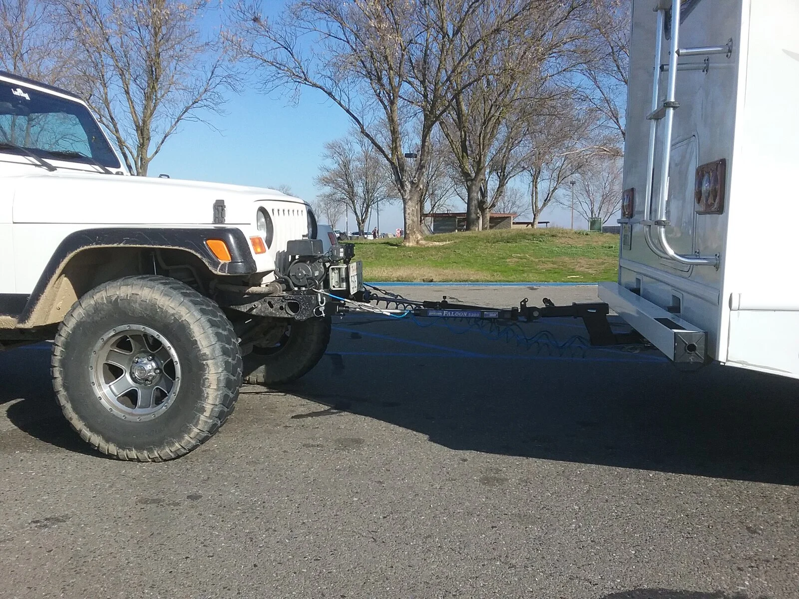

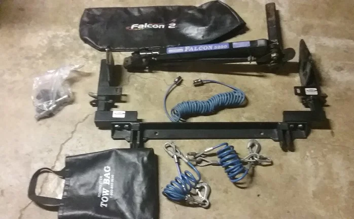

I picked up a Roadmaster Falcon 2 from a local guy.
I grabbed it because it was almost new and his price was an offer I couldn't refuse.
It came with everything in the pics.
I will use it to tow the jeep to our hunt unit - 5hrs away- all highway.
Whos running the Falcon 2?
Tips, tricks, does and don't?
Thx!
I've run a Falcon towbar pulling my TJ with my RV. Worked fine. Make sure when everything is connected that the towbar runs fairly level from pull to towed vehicle
I have a Roadmaster Falcon All Terrain tow bar. It is a nice unit and straightforward to use.
I don't see safety cables or a power cable for tail/brake lights in the photo.
Make sure you get both.
