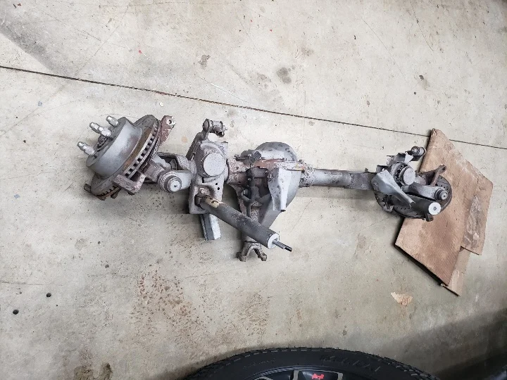

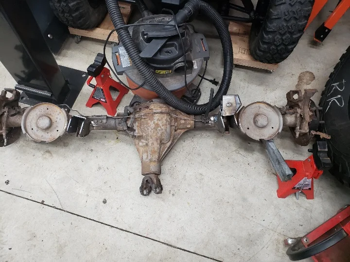

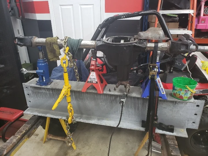

I took a gamble and bought a set of complete & bent TJ Dana 44 axles. Visually, both axles have a banana bend on the passenger side, bent towards the rear of the vehicle). Someone did a little bit of work to them only to realize the investment wasn't worth it or didn't know what they were getting themselves into. Axles were blasted and new rear UCA mounts were welded on. I plan on stripping them down to bare housings, torching everything off.

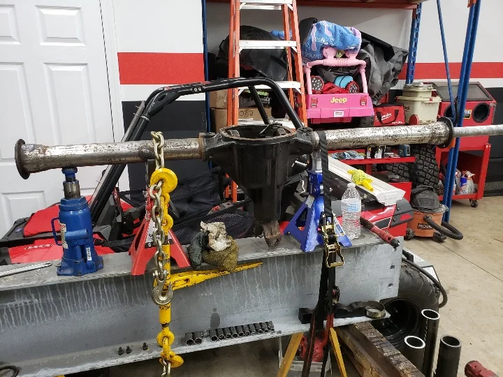

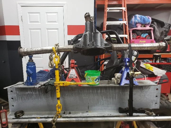

Next, I'll straighten the tubes with the chain and bottle jack technique. I may even add some relief cuts in the oem tube, depending on the severity of the bend. I had some luck with back-side relief cuts only to re-weld and have the tube drawn straight to a set of JK axles.
With the brackets removed, I may add extra strength by welding outer sleeves (3", 1/4" wall to the front and 3-1/4", 5/16" wall to the rear).

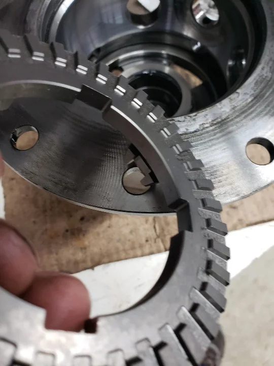

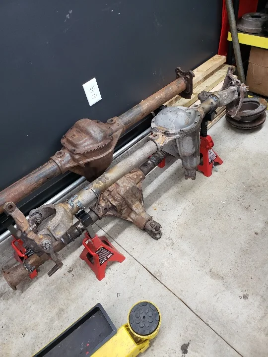

A little progress. Axles are stripped down to tubes. Front axle is bent 1/2" while the rear axle is bent 1".
Good news: Both lockers look like they were never used. Air bladders work and locker rings have no wear on the teeth. Also, the Degree of separation for both knuckles is 13.6 so the "C's aren't bent.

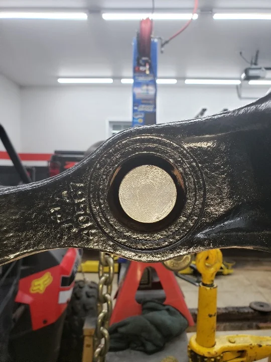

O.D. of front axle tube is 2.500" +/-
O.D. of rear axle tube is 2.6200" +/-
For the front axle, 3.00" O.D., .250" wall DOM will be used for outer sleeves.
For the rear axle. 3.250" O.D., .312" wall DOM.
Amazing to see how bent that tube was!

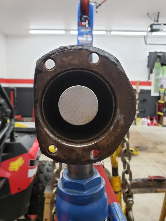

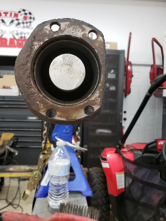

What are you using for the center-bore bar in the tubes? Just some machined stock?
That is hell of a section of steel I-beam to have laying around!

@sierradmax Do you still have that axle straightening setup? I've got a TJ Rubicon rear axle eating my tires with about 5/16" toe-in and 5/16" camber. The way I calculated it that's about a 3/4" bend along the housing. I was considering a similar axle jig to yours, but I'm in MA so I'm wondering if there's chance we could work out a deal where I could use your setup?
Yeah, I do. Send me a message.
