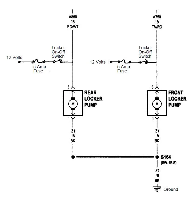

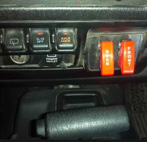

This might help, it's basically how I wired mine. You cut the wires off the locker air pumps and provide each one with a switched source of 12 volts. They don't draw much current so 14-16 gauge wiring is fine. I used standard heavy-duty on-off switches and then installed those two orange flip-up covers. A buddy that understands the basics of electrical circuits even a little bit should be able to help you get this working.

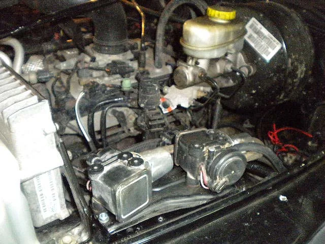

On top of Jerry's post, most relocate their pumps to the engine bay but if you're not doing a tummy tuck then the pumps can be wired from their current location on top of transfer case skid plate. It's a very easy job to accomplish and you'll enjoy the new way of locker activation.
I have been thinking about doing the pump relocation at some point. Thanks

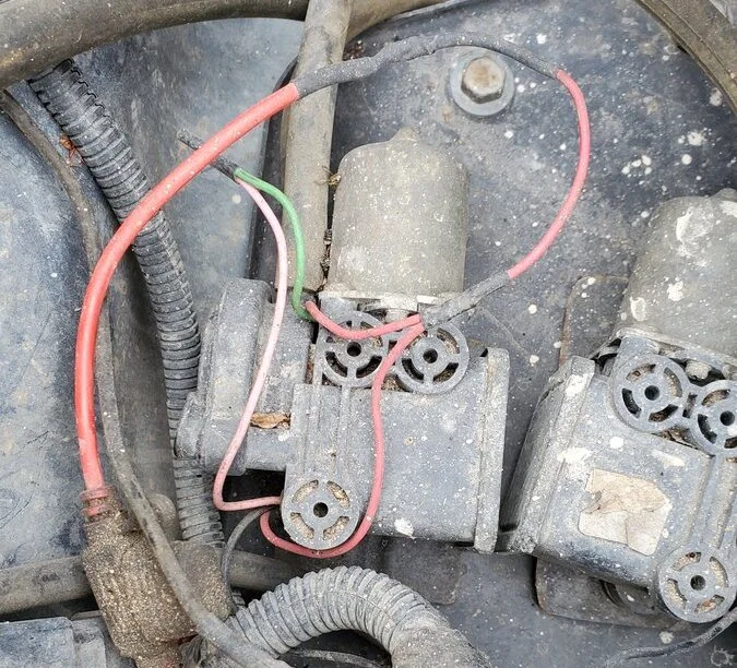

Here's a picture of a lockers wiring out of the pump. (not mine)
The pink and green are terminated as shown, the two red wires are joined together and are fed after your 12v fuse & switch. The black wire is your ground wire. Fuse should be installed close to battery for each locker pump and not like this picture below.

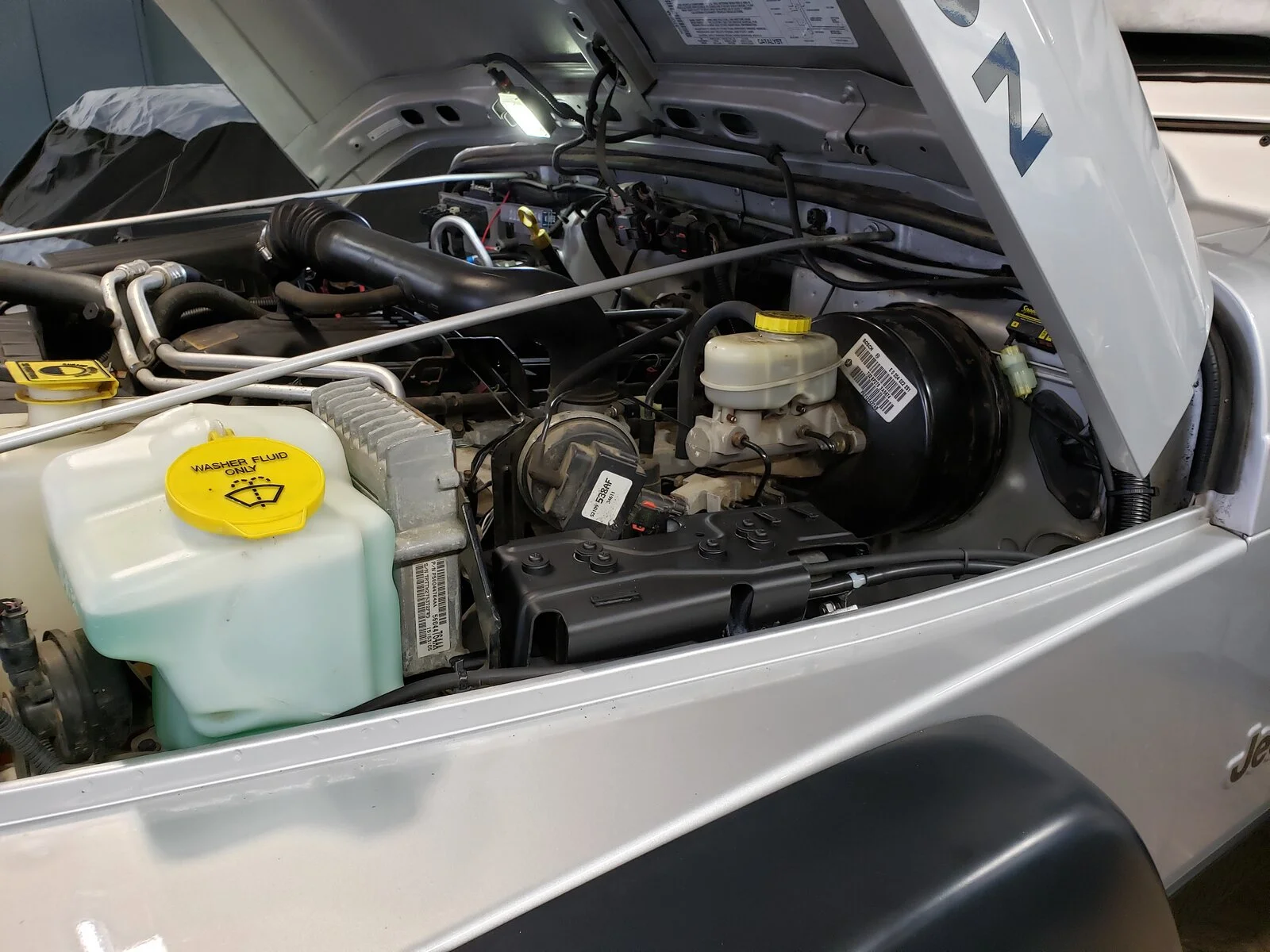

I mounted my pumps on the inner drivers side fender as well but mine is installed under the mounting frame for protection.
