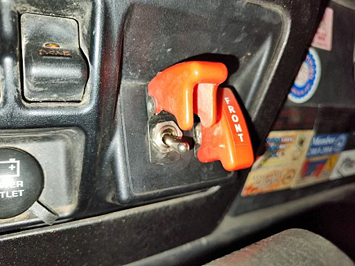

Below are the switches I used. I only specify "heavy duty" for the on-off switches so they'll be reliable, not that the circuit has much current/amperes in it. The other photo is how I installed the factory compressors onto the driver's side fender well.
