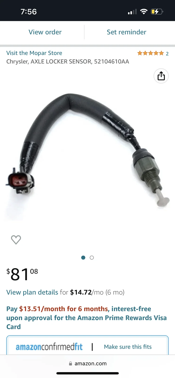

My axle dump exhaust melted my rear factory rubicon locker sensor. The wires melted and broke off too close to the plug to repair the wires. Found a new sensor on Amazon. Do I have to pull the whole carrier/locker assembly out to get the plunger to work/indicate properly? Any tricks if not?

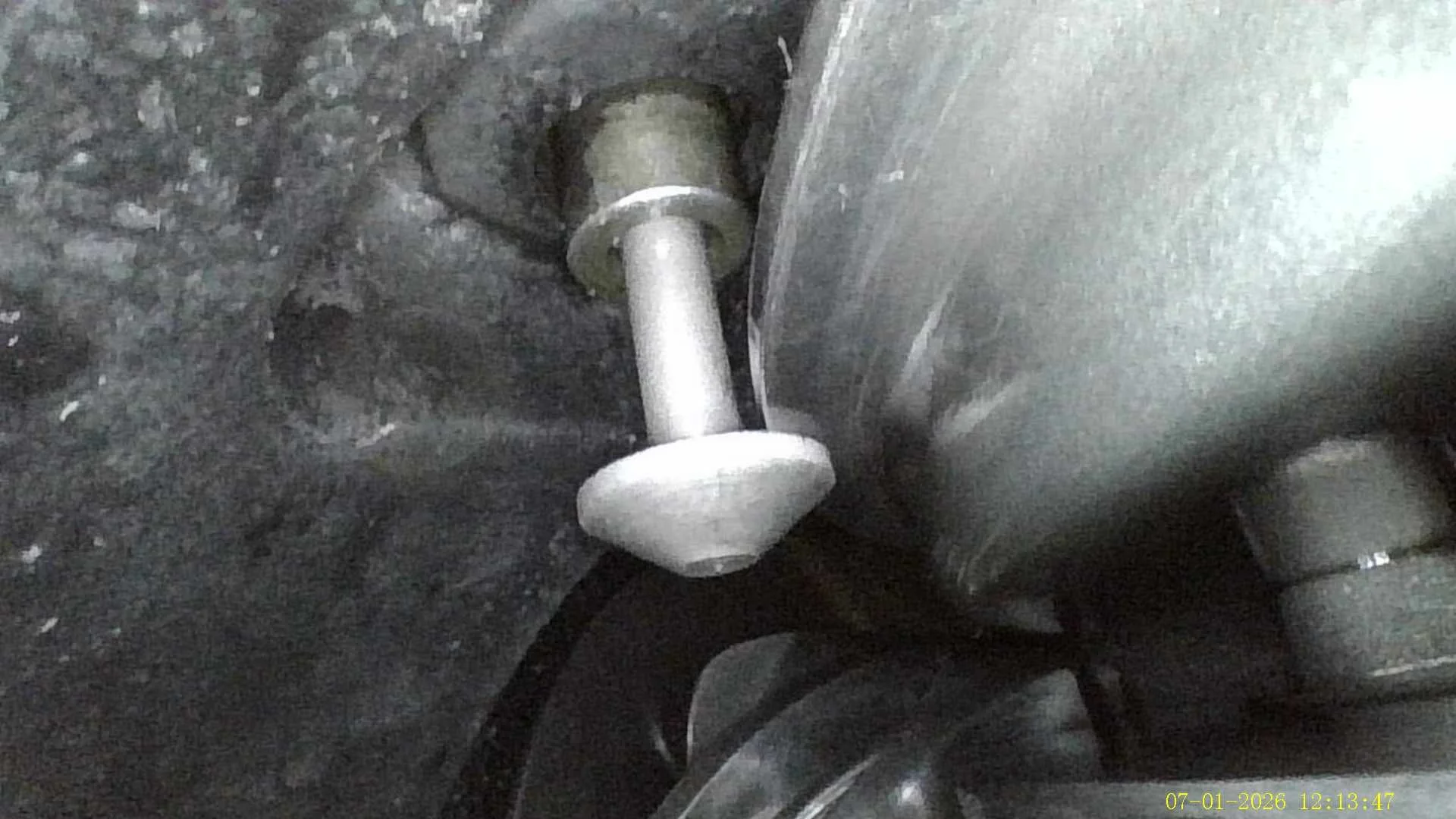

I realize this is an old thread. Thought this picture may help someone in the future visualize how the flange on the bladder needs to be in relation to the sensor.
