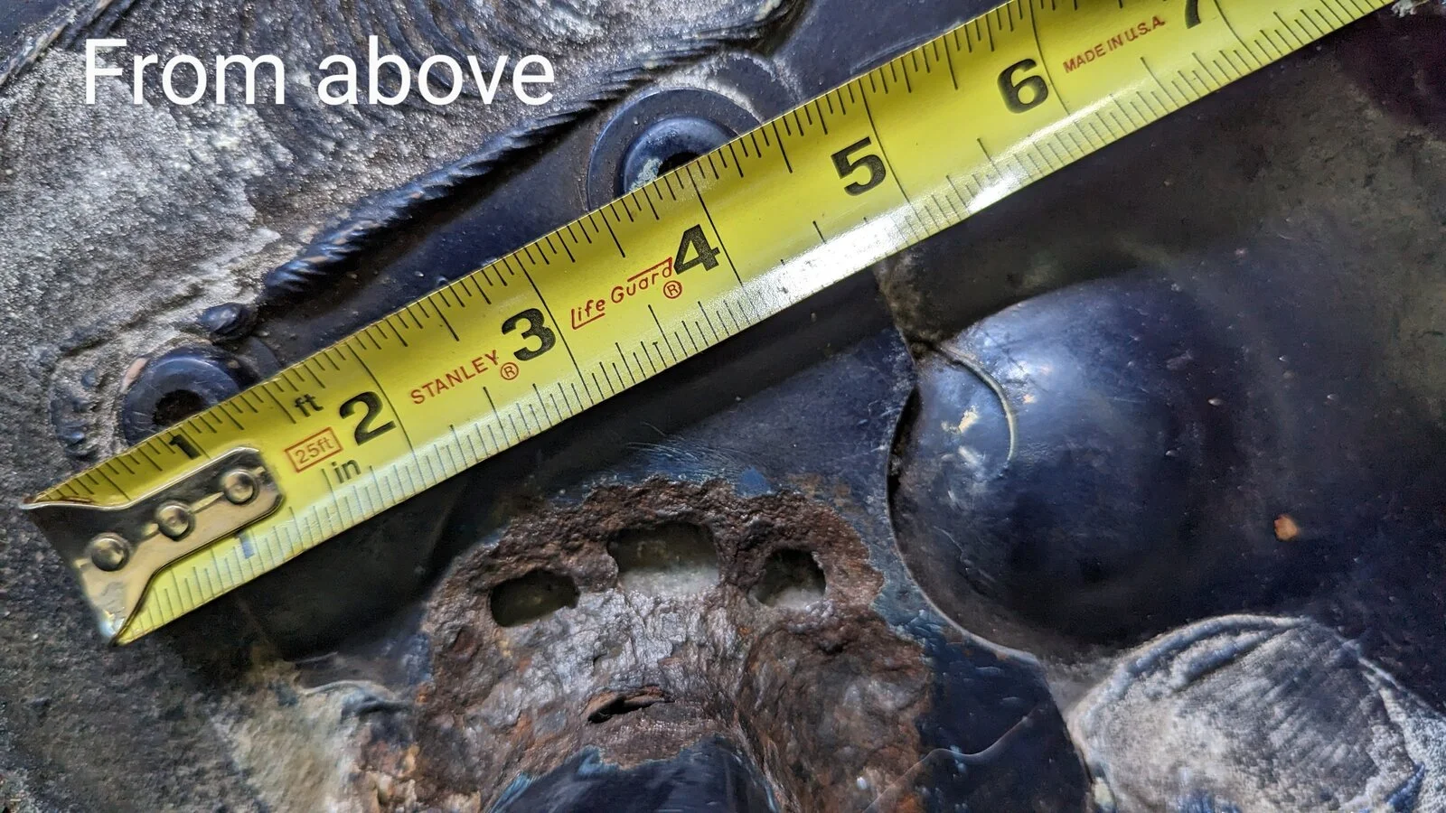

I am just starting a restore of a 2001 Sport and I need some suggestions on a rust issue. I ripped out everything on the inside to clean it up and look for rust, and I found some. The worst is on the driver's side of the tunnel. It's rusted through and soft for several inches around the hole. There's a second second smaller hole is up near the stick. There's also some around the passenger side rollbar to tub weld.
The TJ floor pieces I've seen don't have the tunnel coverage. Are there any prefab sections to replace these areas?

I've found floor panels everywhere and a shifter panel either on Genrite or Motobilt, or any of the other larger sites, but nothing that would continue up the side of the tunnel enough to deal with the area. Since then I've take a brush, wire wheel, and chem treatments to the tub. It's much thinner on the tunnel than I thought but everything else is the bare minimum of surface rust you would expect from a little scratching. The amount of crap under the carpets must have insulated it. It's going to a body shop for a better look.

Having "rust though" that far up the tunnel I'd expect to see whatever the Jeep is parked on (garage floor, driveway, etc.) in the picture of the bottom of the passenger side roll bar but looking at how the rust there is only on the heavier welded parts of the roll bar and no visible part of the floor my head wants to spin around on this one and I'm trying to keep it in place. Do you have any current pictures of the driver's floor lower than what you've posted or any pictures of anything from underneath?
Please keep us updated as to how bad this Jeep really is, or quite possibly really isn't.
This is the untreated underside of the transmission tunnel holes. Not much made it all the way through. Someone told me it looks like a clutch master cylinder leak wasn't addressed by the previous owner.
I haven't found an angle for the underside of the roll bar weld. Frame and a heat shield above it were blocking where i thought it might be. I'm taking it by Brandon's in Pompano tomorrow for an opinion/estimate.

Dremeled the roll bar rust to remove all the scaling. Not pretty. The footer is welded to the bed on two sides unlike the driver side. Driver side is welded all the way around and they even scratched a bead around the bolts. Pulled out some putty behind the footer too.
I can see paint through the holes so I'm hopeful there.
