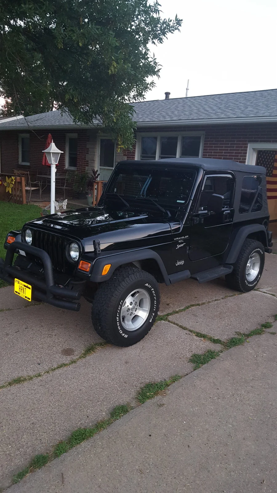

Thanks @Jerry Bransford & @UPJOHN, your advice made the soft top placement easy peasy. I won't say it took me 10 minutes but I was careful to make sure everything was aligned correctly. 45 minutes there about & it seems to fit better than when I bought it.
Took the hood bra off too, that has become a garage wall ornament for now. Once again, thanks for the input boys, it is greatly appreciated.
