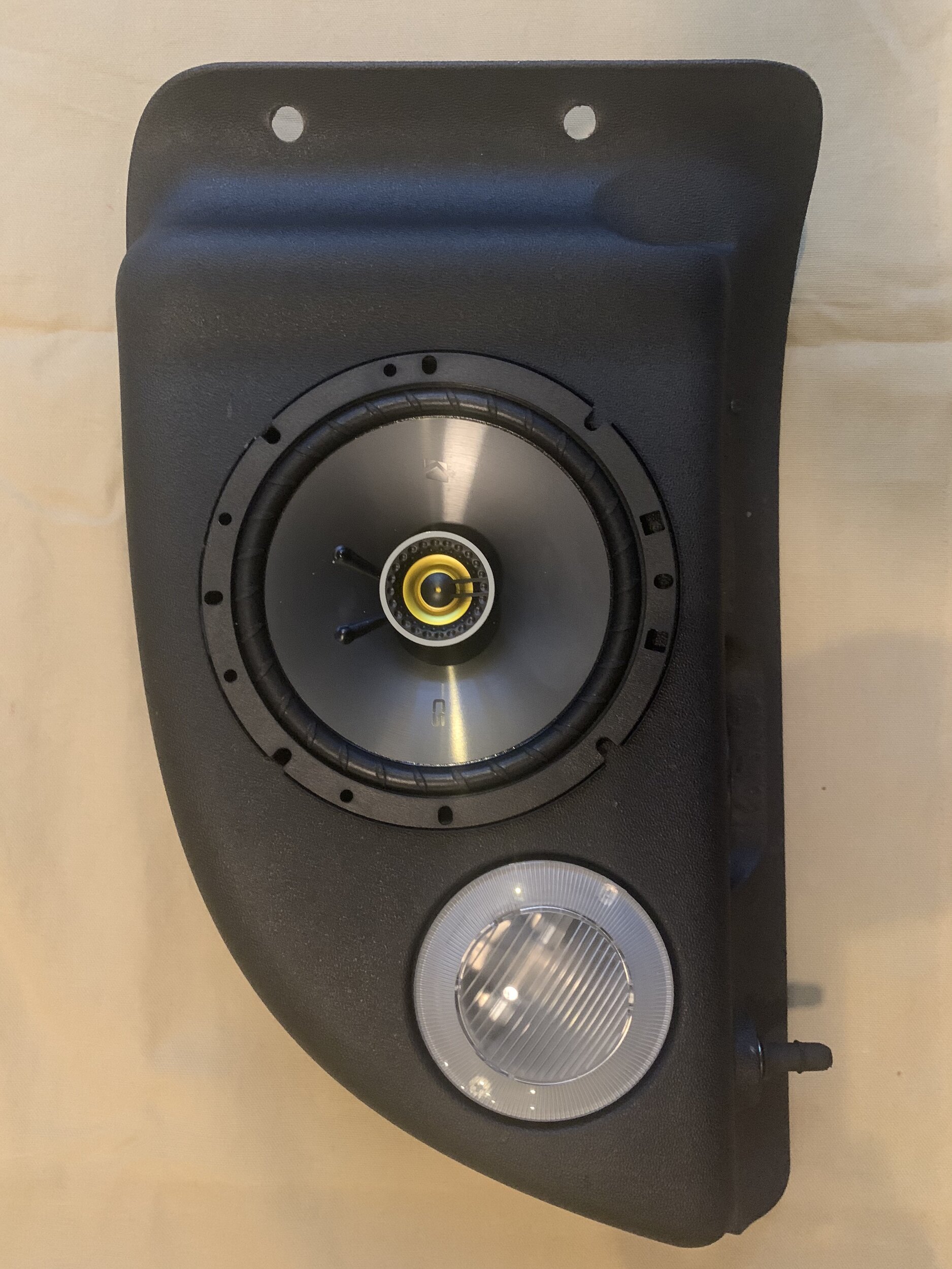

I found kicker 6 3/4 inch speakers that did not fit in the lip recess so the lip is mounted on the surface.

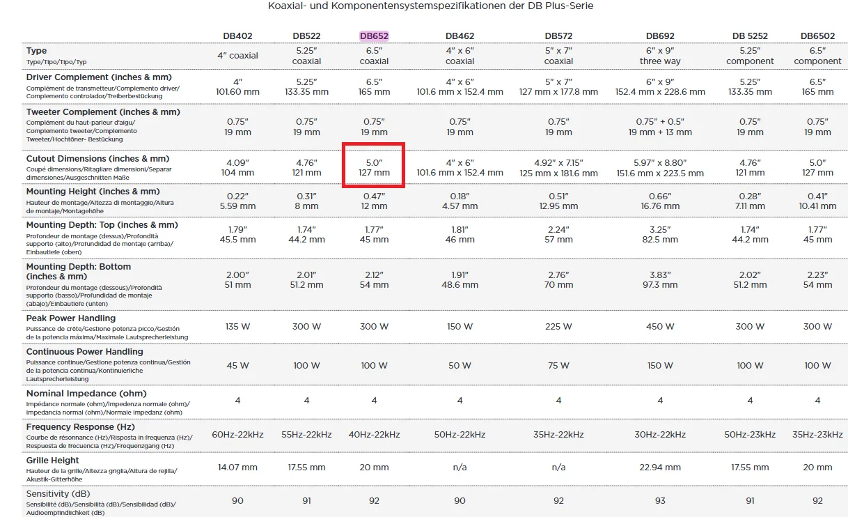

Thanks Jerry, but I'm finding a pretty wide range of cutout diameters on the 6.5" speakers. I recently tried some 6.75" speakers with a cutout diameter of 5+5/8", which didn't fit in the factory holes. I'm seeing 6.5" speakers with cutout diameters that range from 4+7/8" to 5.5". My current 5.25" speakers have a cutout of 4+11/16". I'm just not able to go measure that hole right now.

Got it. Yes, I'm seeing that Polks have small cutout diameters compared to the Rockford Fosgates I was looking at. I know those Polks are popular on the forum, so I bet that's the one that has been easy to drop in.
Well, I will probably wait till I get back to the TJ and measure the holes. If they're too small for these Rockford Fosgates, I'll just have to pick between cutting or going with Polks instead.
