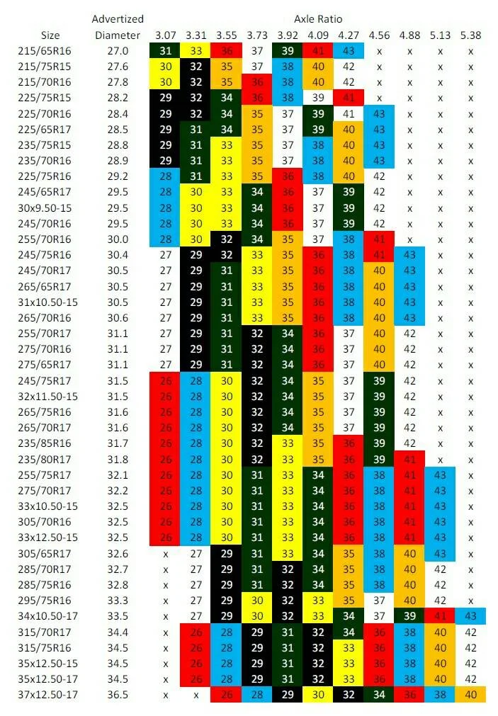

I recently swapped the (I assume original) 29 tooth speedo gear for a 26 tooth gear as per the chart posted on this site. I got the gear from eBay and verified that it has 26 teeth. With the 29 tooth gear and 32-inch tires, the Jeep was around 5 to 6 mph fast compared to actual speed. Now, with the 26 tooth gear and 32-inch tires, the Jeep is 9 to 10 mph fast. I went for an 8.5 mile trip (according to the GPS app) and the trip odometer on the Jeep was off by about 0.15 miles.

The charts show you have the correct gear. So, if the correct gear is not giving the correct speed, then you have a different size tire or gear ratio.

I realize this post is a few months old now, but I had a little more time to look things over. I re-checked that the gear ratio is 3.07 by jacking up the tires and counting driveshaft rotations. Also, I measured the diameter of the tires (when they were on the ground) and they were closer to 30.5 inches than 32 inches. I originally used a 26 tooth gear based on the assumption that the tires were 32 inches in diameter. Any ideas based on these findings? I’m thinking even if I went with a 28 tooth gear to match 30 inch tires, I’d likely be off considering that the old 29 tooth gear still made the speedo too fast and the new 26 made it worse.

When you installed the new speedometer gear did you verify the sensor numerical mark on the housing was indexed properly? There is a mark at the base and numbers 26-31 and 32-36 or something like that identifying where the sensor should be indexed to depending upon speedometer gear ratio so you get the proper speedometer readings. IF the indexing is correct the previous posts from other forum members applies.

You really need exact numbers if you want to get it right the first time. Not closer to 30, the exact speed shown. What you posted suggests a 34 tooth gear and you have 4.10s but if you are off by a few mph so is the math.
I've seen that chart, I'd bet the reality is the lower number is more like 40/32 making the gear about a 32 tooth and his ratio 3.73 it's all guesswork until you get exact numbers for the speeds.
