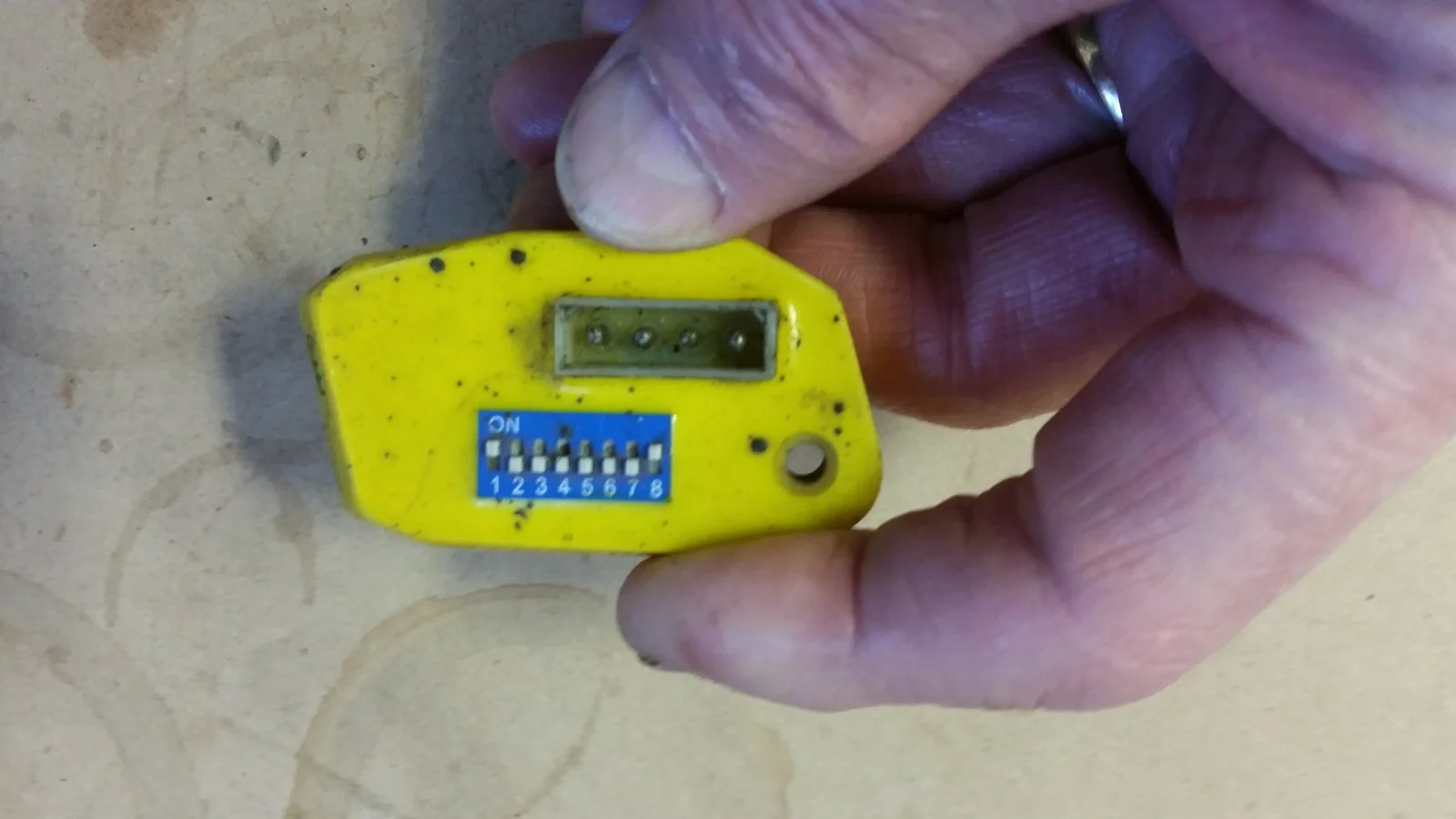

2) There are several electronic speedometer calibrators out there with one popular model being the Truspeed and the Dakota Digital.

Yellow Box
There is no speedometer gear on the 03-06 Rubicon. The speedometer on these is electronically controlled and therefore you only have two options from all the research I've done:
1) Some dealers are able to re-program the ECU so that it the speedometer will accommodate for different gearing and larger tires.
I'm going to have to do the same thing myself to my 05 Rubicon since I'm experiencing the same issue.
