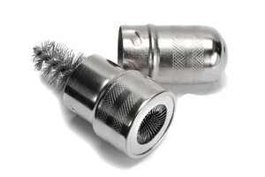

1) Use a 4-5$ wire battery brush (available at auto parts stores) to clean your battery posts and the inside of your connectors. Reinstall the connectors and then firmly tighten them around the posts. Check that they are tight enough that they can't be moved around on the battery posts even with considerable hand pressure. If you can't get them tight let me know and I'll give you a simple fix that will get them tight again.
