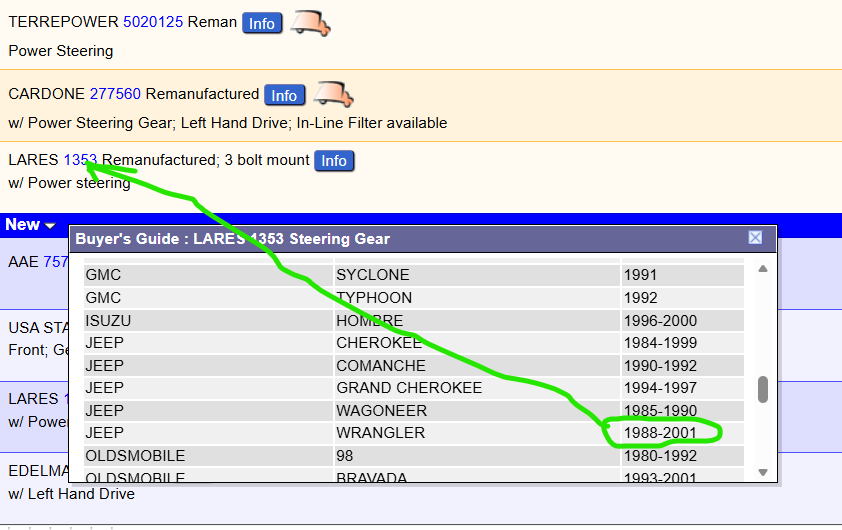

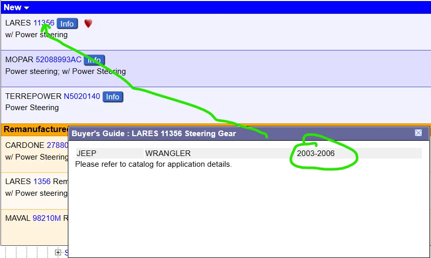

Your mechanic should learn how to use the Buyer's Guide on Rock Auto.
