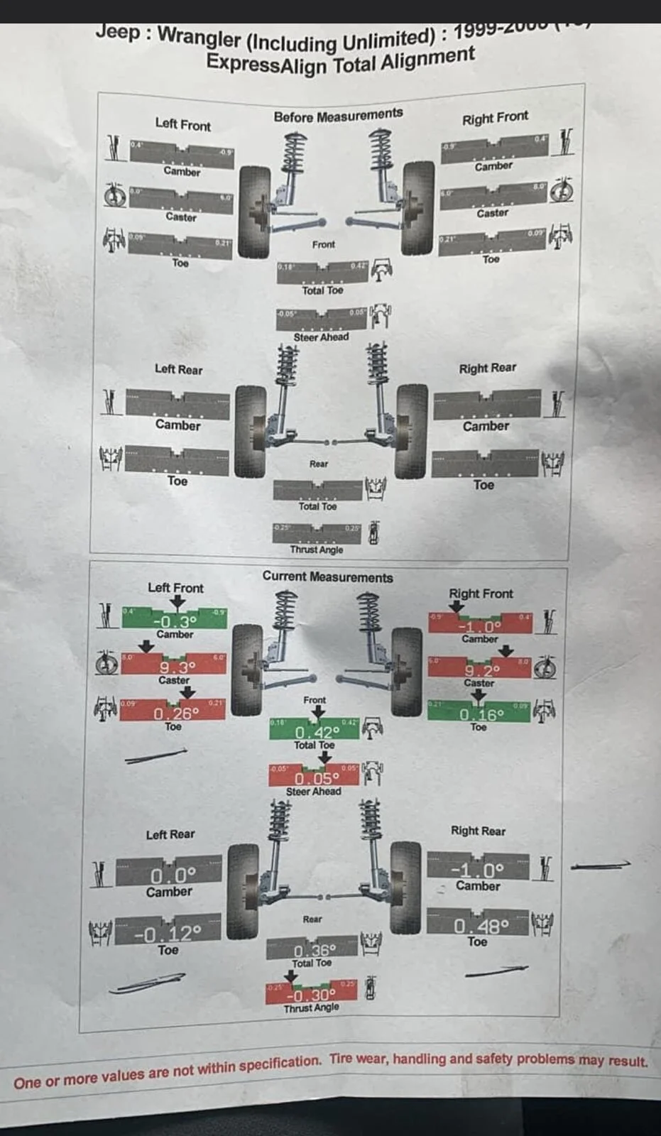

Jeep seems to pull left as well as follow the crown of the road pretty heavily. Does not drive nicely. I’ll include an alignment printout (toe has been adjusted since)
Aside from the modifications listed is there anything else non-stock on your suspension or steering?
I'm chasing the same issue and first things I'd double check knowing you have a good steering system and new track bar, do you still have the stock pitman arm? Double check your drag link and track bar have the same angle (pull a string from centerline of bolts on both ends). Double check that your track bar is adjusted and your axle is centered under the vehicle (at ride height).
