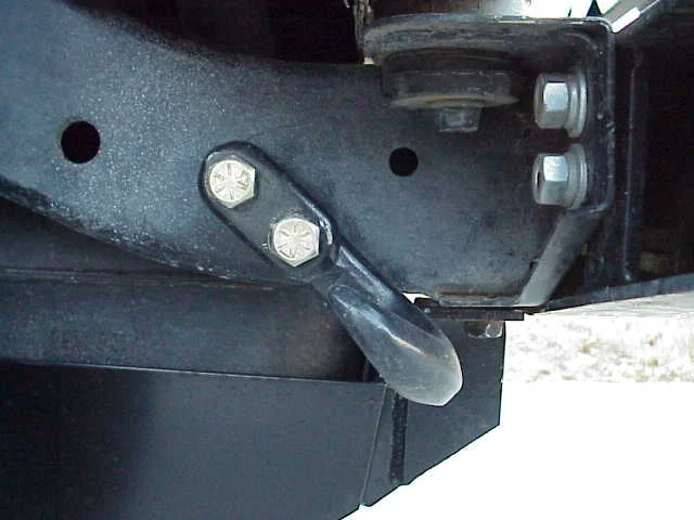

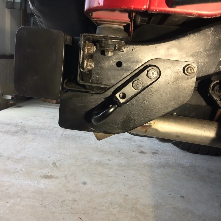

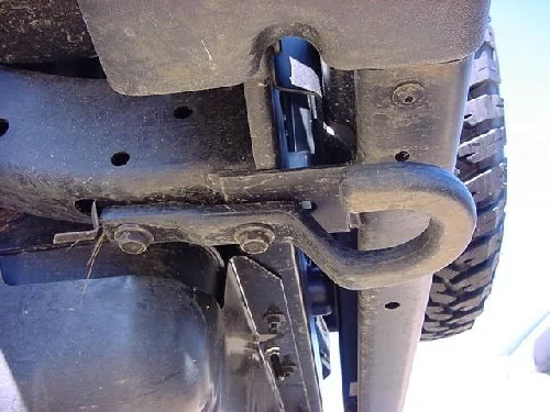

Anything wrong with the OEM rear row hooks?
Technically that's a hook used during transport they attach a chain to. Many use it for recovery but this is how I'd do it (again) if my rear bumper had no recovery points.
One hole is already there, you just drill one more on the outside of the frame. The nuts and washers are placed inside the frame via a factory slot under that area. The frame should not be through-bolted for this recovery hook. Bolts need to be no less than Grade 5 but Grade 8 is the way to go where recovery hardware is concerned.

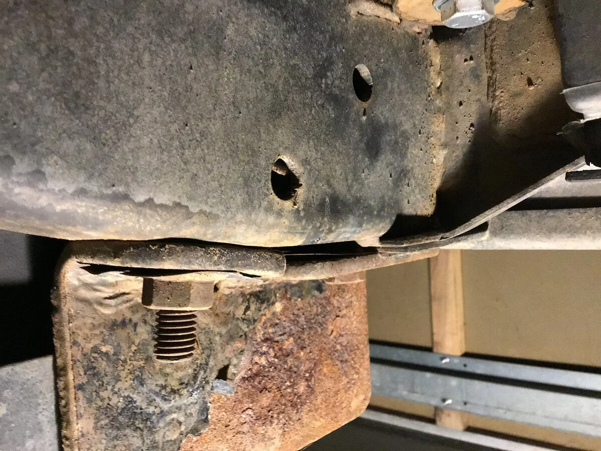

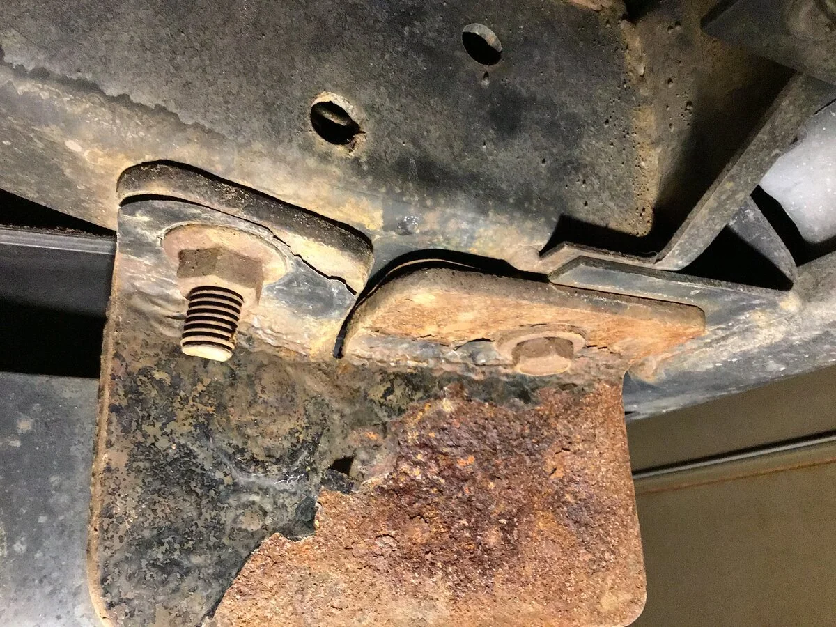

I have encountered some befuddlement as to what to do after ordering some hooks. My rear tow attachment looks different. Like it is covering up different holes on the frame. Also the rear tow attachment was bolted through the frame. Aftermarket?
Here is the area of the tow mount on the side.
And now here is me holding up the hook I have.
I numbered the holes. What to do?
Use existing rear upper tow mount bolt hole to go through Hole number 1 on my hook. Then drill through tow mount/frame and bolt through hole number 2. Ignore hole 3.?
My experience in recovery is very limited, but I am confident in my ability to drill and bolt once I have the plan right.

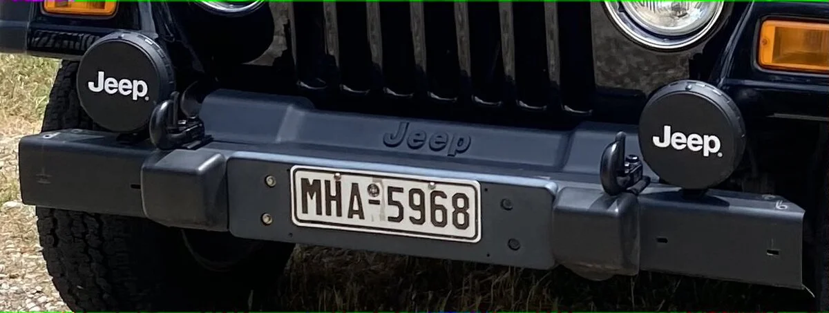

Sorry to Hijack this thread but what did you use (washers, a mounting plate etc?) to mount the rugged ridge tow hooks on your OEM front bumper that allowed you to retain the front rubber bumpers?

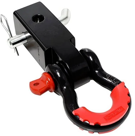

Is this tow hook rated for a full recovery pull? Where can I find it? (I cannot really find it anywhere)
2)
I am really hesitant about this option, and I would like to be my last choice, since I don't really want to drill any holes in the frame.
SO, are there any other options I am missing for the rear? Should I install two rear tow hooks as well, so I will distribute the force?
You could add a plate to raise them up, or not.
Like you said, they're rubber; they should swish down just fine.
