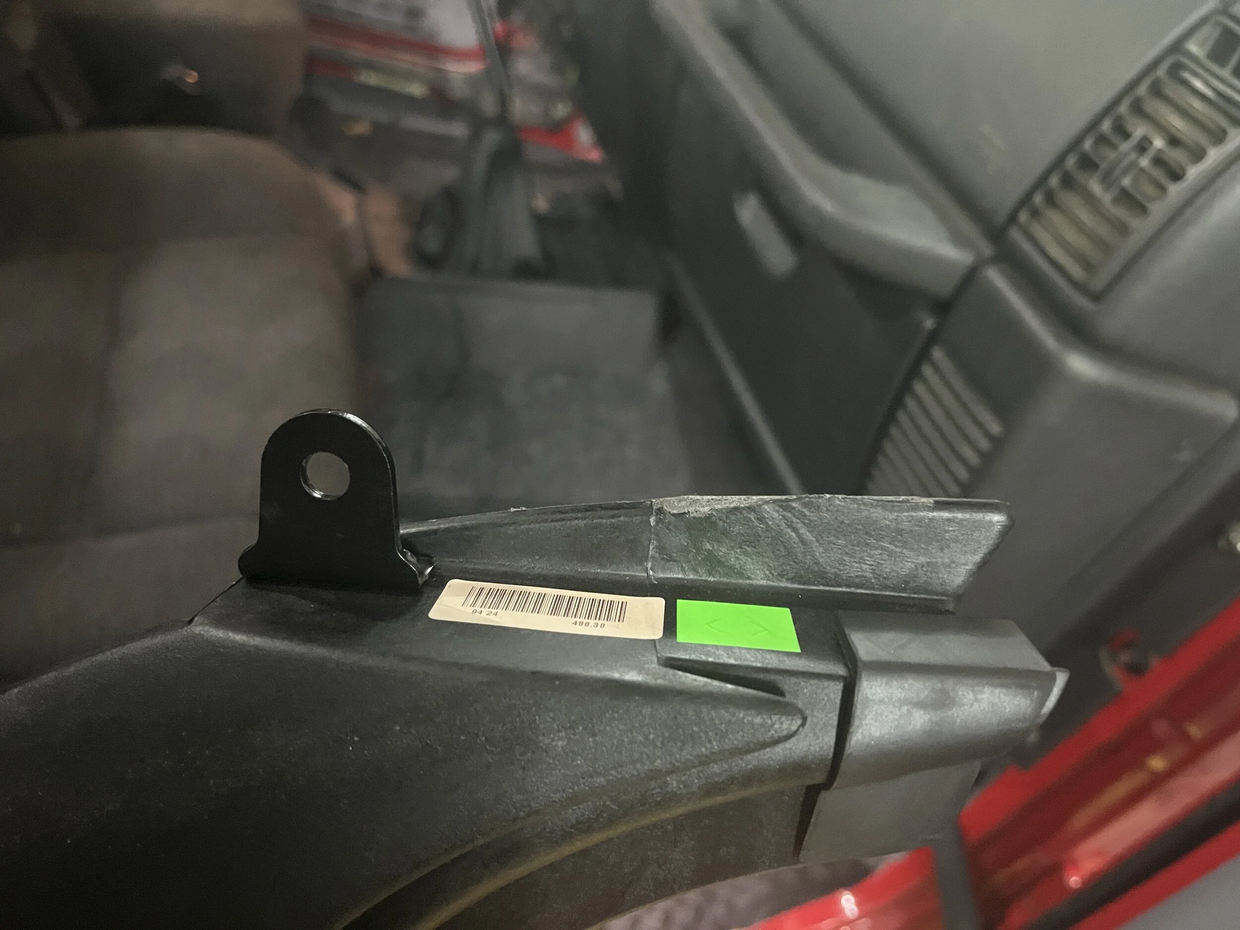

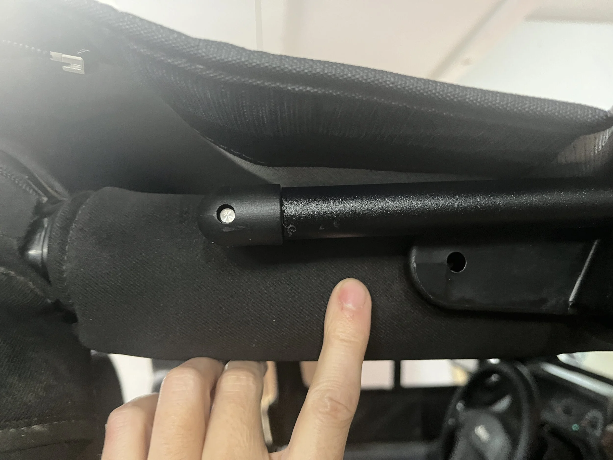

Alright, well, that didn't take long. The little circlips are painful to remove, but once off, yeah. the surrounds come right apart.
The bad news is, that doesn't help me... the attachment points for the NX are on the vertical piece. The piece I want to see gone:

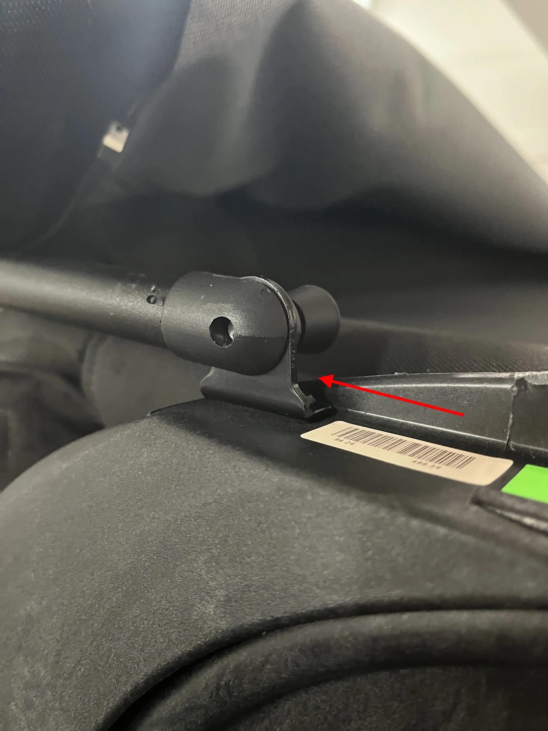

Here's the top with the upper piece mounted. The Sunrider bar doesn't have anything to attach to:
No way is it designed to attach to the holes on the upper piece. Now... I could just design a strap that attaches to that hole at the back end with a pin. That would be pretty easy.

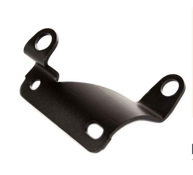

Just buy this and just cut it up and bend as needed.
$16 on Quadatrac
Got a link, or a part number?
Looks like it could work. Metal is nice. But I can save $15.70 by printing a couple of these:
EDIT: Make that $35. And I don't know what would prevent it from fitting my '05, but this says it's for a '97-'02. I don't see one for a late TJ.
EDIT 2: Answer on the Quadratec site says:
Technically the sportbar diameter changed in 2003 which would affect the arc of the bracket, and proper fitment with interior trim

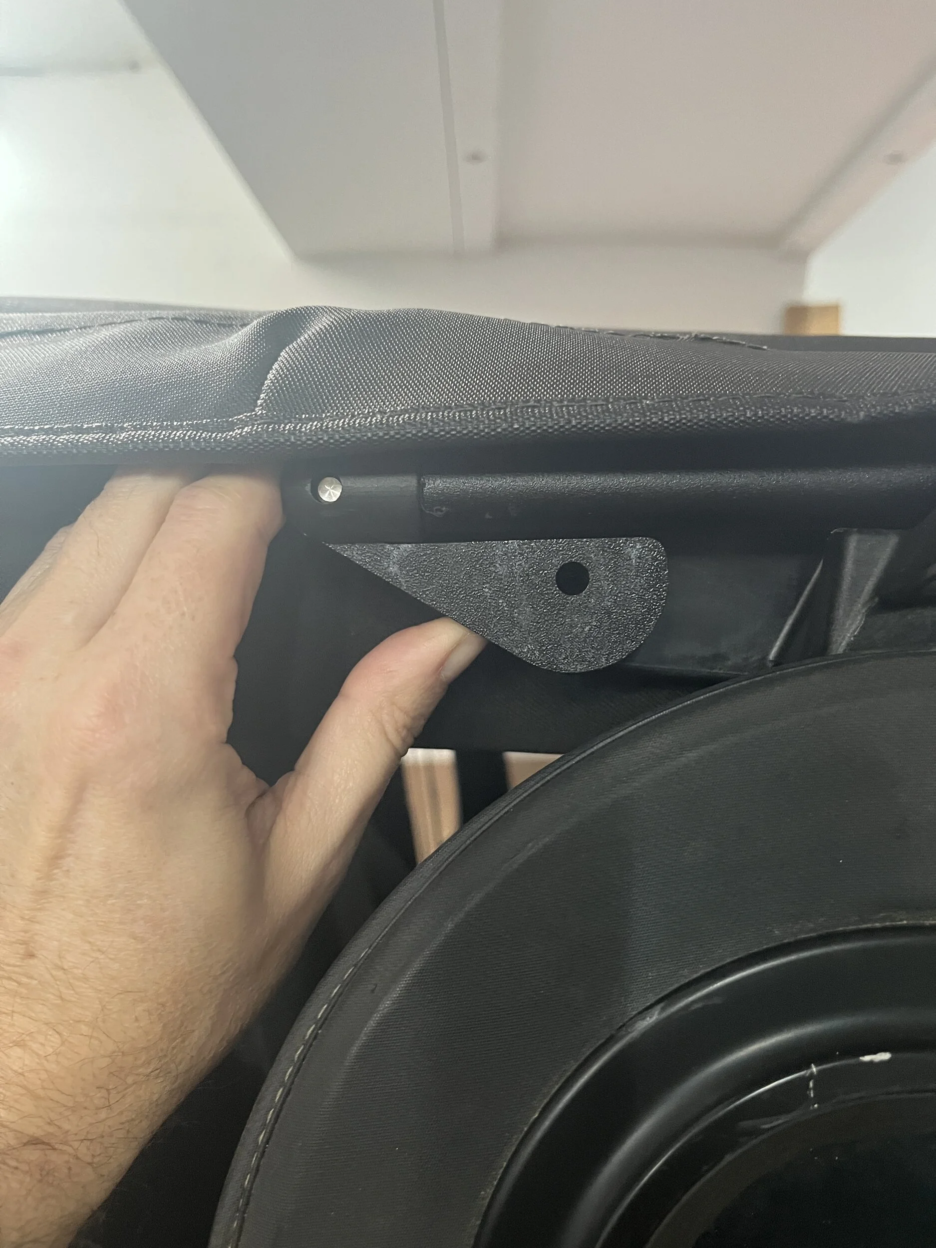

Yeap, 3D printed.

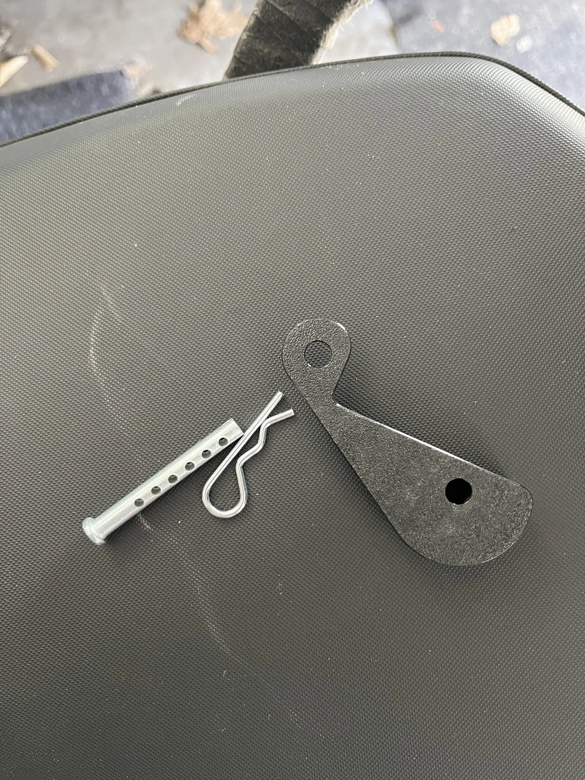

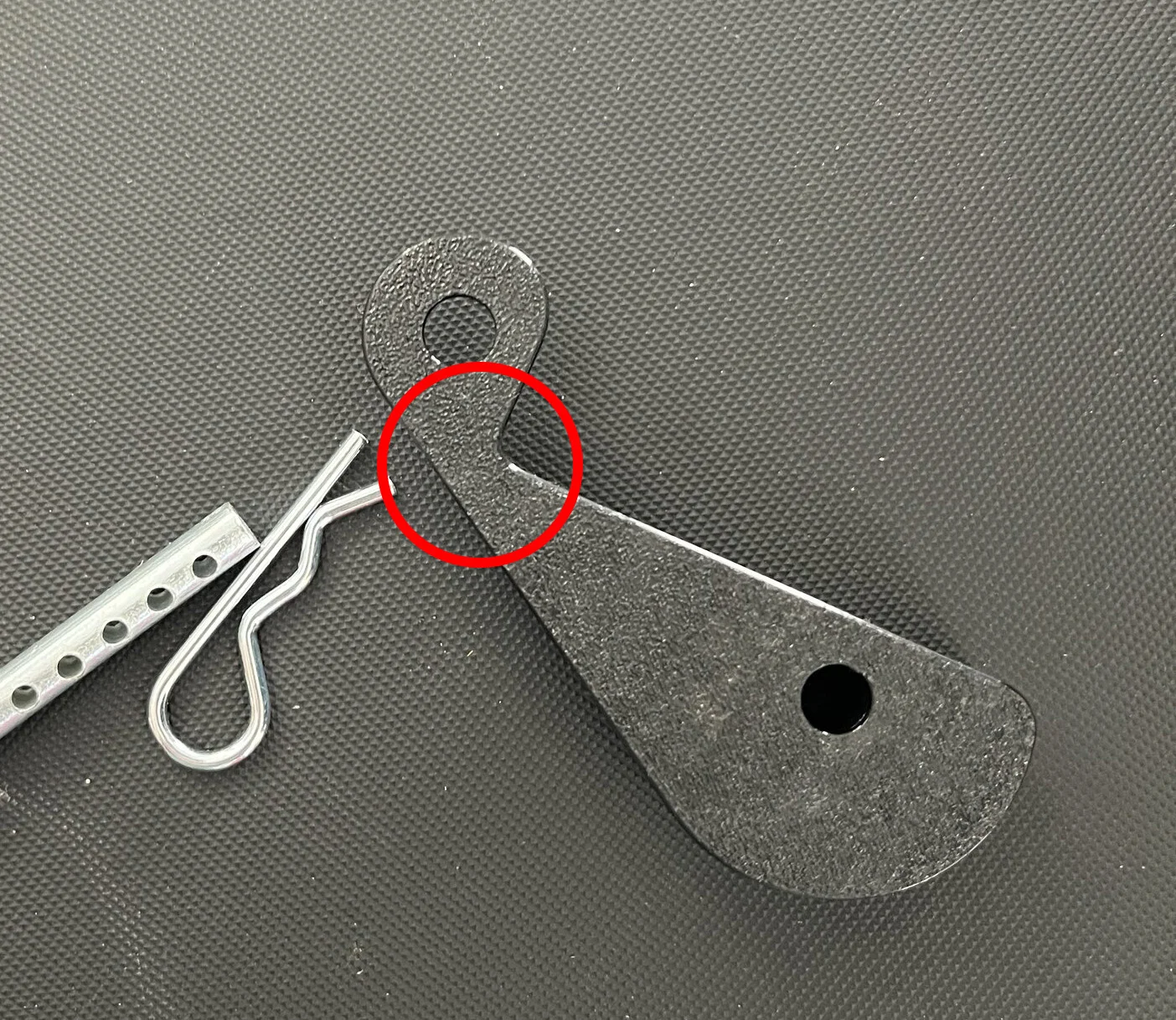

I got some clevis pins today. I need to cut them down, but they're in as-is right now. I did break one of the brackets while trying to get the pin in, so that doesn't bode well for the strength of the PETG. I might have to cut some out of aluminum, or maybe get a service to print some in glass-filled nylon or something.
I had heard of Send Cut Send a little while ago, but I never used them.
This morning I decided to give it a try. I had to learn a bit about modeling sheet metal in Fusion, but I got it uploaded and ordered. Two powder-coated SS brackets for $35 shipped. Most of that cost is wrapped up in the two bends in each bracket. I can see using that site for a bunch of stuff.
Whether 3D plastic printed or cut and pressed metal, I think your design might benefit from a little extra meat here. It would need to be on the "bottom" edge so as not to interfere with the Sunrider's arm, but this feels like a weak point.
It absolutely is. I did what I could with the print by adding a filet on the backside... I don't know if you can tell by looking at the sheet metal model above your post, but I made that part thicker before sending it to fabrication. It's limited by the gap on the bow, like you mentioned. I beefed it up as best I could.
The good news is... almost all of the forces on that piece are going to be along its length (tension/compression) and not on its face (shear).

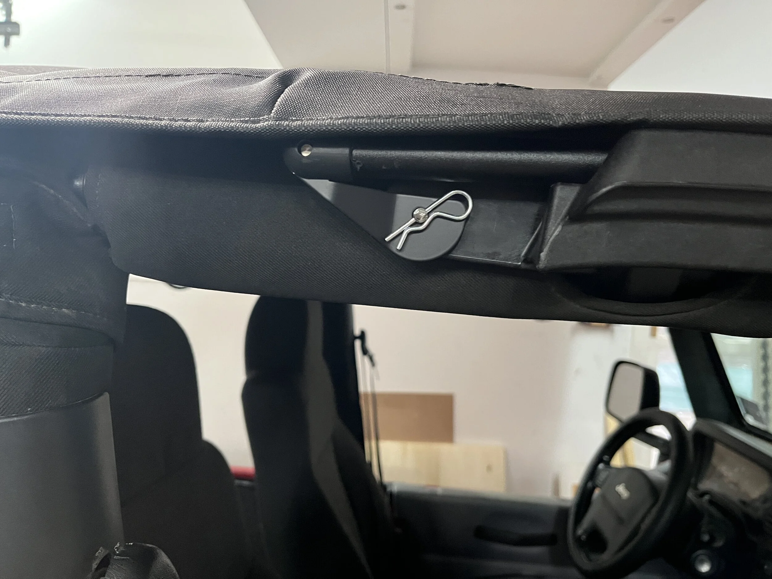

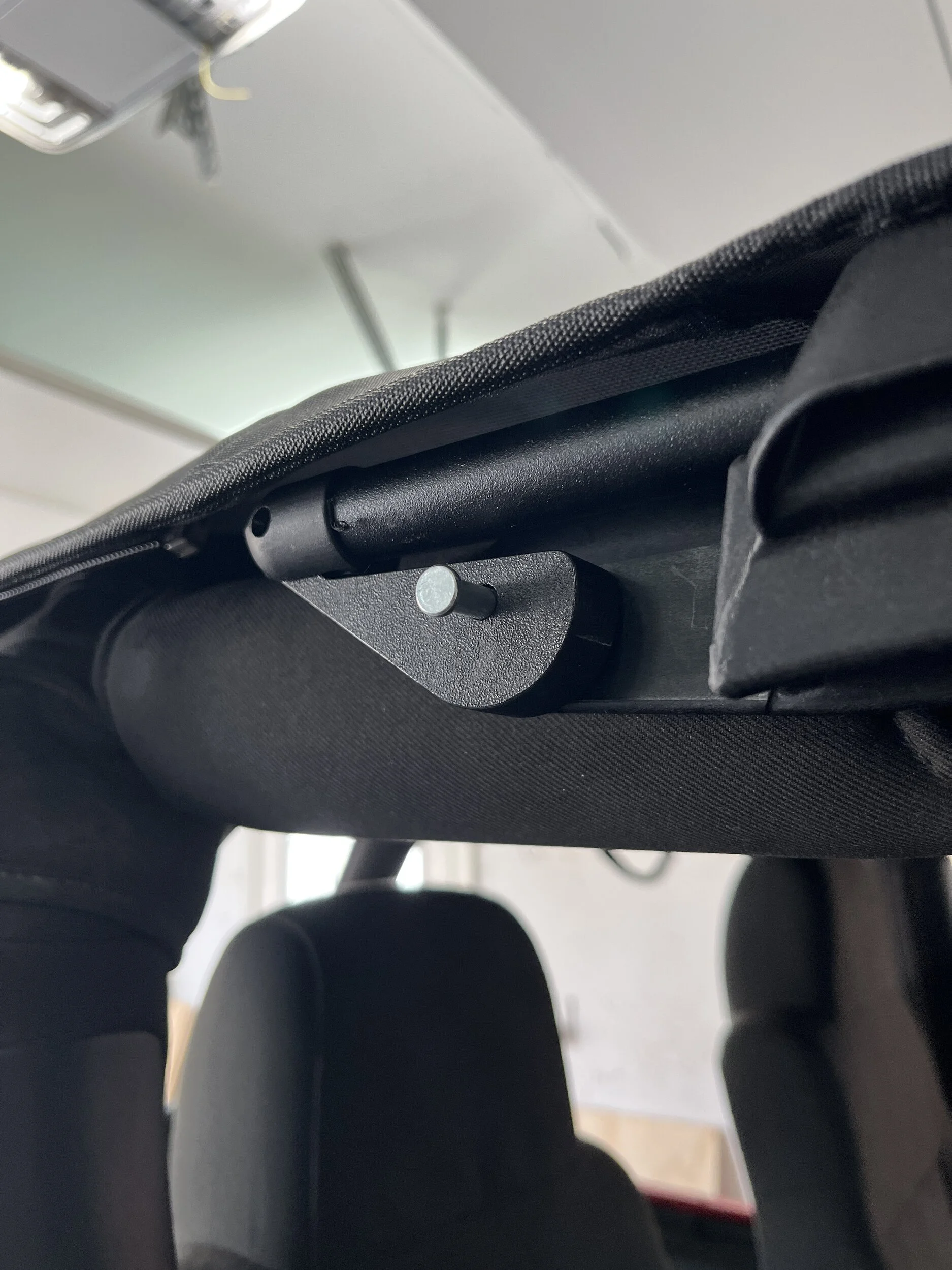

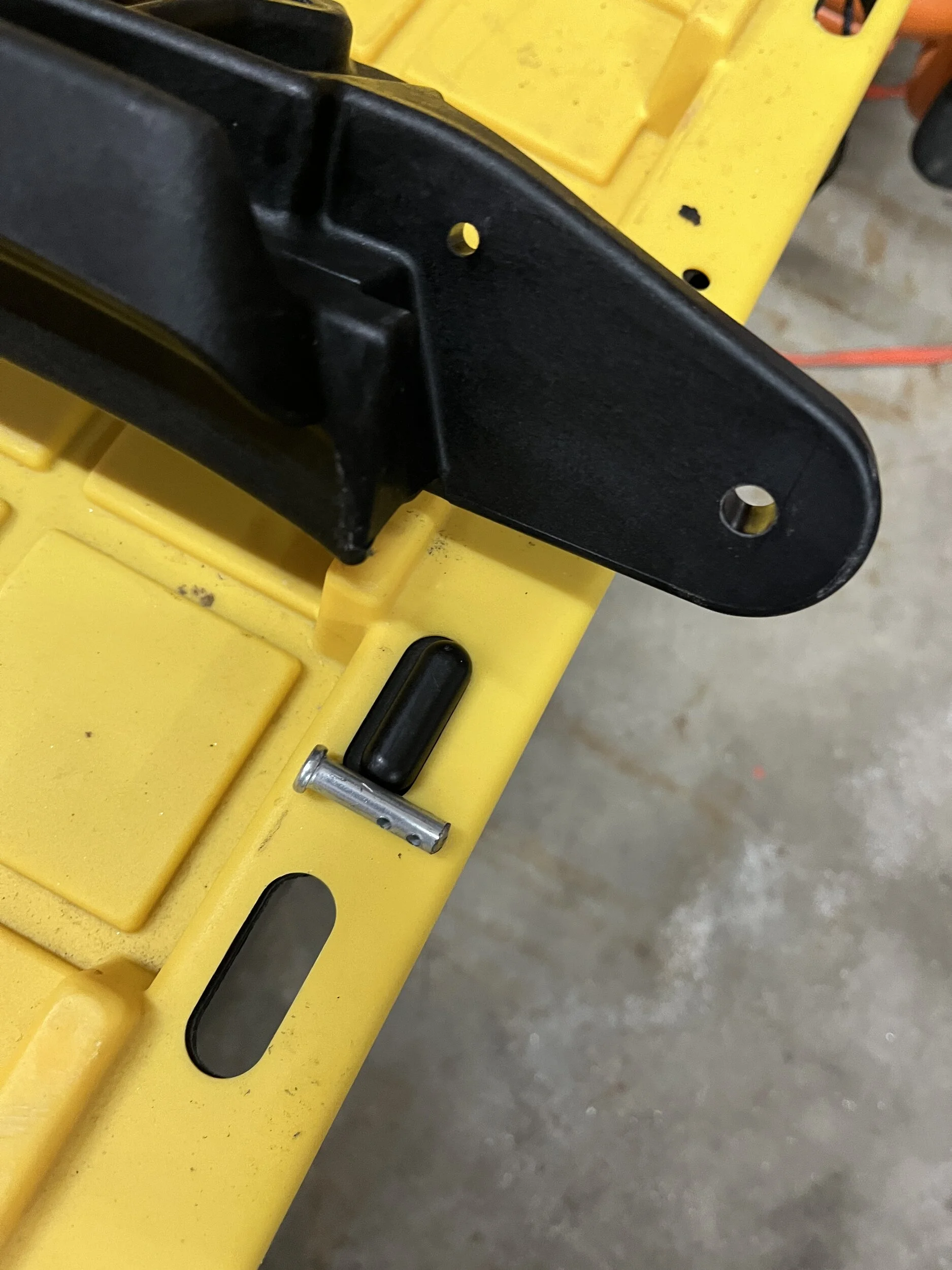

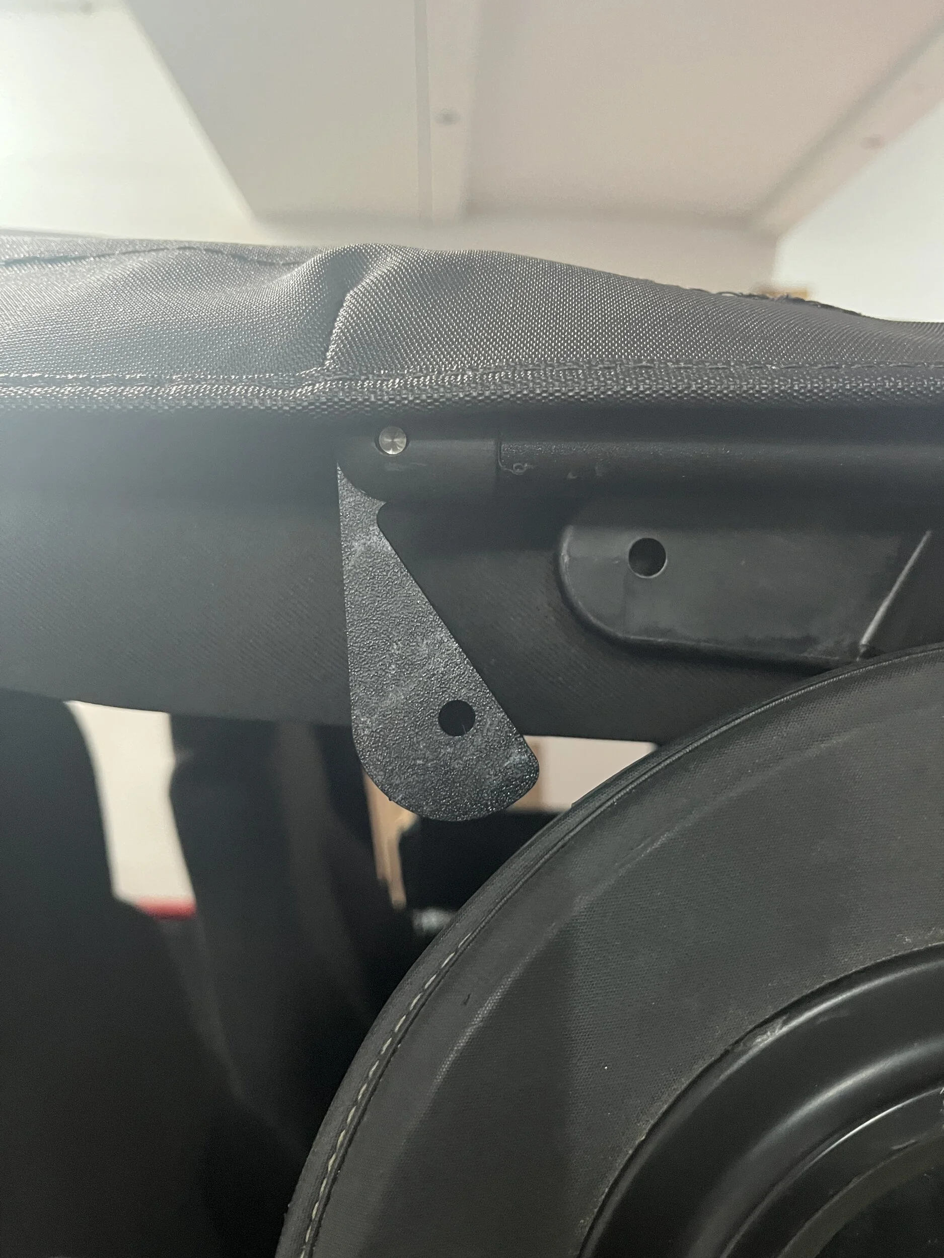

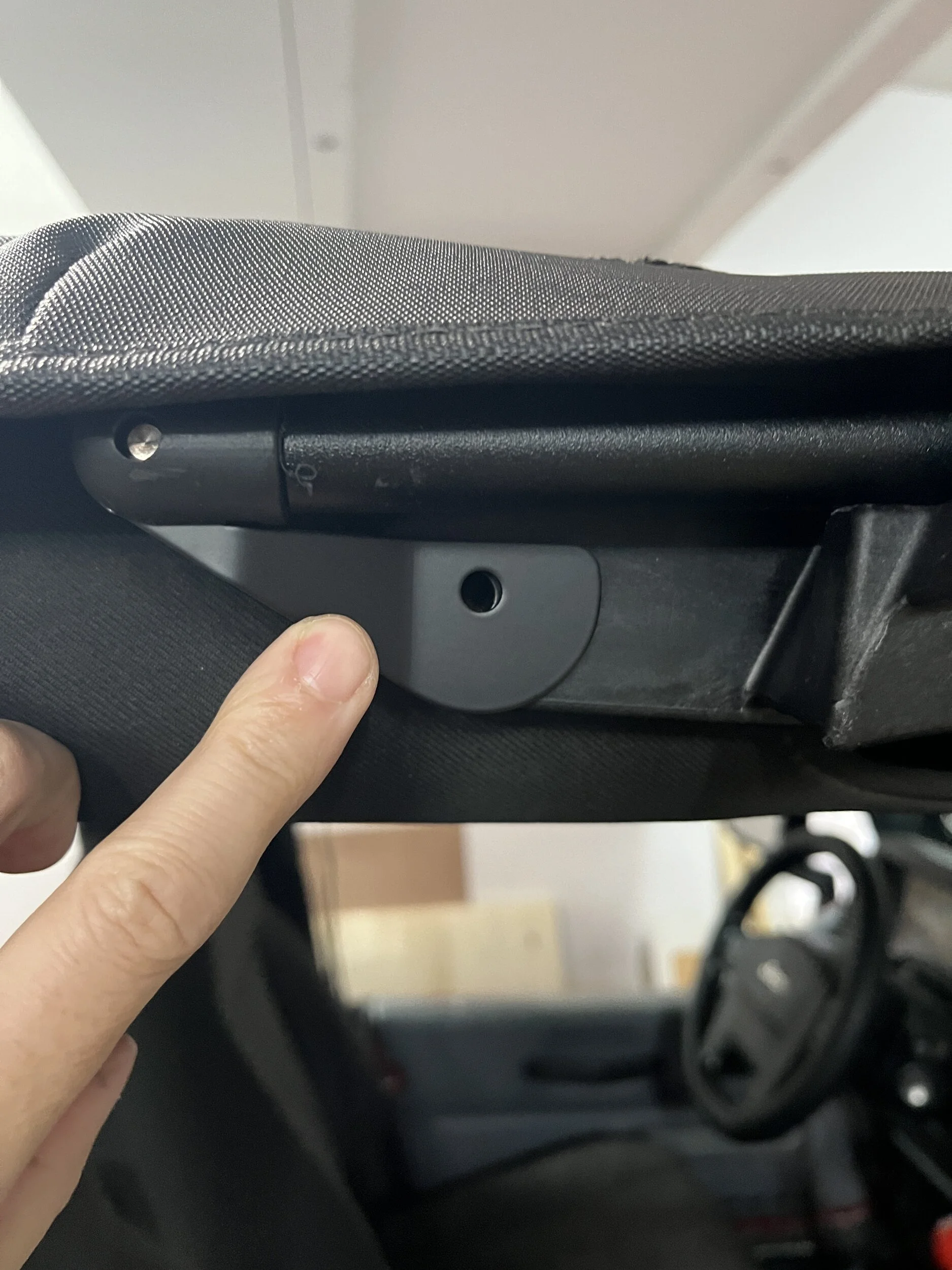

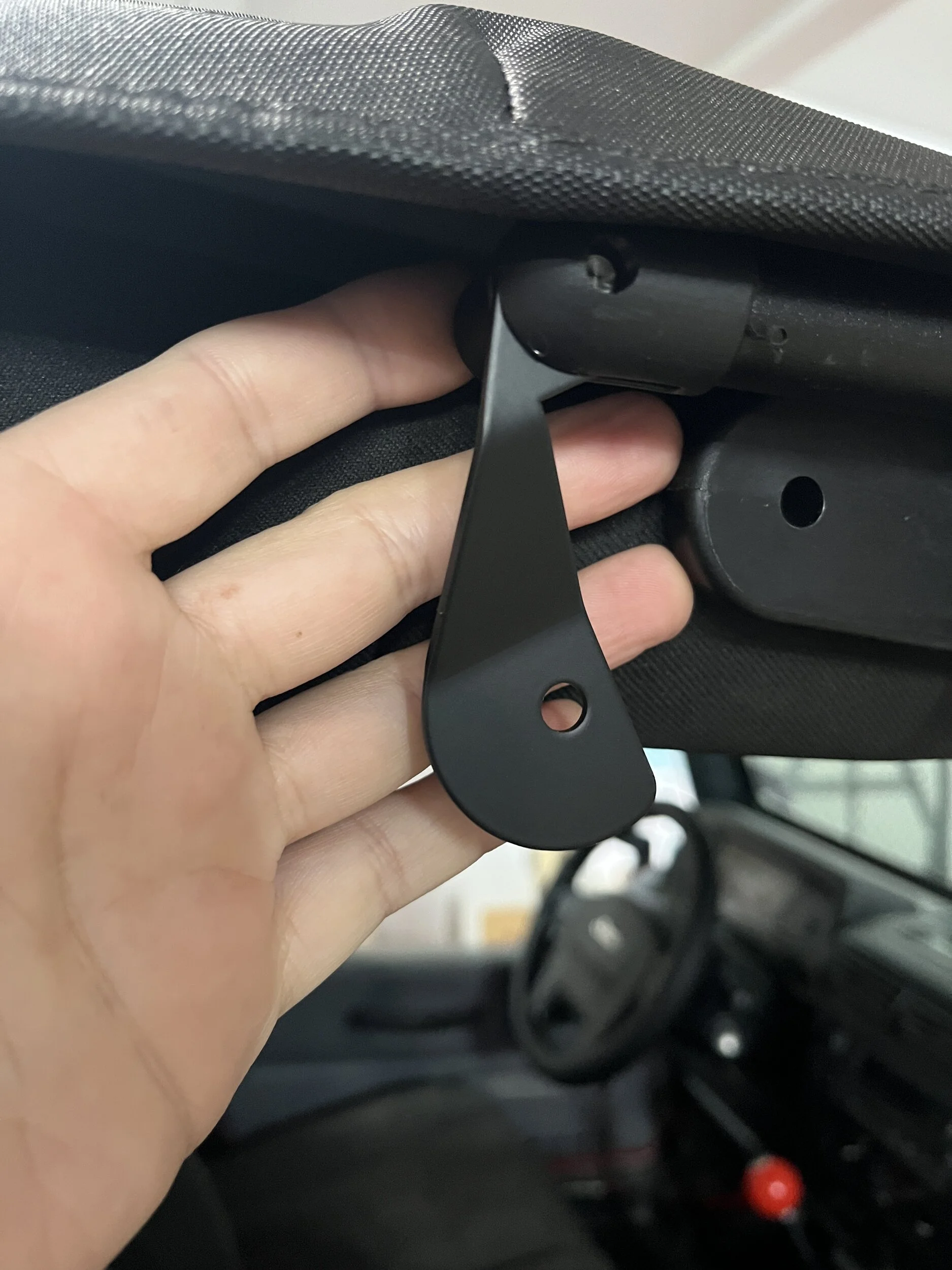

Received the parts from sendcutsend yesterday... they fit like a glove.

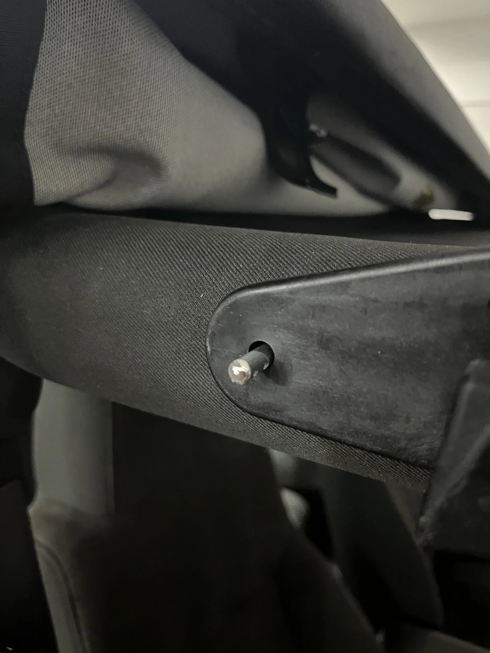

I cut the clevis pins down to around 1-1/4". I took off the upper door surrounds and inserted the pins from inside out. The roll bar retains them... they won't come out without the surrounds coming off first.
I'll probably try to smooth out the pins a bit and paint the hardware black.
Sendcutsend is awesome. I can definitely see using them some more.
I think my next step is to modify the door surround b-pillar piece so it attaches with the clevis pin for tool-less installation. Ideally, I could install them without removing the upper surround, but I don't see how that could work.
