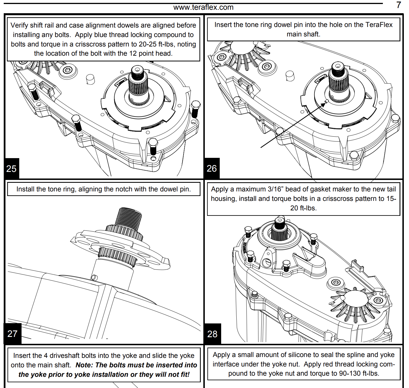

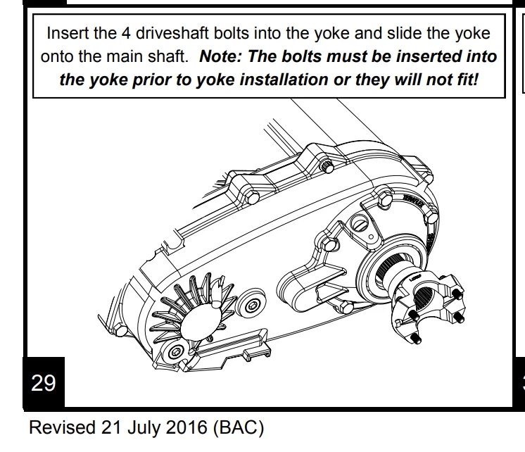

Here's the setup, from the install PDF
The guys that installed it obviously left out these bolts, and the driveshaft place had to slide the yoke out slightly to install their own (not 12 spline, regular bolts which make it a PITA to undo). Maybe they didn't torque it enough re-installing. But as I said, that was years ago.

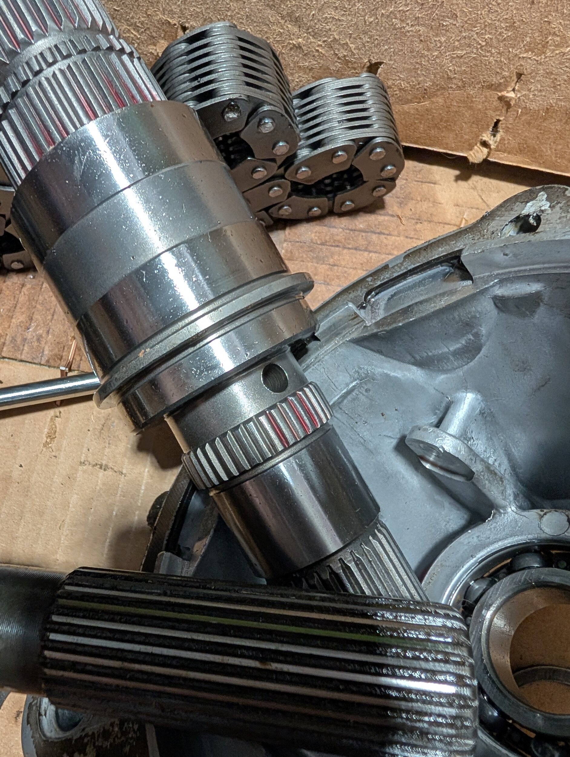

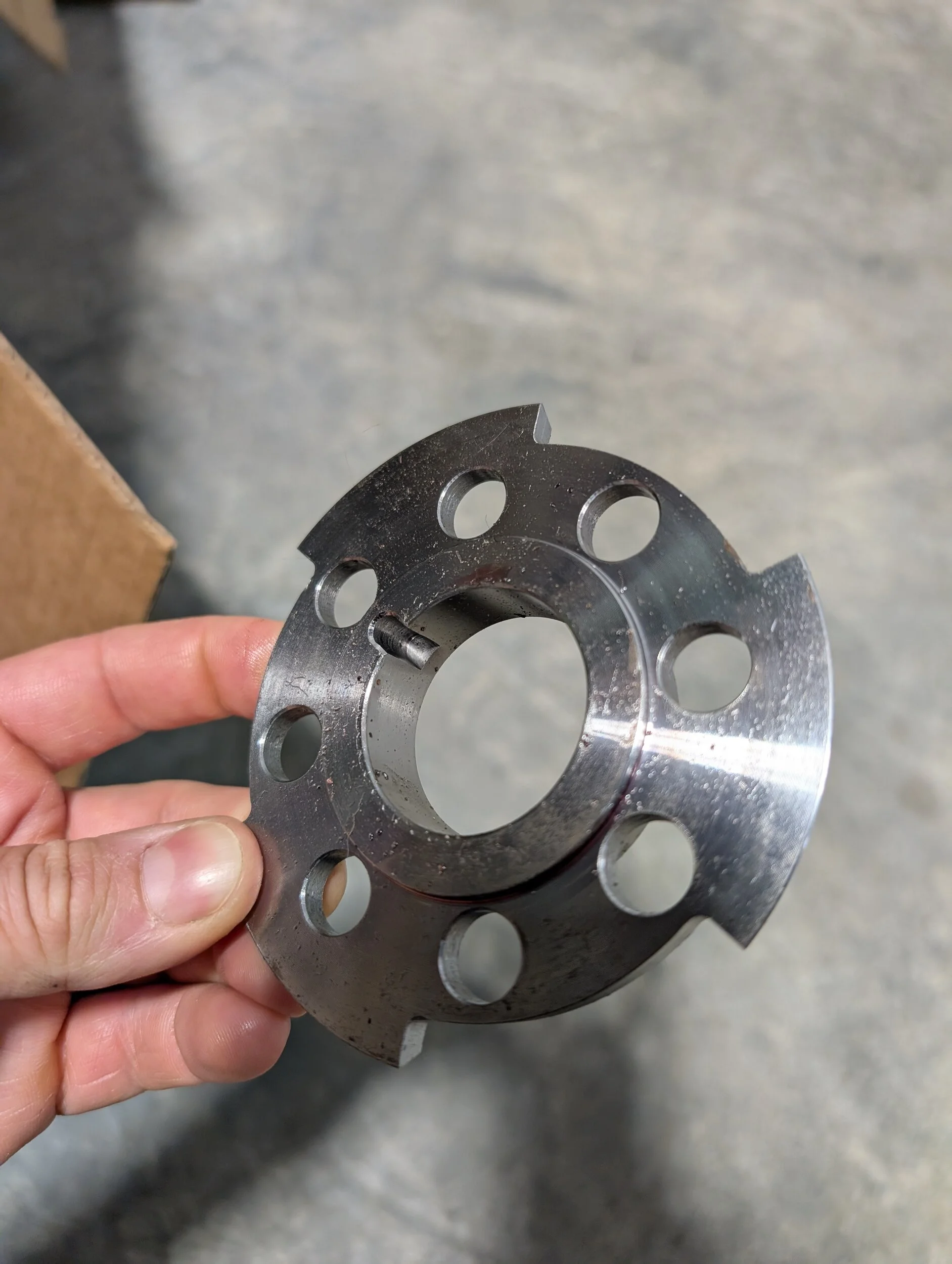

The newer style tone ring is a bit different. You can see the notch for the dowel pin as well as the hole in the shaft for the pin. I still have the one I replaced sitting in a box in the garage so I was able to grab these.
Looks like something they added later. Maybe they found this problem. Hopefully it will be that simple for you. Though you may want to zip the nut off, clean the threads and apply new thread lock rather than just tighten it down.
