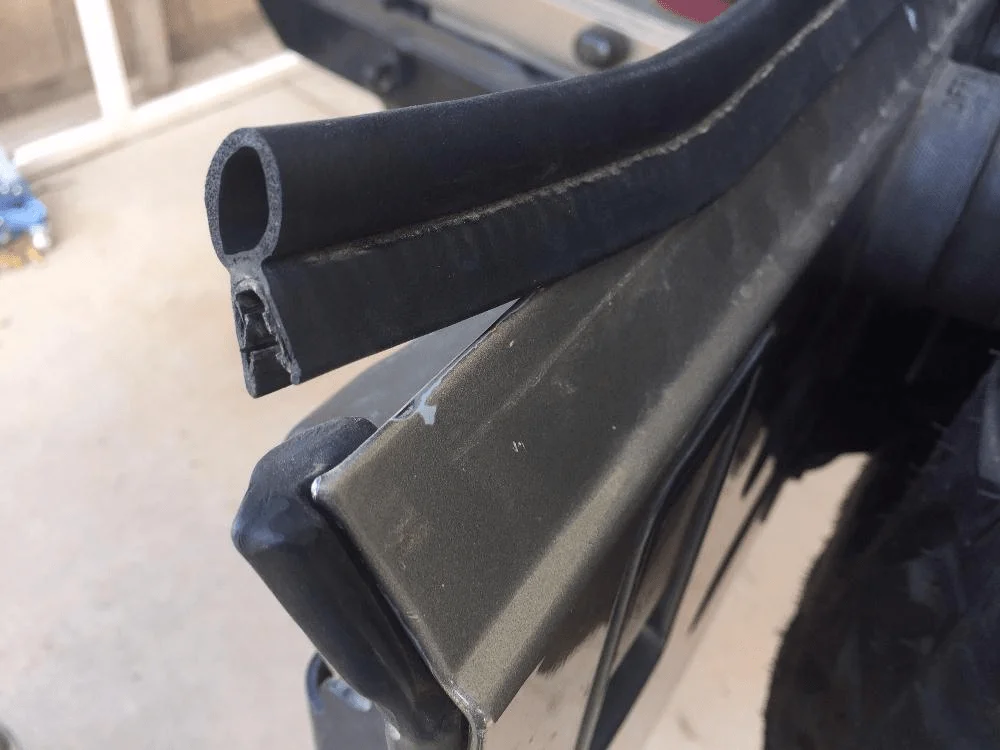

I used this strip of vertical bulb trim seal to keep the back glass from popping over the tailgate:
https://www.amazon.com/dp/B01HVDO86K/?tag=wranglerorg-20
Installed it almost a year ago and it has worked great. The flange fits perfectly over the top edge of the tailgate and holds tight.
Not my image, but this is what it looks like after install:

there is a little adjustment in the hinges that will move the glass up and down, but nothing comes close to working as good as the seal in the post below your original post... It's cheap and only takes a few minutes to install.
It's been my guess that the rest of the seal around the glass collapses a little bit over time and allows it to come in a little further than it should.
I purchased the seal and I never had another problem.
Reactions: nk24
+1 to what @nk24 said, in fact I think he was the one who recommended it to me for the same issue. Cheaply solved my problem too. I don't have the tailgate bar for the soft top either and it's done a fine job keeping water out in place of that too, FWIW.

I'm going to try the seal @nk24 recommended.
