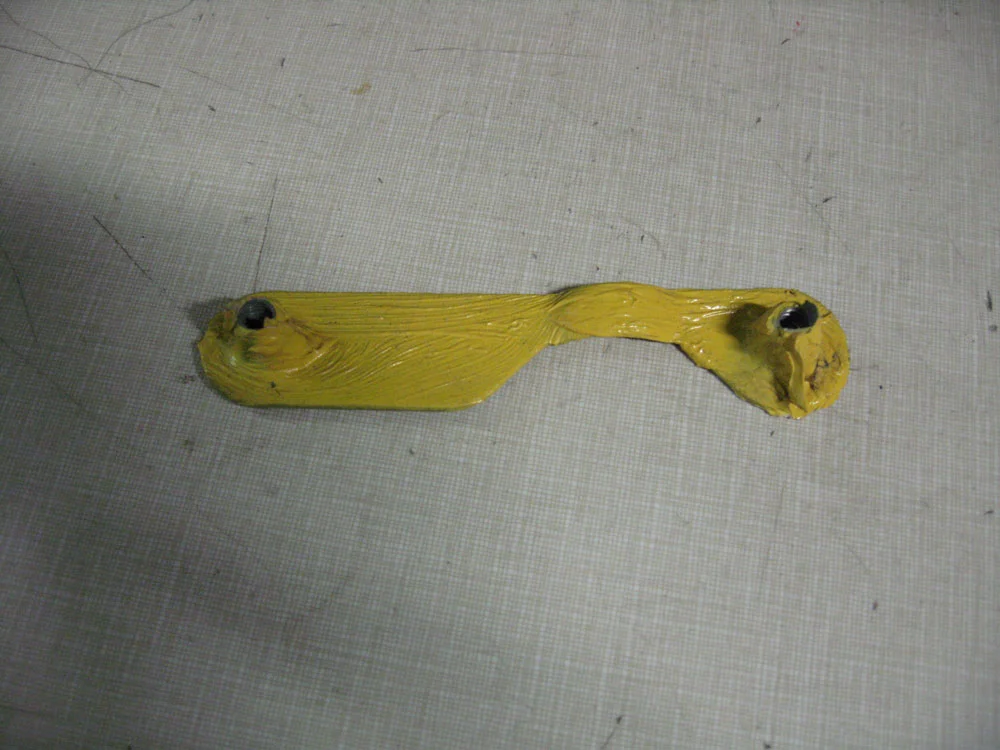

I ran into this problem with the bottom two. Here is a pic of basically what is inside the tailgate. (This isn't the exact part but very similar) There is one for the bottom two bolts and one for the top two bolts.
I'm not sure these are replaceable without tearing apart the tailgate inner panel to get to them.

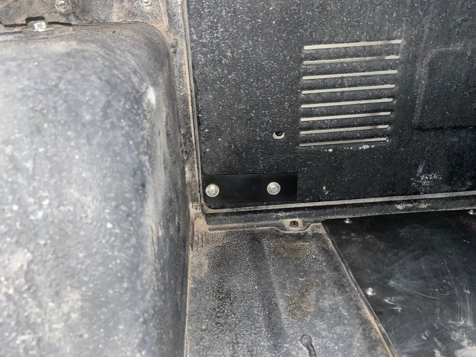

My solution was to take a small drill bit and drill from the outside through the inside panel of the jeep. Then from the inside, I drilled an 11/32" hole through the inner tailgate panel. I took a piece of 2" flat stock, approximately 6" long and drilled two 11/32" holes to line up with the tailgate bolt holes. I then ran the two bolts from the inside to the outside and put nuts on the hinge side.
If the top two nutplates ever give out, I think I'll take an entire piece of plate steel that covers the entire area between the lower two and upper two nutplates.
If someone else has a better solution, I'd also like to see it.

I ran into this problem with the bottom two. Here is a pic of basically what is inside the tailgate. (This isn't the exact part but very similar) There is one for the bottom two bolts and one for the top two bolts.View attachment 218633
Thanks for the reply, but I'm not understanding your process. Did you drill from the outside thru the nut hole and the interior plate all the way to the interior skin of the tailgate?
Correct. I used a small drill bit to drill from the outside, through the center of the nut plate, and drilled a small hole through the interior tail gate panel. Then I used an 11/32 bit and using the small hole in the interior panel as a pilot hole, drilled the 11/32 hole into the interior panel. I did that for both bottom locations. Then I ran longer bolts from the inside of the jeep, through the nut plate and the out of the outer tailgate skin. I then mounted the lower hinge on the two bolts sticking out and put lock nuts on them.
