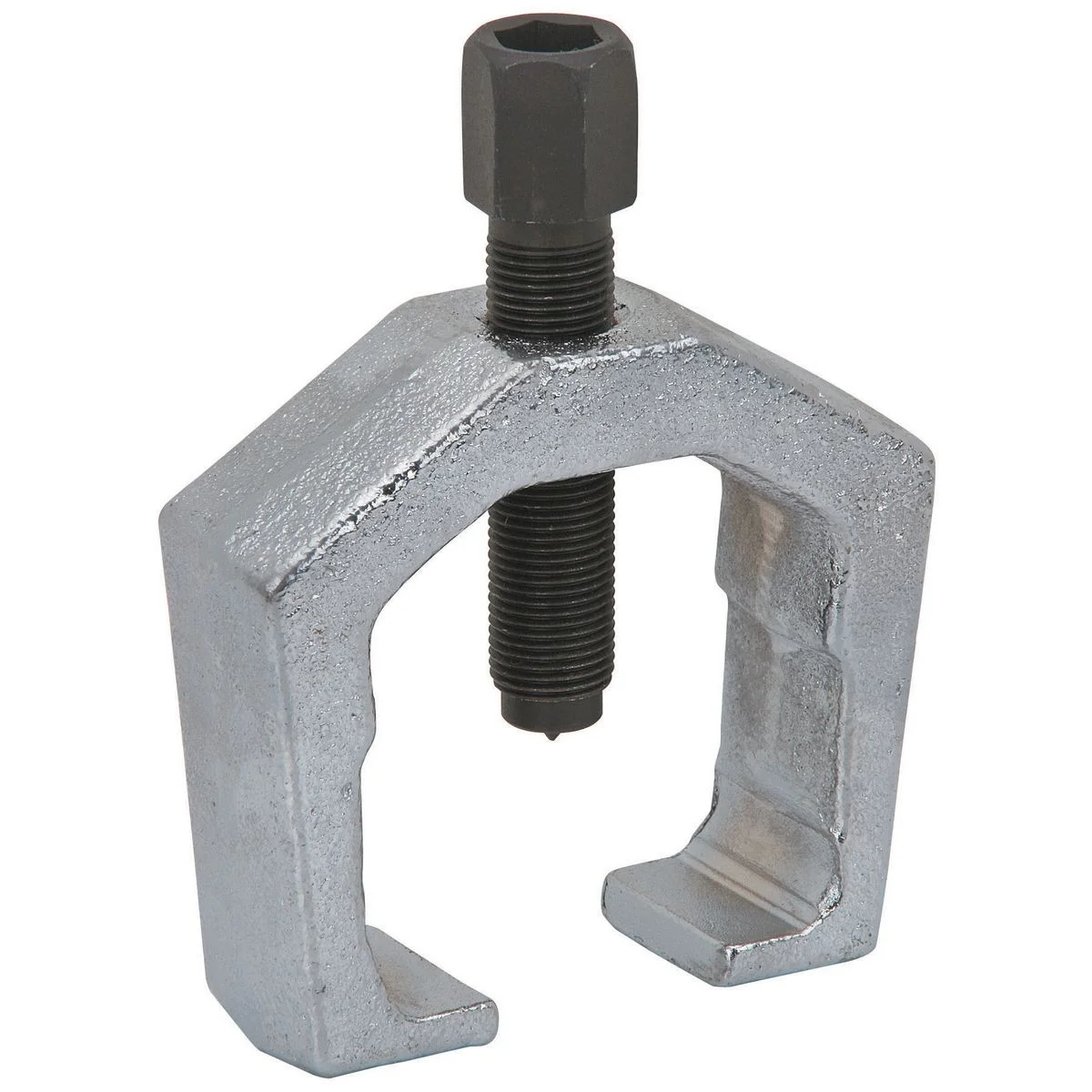

that would fit more easily in the space for sure. I hadn't seen one like that before.
The one I broke was this style. I turned the steering to get space for it above the joint but there's still not much room for a wrench. Enough to break it though I guess. I think I weakened it trying to pull a pitman arm last year 'cause I've given it way more in the past than I did yesterday. Had it for 20 years.

I have and use that other one. It isn't that great for the really stuck ones and not great at all if you plan on reusing the end.

I bought your type first and broke it too. The other option is surprisingly good quality for HF
If you tap the end with a hammer as you tighten, it works much better. I destroyed a sway bar link at first but after using the tap method it’s been perfect.

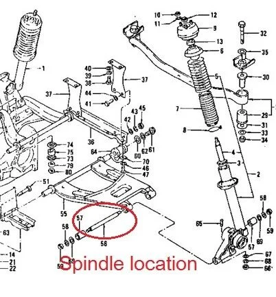

I learned that lesson getting the spindle pin out of the rear suspension on a Datsun in 2002. Imagine a LCA bolt that's 8" long and twice the diameter and in addition to effectively welding itself inside a bushing sleeve it's in TWO bushing sleeves AND the iron spindle. I spent the better part of a day beating it to hell before I finally got it moving and destroyed a 3/8" extension getting it the rest of the way out. Oh, and it's $50.
On the other side I got smart and rigged up some nuts and sockets into a puller, but I had already demolished the first one with every ounce of power my 150lb 18 year old frame could put behind a full size 10lb sledge so brute force was my only option.
