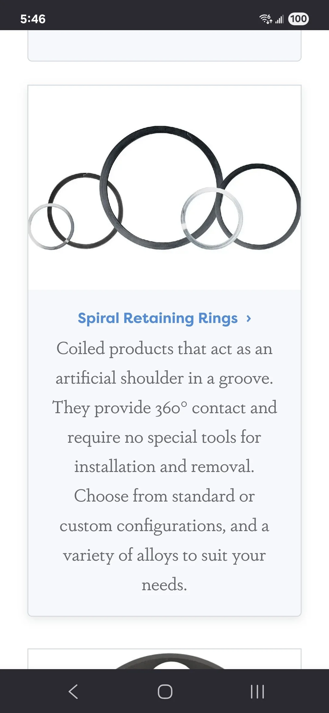

But, in looking at the videos explaining how to use the field tool to remove/replace the flex joints, they don't seem to match my joints. I don't have any snap rings. See below. How do I remove these?
Reactions: Unique Username
Thanks @TimV - I wonder if they can be replaced with the snap-rings that come standard in the TeraFlex rebuild kits now? I might just swap out the whole end for a Johnny Joint as they seem to be much better regarded than TF's joints.
Strictly my opinion here: the spiral retaining ring has better holding power, just due to 360 degree lip it creates. I've not yet encountered one of these failing, vs typical snap rings that I've seen overpowered to failure. The spiral ring can be removed/installed with a simple flat screwdriver. The typical snap ring removal without a proper tool has made me very unhappy.

I remember I ended up messing with the Feild tool. Ended up buying a shop press and using pieces of the kit with the press to unload the pressure of the bushing to pry and pop out that ring. Used the snap rings from the kit on the damaged ones.
