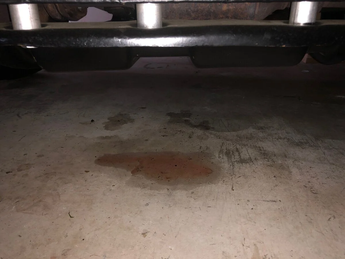

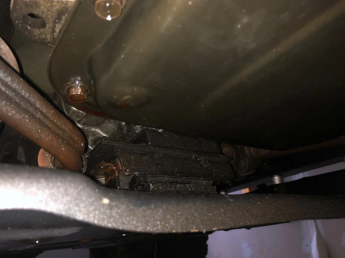

Thanks for the replies gentlemen. I took some quick pics to show what's happening if you can let me know what you think. There is 1 large spot and 1 smaller spot that both appear to align with the rear of the pan. I can't imagine a dealership getting this wrong 2 times in a row but I guess anything is possible.

Since this was the third leak within 4 years, they paid for the new pan and I paid for the labor plus the RMS work. Got the Jeep back about 2 weeks ago to find that the pan is immediately still leaking in the exact same spot. All of the bolt heads appear to be wet with the rear bolts being the worse. I can clearly see seepage although it does appear to be improved as the puddle below is not growing quite as fast.
At this point, I just got under the Jeep and torqued the bolt heads down by hand and was able to move each about a quarter turn (just guessing but I did not force it and did not need to for it to move). It looks like each was torqued about the same amount just judging by hand which I am assuming was to spec. This seems to improve things although I am still getting some seepage that is hitting the floor. This morning, I got under it again and torqued each bolt even a little more to see if it stops.
The dealer is using the same black gasket that was on the last time and I remember originally having a red colored gasket which could have been gasket sealer but that also ended up leaking although not immediately as with the black gasket. There does not appear to be any sealer used with the last two applications. It is possible that the factory torque spec is not enough to properly seal or does anyone think I should take it back and ask the dealer to install with as much sealant as they think would need to address this once and for all?
