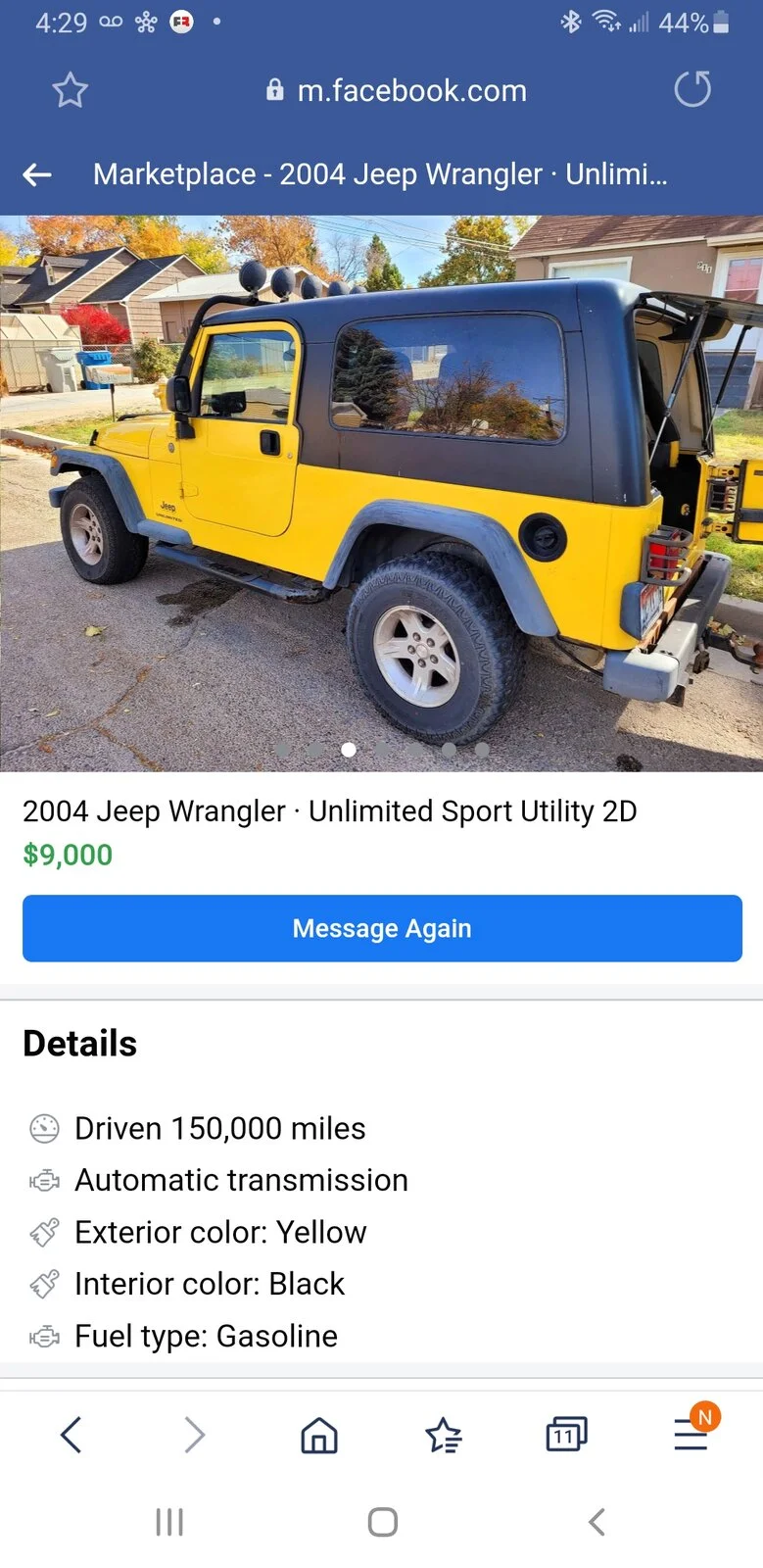

It all started back in October. I was bored, working from home, not looking forward to a winter stuck at the house with no projects to keep me busy. Anyway, it was a slow day at work when I came across a yellow 2004 LJ for $9,000. For Idaho that's a steal, most go for at least $14,000 or more depending on the shape.

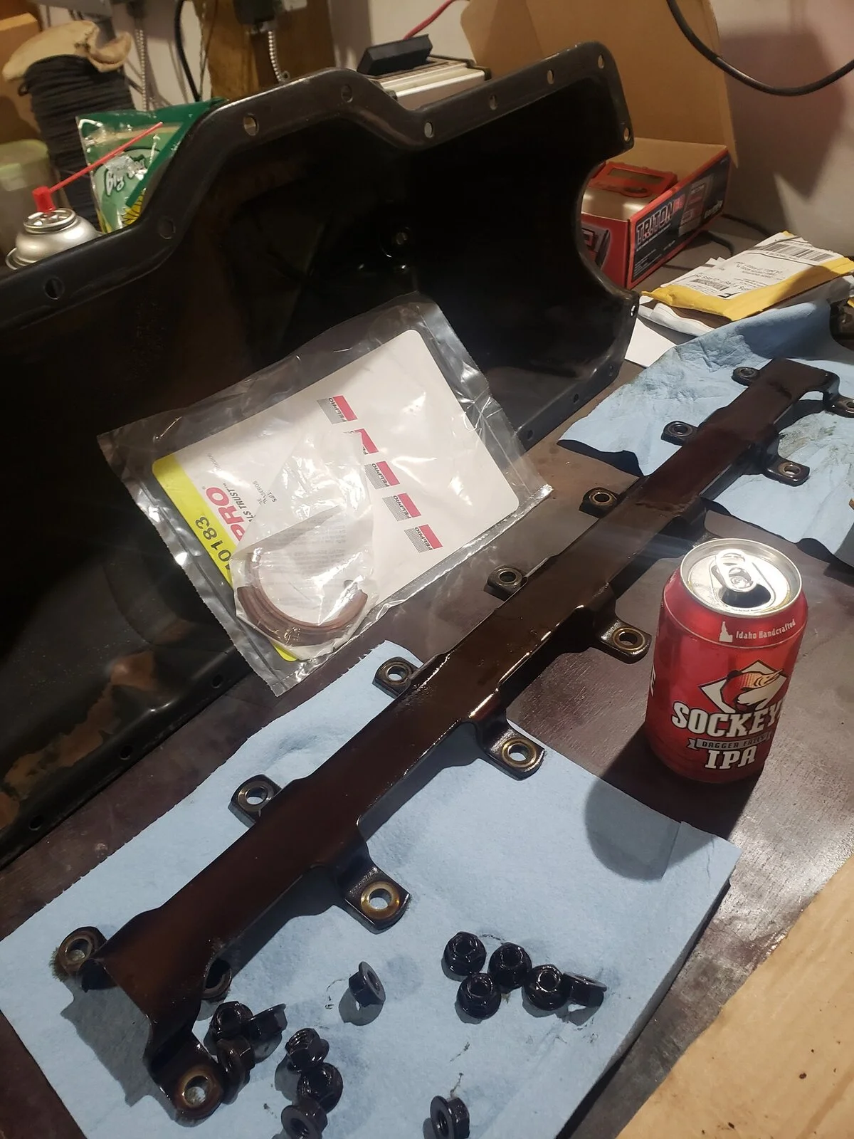

Got the jeep home, took a couple of pictures of it with Hailee, and pulled it in the garage to do a deep dive. Here's the punch list. I keep track of all of this on a whiteboard in my shop, I add things to it as they come up.

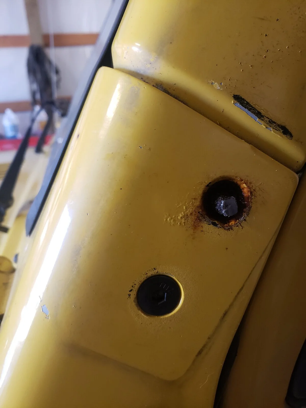

  • Fix broken bolt from removing light bar

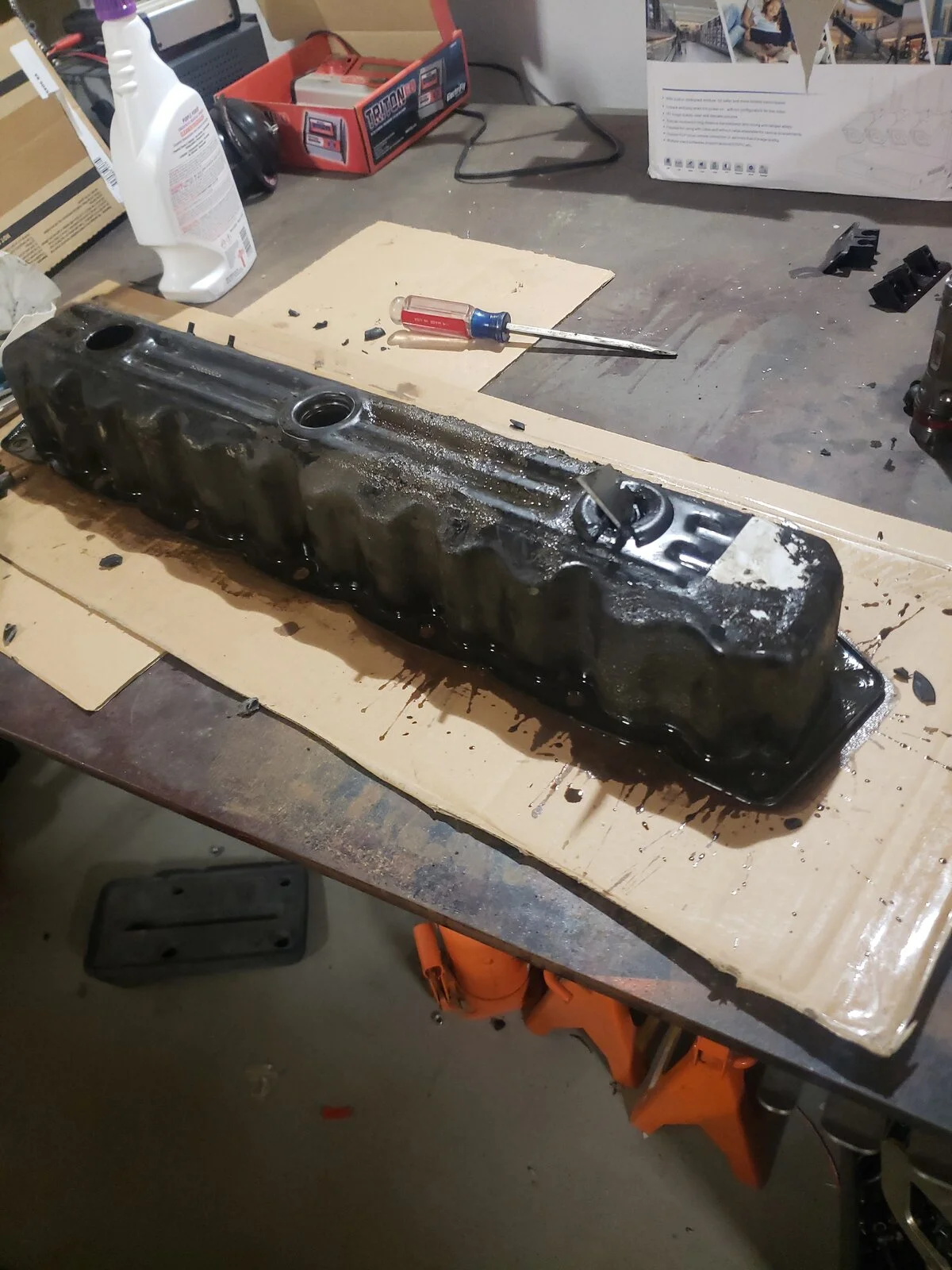

  • Valve cover gasket and all that goes along with that
  • Oil pan
  • Rear main seal
