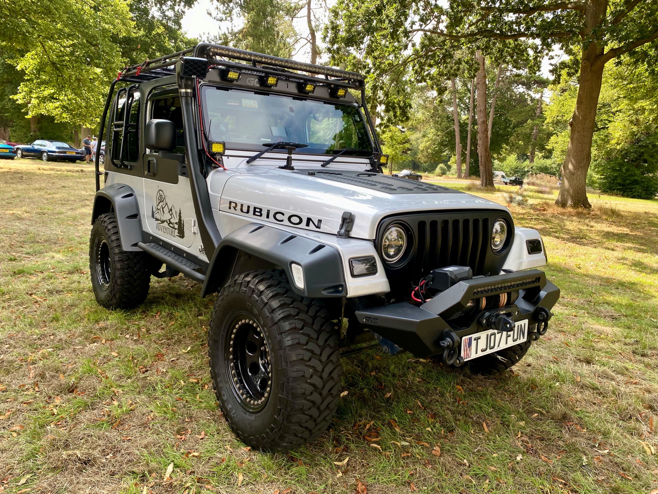

Hi all, I’m new to Jeeps. I’ve recently purchased a 2006 Jeep TJ 4 speed auto. 100,000 miles. Recent Reconditioned auto box. 2.5 inch suspension lift and 1inch body lift. 33” wheels / Tires (brand new Comforser at 25 psi). Yoke slip eliminator on it too. Also regeared for the 33” tires. Is well sorted for overland trips.
Issue: it’s pretty gutless and can just about cruise at 60 mph on a highway. Is this normal considering the mods. Also from about 45 mph and getting louder as speed increases is a throbbing vibration / sound that build and fades, builds and fades every second or two. Becomes too excessive at about 65 mph. Annoying and will be tiring over a distance. Any clues please. Thanks.

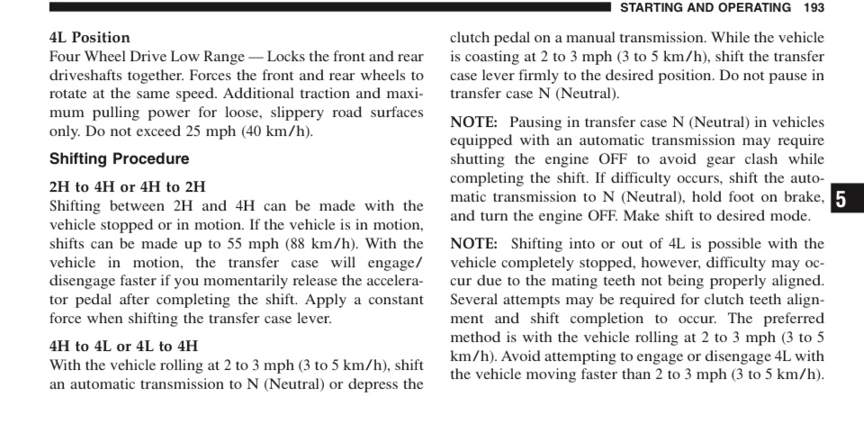

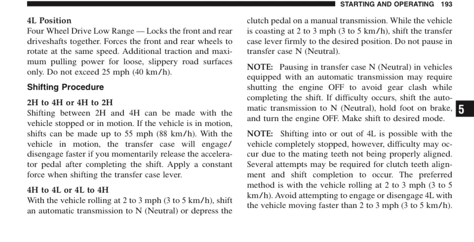

Don’t shift into 4H at speeds exceeding 45mph
Reactions: TheBoogieman
As long as you have factory style hubs, you can shift at any legal speed. There is no wear on the transfer case in doing so unless you are currently on a curve or spinning the rear tires. All parts of the transfer case are already at the same speed.
Shifting to and from 4Hi under heavy load is not recommended. No load is best, but light load is also fine as long as the tires aren't slipping.
The caveat would be if you have YJ-style hubs or aftermarket locking hubs like the Yukon ones.
I shift to and from 4Hi at 70+ very frequently. Helps a lot in heavy rain or just to minimize annoying vibrations if my airbags aren't at the right pressure...
I was wrong. The 2005 User Manual specifies shifting from 2H to 4H up to 55mph.
Of course, as you stated, the ratio doesn’t change so the gears will remain meshed together.
