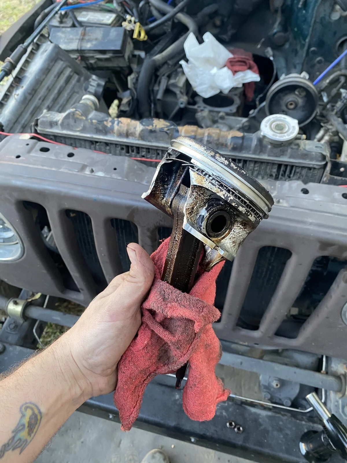

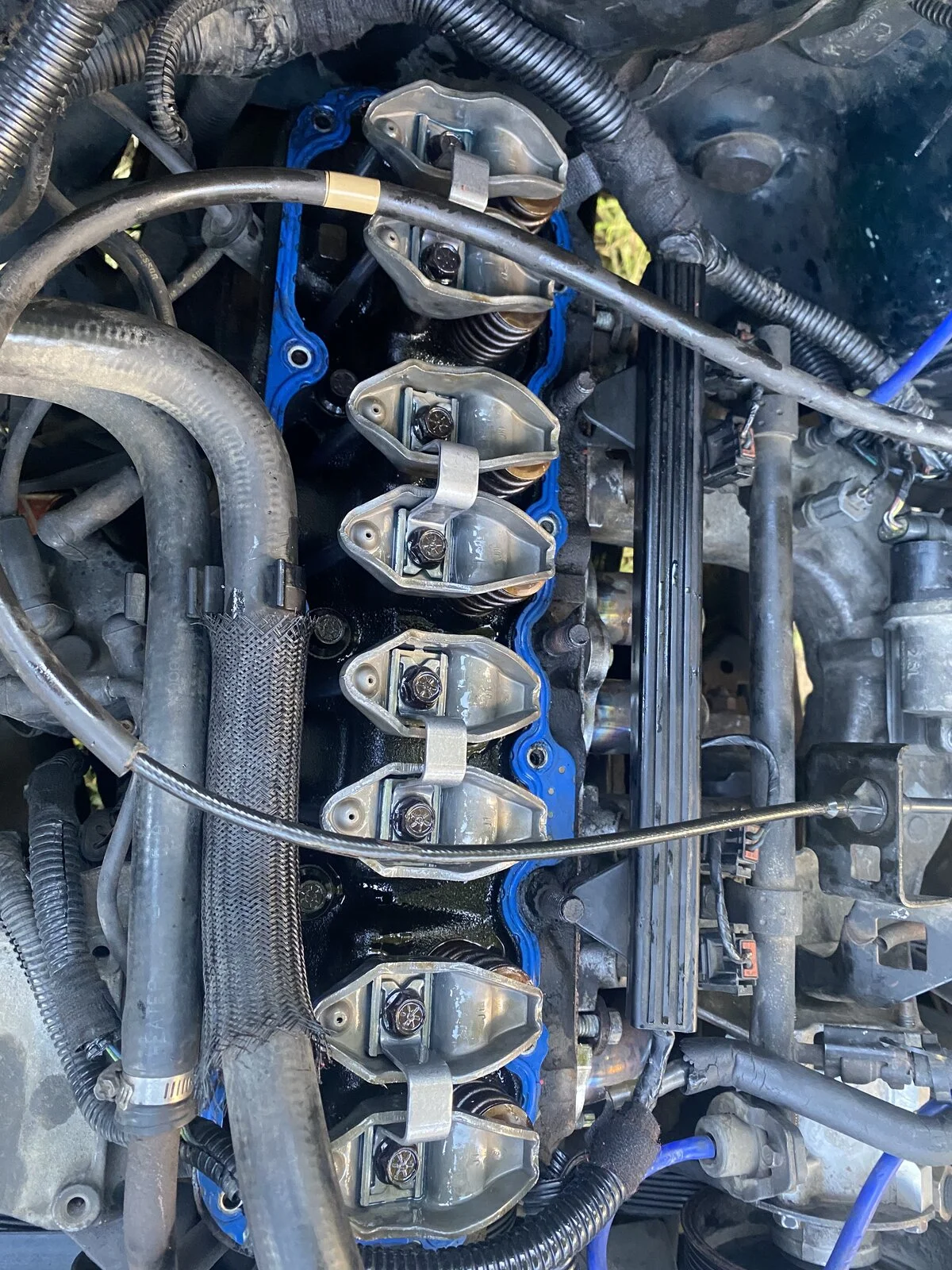

I thought I had a lifter tick too. I removed the old lifters and rockers and pushrods and installed all new. Turns out I was wrong and have a bunch of new parts for my future rebuild lol
