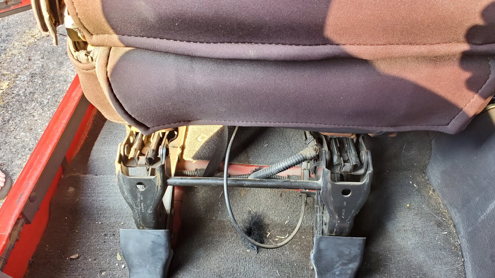

I just noticed our 01 TJ seat(s) tilt and then lift and go forward more yet. We've had about a month and just last night was the first time the drivers seat went forward like that. Passenger seat still won't, it just tilts but has same bracket it appears.
My guess is it hasn't been done in ages and is just sticky. I tried lifting on the bar to no avail and sprayed some white grease on the joint to try to brake it loose. Thought about using PB blaster, but it smells Soooo bad and it's my daughter's and she won't want that smell.
Any insight here?

The tab is there. Not a strap. The back tilts forward, the bottom slides forward, but doesn't lift.
Driver seat
Passenger seat
They are the same, right?
to get my passenger seat to tumble forward there is a second lever under the seat you have to press down other than the one that lets you adjust how far forward it is
