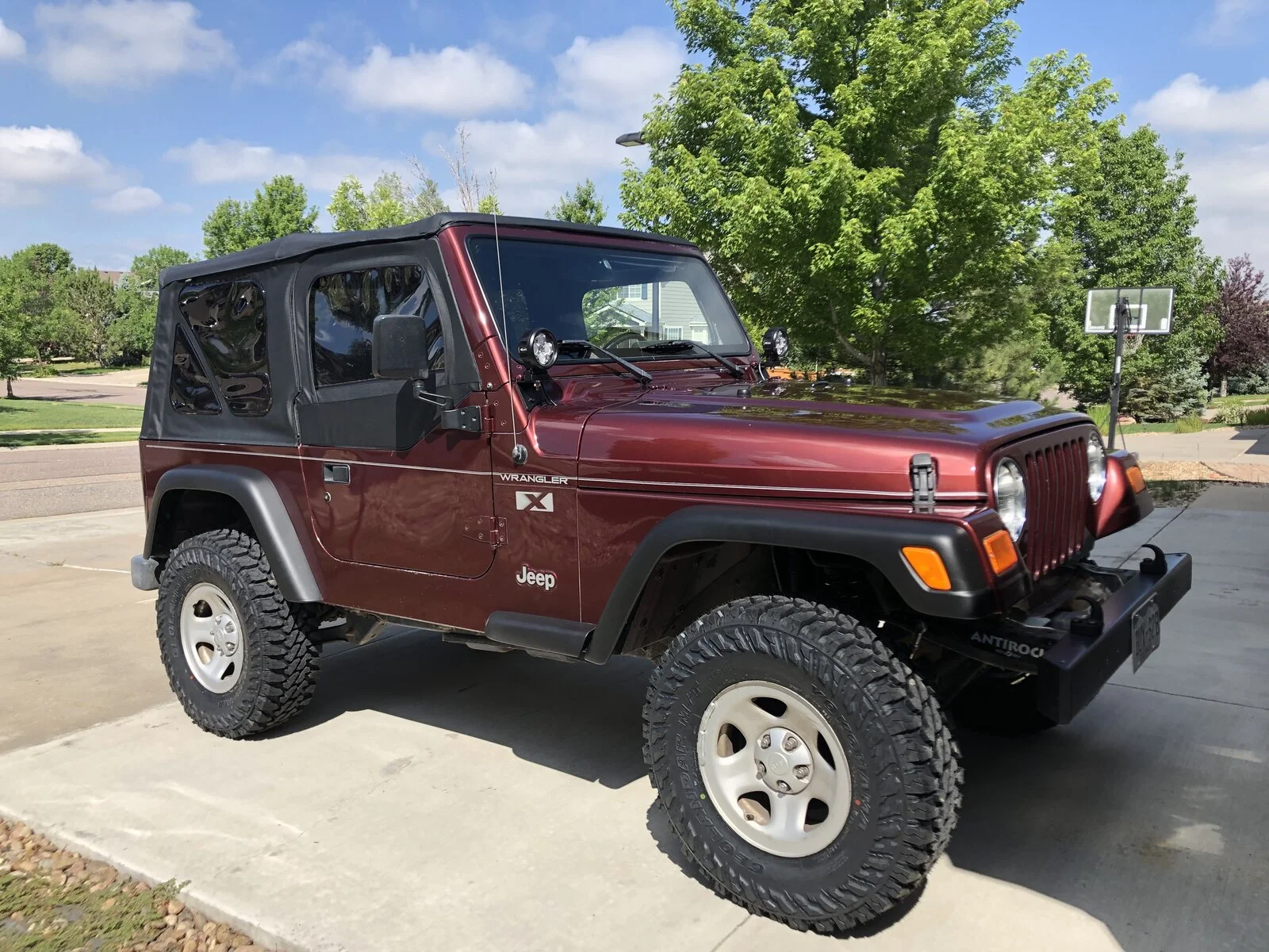

That is really nice looking Jeep!
The proportions look just right. I love the fact that you kept the stock steel wheels; they look very Jeep-like and suit the simplistic nature of the "X" model.

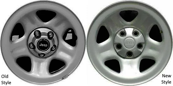

The only thing I would change on it if it were mine would be to use the earlier center caps:
Thanks for the compliments. I also prefer the old style caps, and I actually like the old style rims better too. (The have more detail in the spoke.) I tried to buy a set of the older caps, but they were in rougher shape than I wanted. I'm still keeping my eye out for a nice set of old style caps that I'll run on my new style rims.

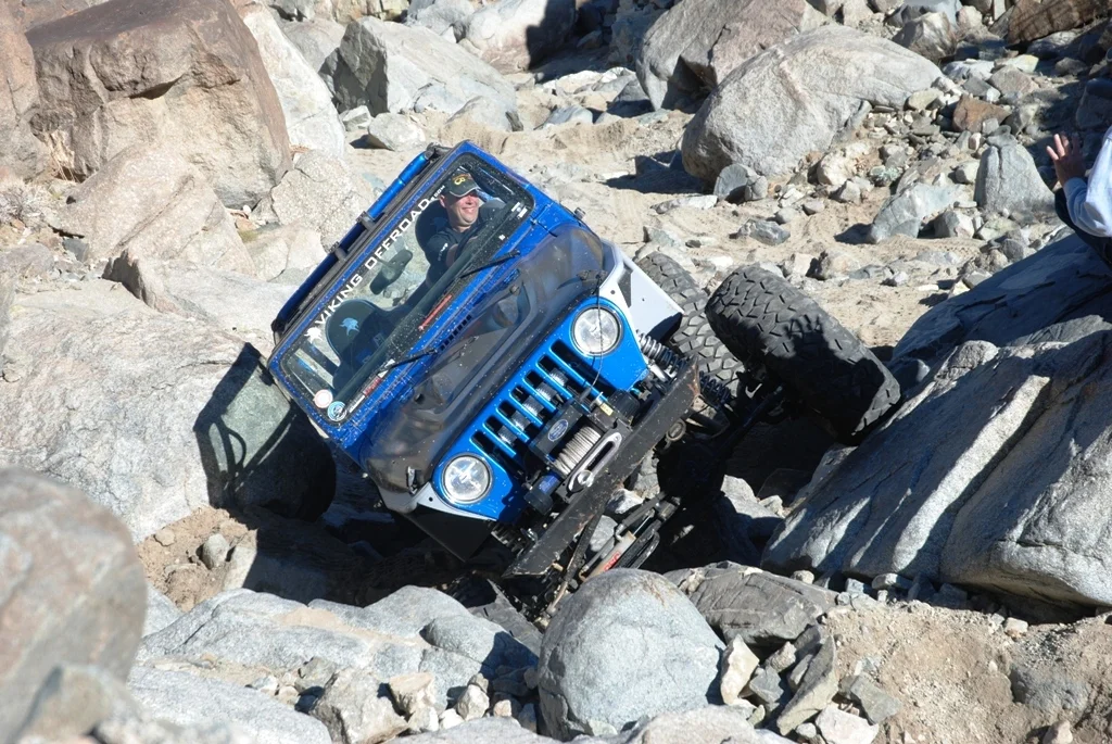

Rubicon wheels have less clearance than stock 15" wheels with 31" tires. Specifically the different offset pushes the wheel into the inner fender at steering lock. At full flex this can be an issue and is a problem with the stock Rubicon especially when you disconnect the sway bar. People have posted pretty detailed pictures of exactly where the problems are. Simply plugging numbers in a tire calculator is an easy way to cause yourself a headache.
