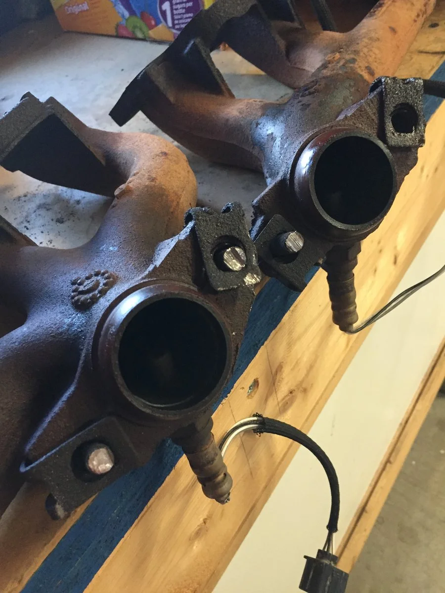

Thank you guys for the advice. I took the intake off which gave better access to the exhaust manifold and downpipe. I decided to use an electric reciprocating wrench, aka Sawzall on the flange bolts. Three were easy but I couldn’t get to the front most bolt, which just so happens to be the easiest to get to from the bottom, so I figured out a combination of extensions and a universal (3/8 as my 1/2 impact stuff wouldn’t fit) and eventually got it with the impact. Since most of the exhhaust manifold bolts were loose I took it off as well.
