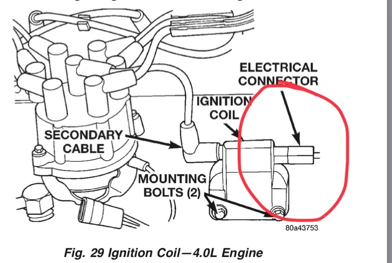

Yeah I didn’t get any spark, I’ll hook up a spark plug to the wire coming from the ignition coil next too see if there’s any power coming from there. Do you know how many volts should the connector for the ignition coil should show? Is it 5v or 12+volts?
(Update) it seems that there’s no power(voltage) in between the connector and the ignition coil.
So there is no power going to that wire that plugs into the ignition coil?
Nope, none at all. I’ve heard that there should be about 12v going through that connector. So I’m thinking my problem is between the ASD and that Ignition Coil Connector since no power is being transferred.

My issue is now solved. Ended up being a bad ignition coil. Would get spark but couldn't tell how weak. I just replaced it with a Duralast unit and started immediately.
