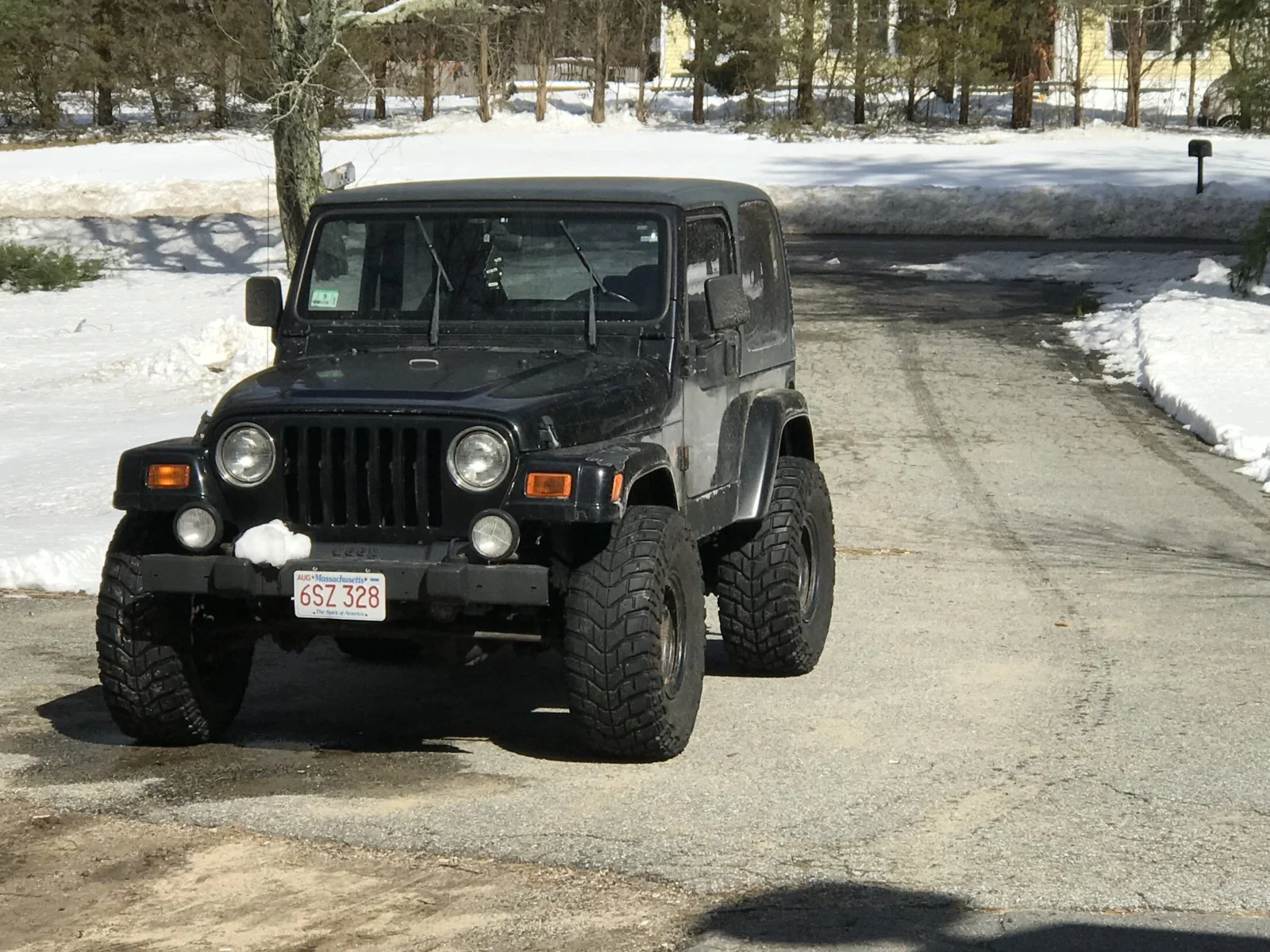

I have a 98 Tj. My kid was driving down the highway and it started acting up and died just as he was getting off the highway.
I had it towed and checked out the fuel pump only 12lbs of pressure. I replace it and now have 70. I have spark. Replaced coil and cam sensor. Still won’t start. Anyone else have any issues like this? Any advice would be greatly appreciated.
