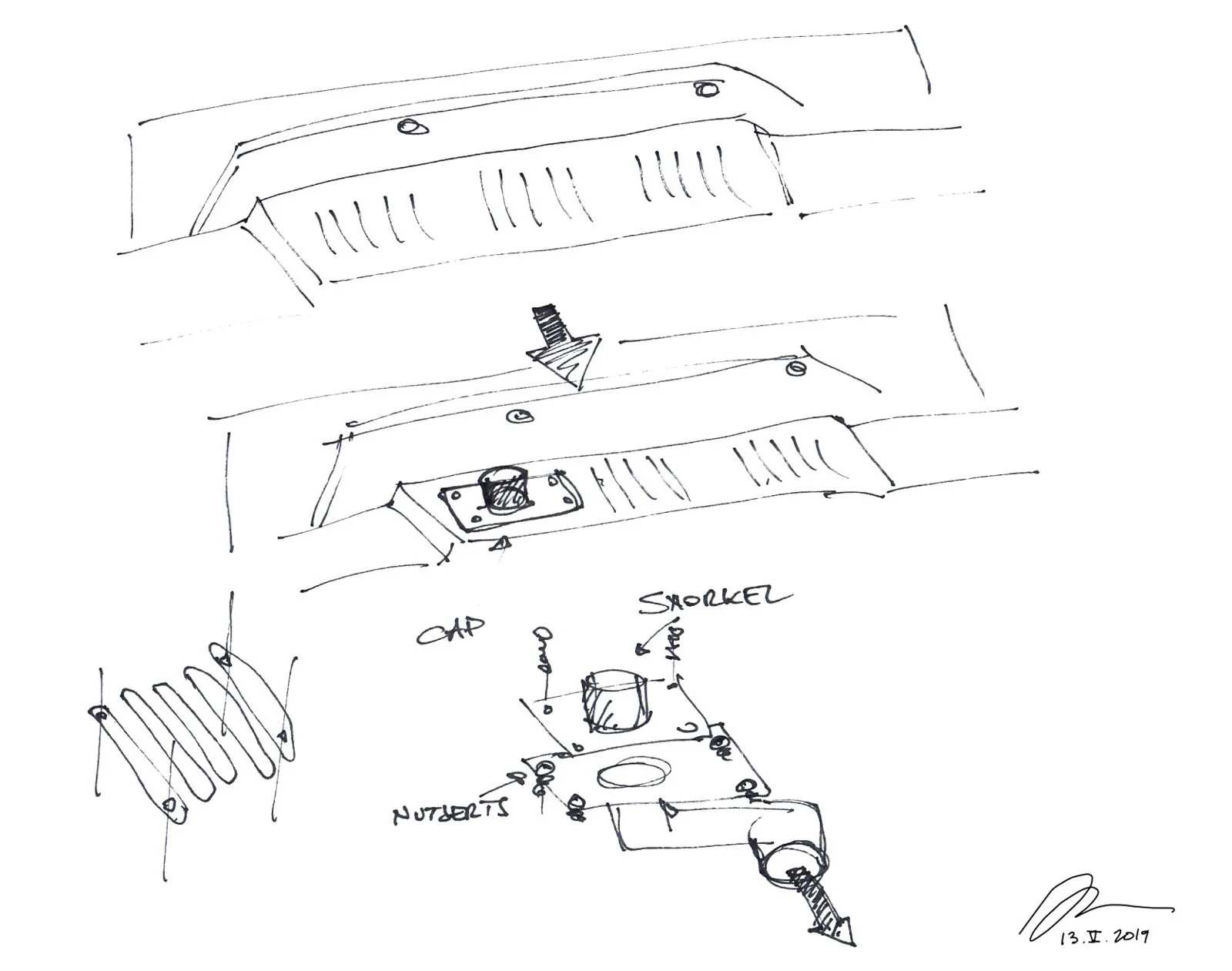

The install is primarily to filter desert dust and, as a bonus, get cooler air to the engine ...
Instead of the usual very long snorkel route that also routes by the exhaust manifold, thereby canceling out the cooler air charge ... and possibly melting the hose ...
I will probably go the cowl intake route and feed directly into the stock airbox.
I may have found a way to not destroy the cowl in the process. Will have to wait on the car to test the theory, mainly that I have enough depth under the cowl ... only destructive thing to do would be the hole through the firewall.
93532
This is just a rough concept sketch, I would probably flare the top and bottom plates of the sandwich to pass more air ...

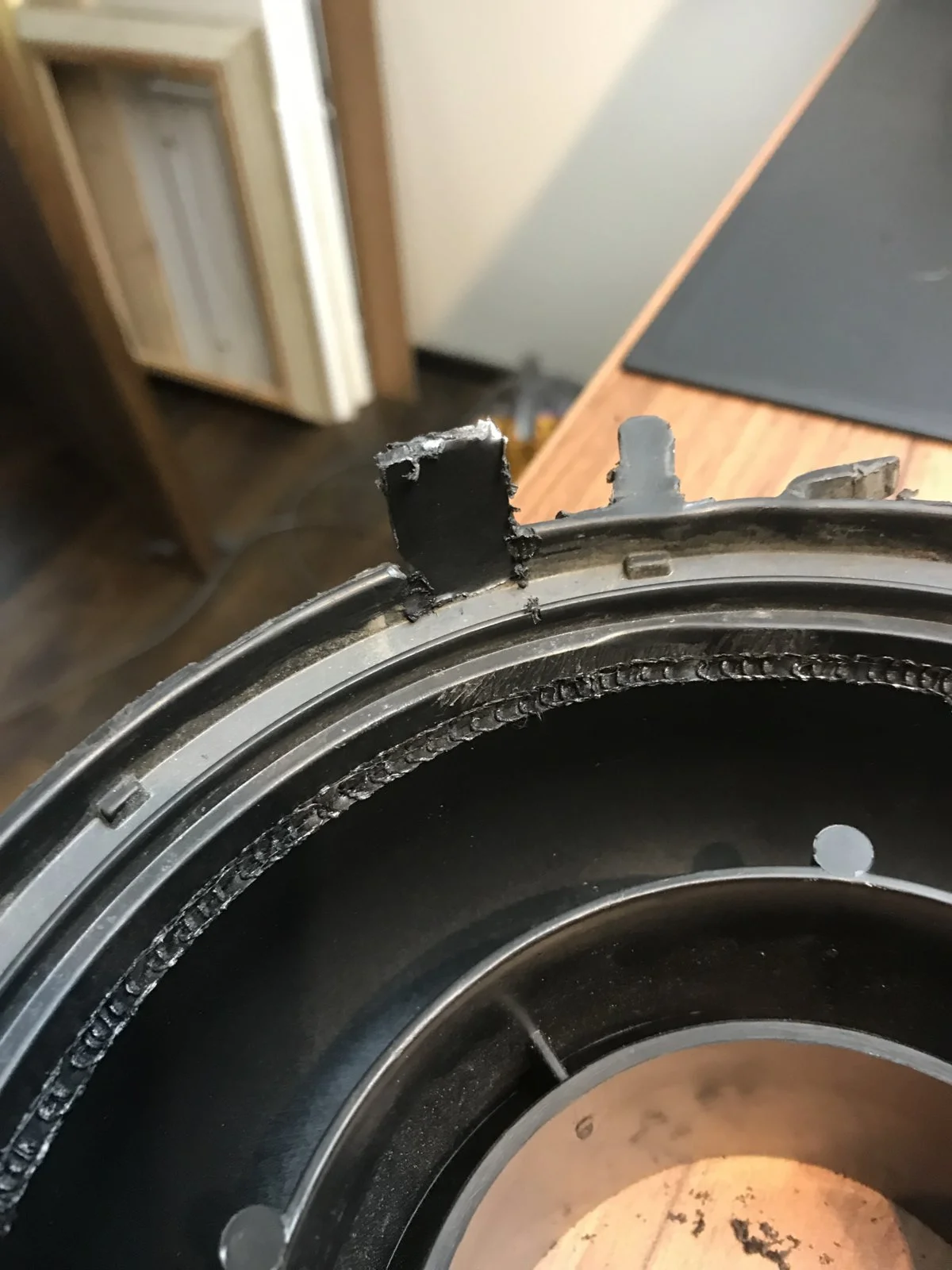

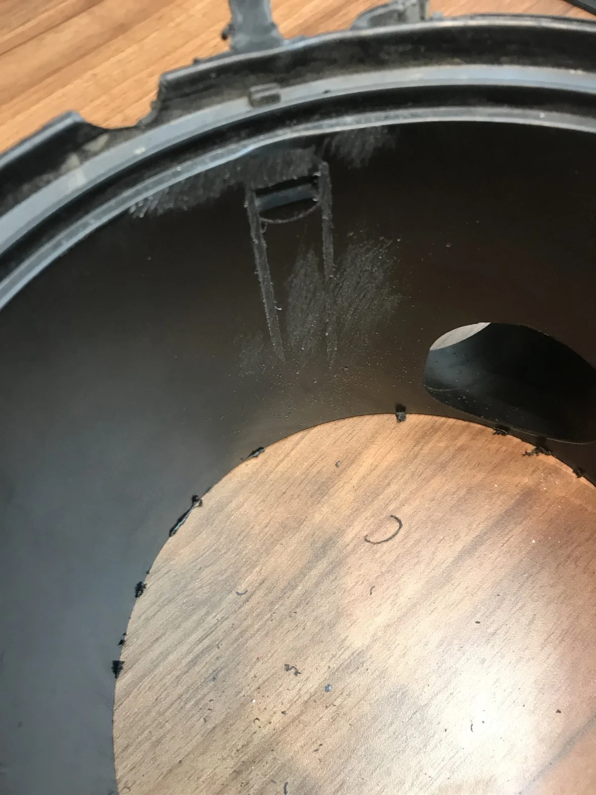

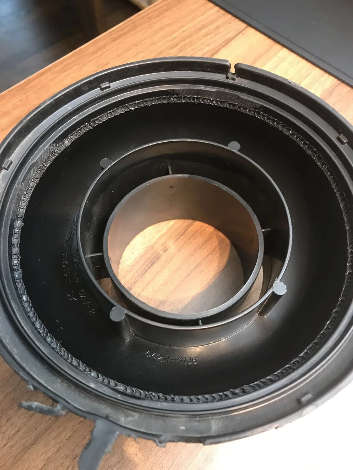

Finally received the air box and started the modification. I opted to plastic weld mine up ... my old cheapo 20 watt soldering iron was perfect ... not too hot to deteriorate the plastic but hot enough to melt it.
As many have done, I opted to shorten the box as the MAF portion in the factory Ford box is not needed on the Jeep.

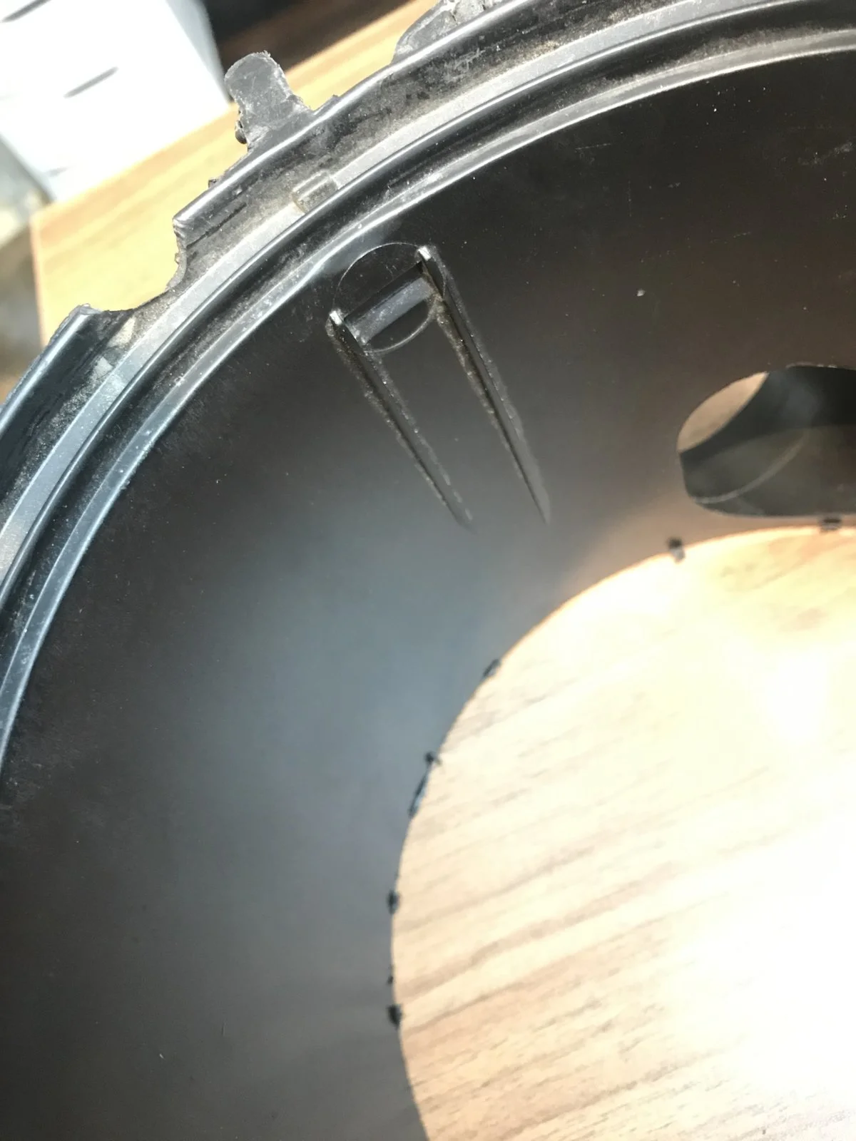

I cut both sides and "tacked" it in once I was happy with the height. I did grind the tabs that were previously used to click the old MAF unit in place.

As you can see above, I had a small broken piece on the outer lip but that was easily fixed with a bit of plastic ... and some smoothing ...

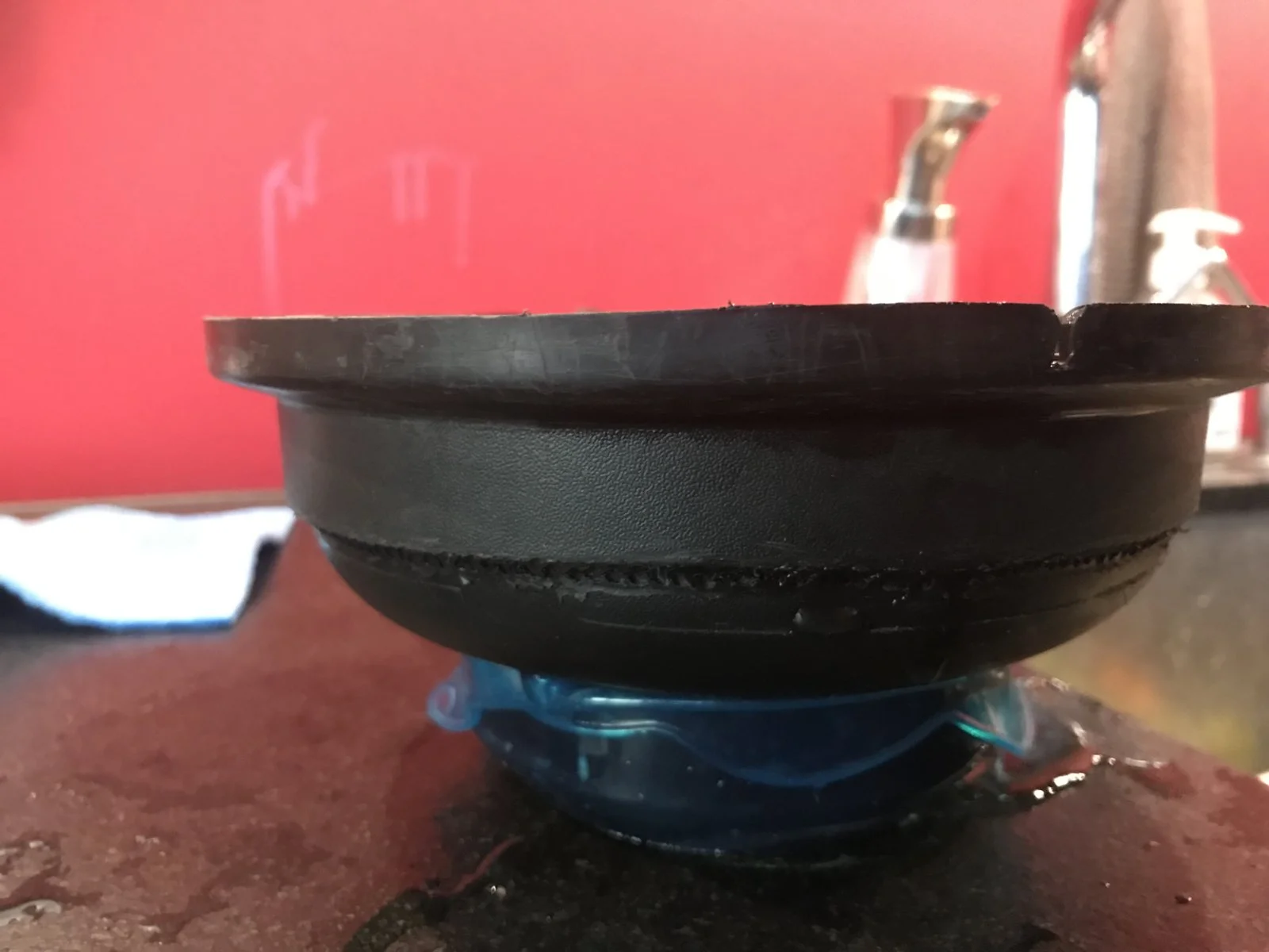

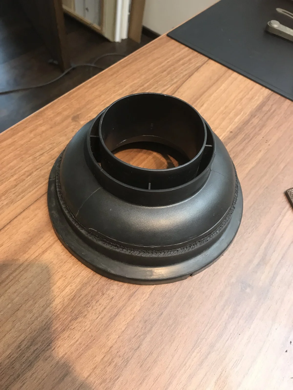

Here is the lower part after "welding"
96243
96244
... testing for leaks ...

I opted to leave the drain hole in the filterbox ... I may or may not fill it at a later date since the airbox is high enough for any fording we might come across. Anyone know if it creates a whistle sound? I would guess not since it came from the Ford factory like that.

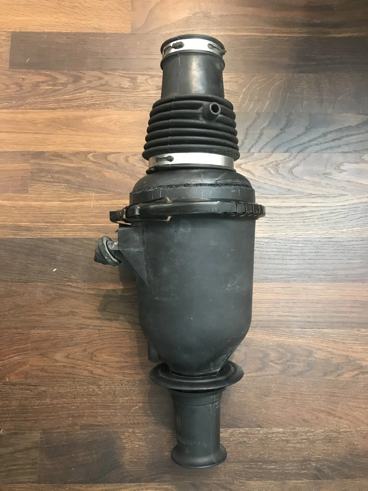

Here it is ready for action (it looks crooked in the pic but the base is perfectly square)
I will see if there is a way to use the rubber tabs/feet .. perhaps relocating them somewhere ...
96249
Next step will be to place the entire unit in the engine bay and decide if I go with a 90deg 4" with the windstar's bellow (and plug the hole) or, like most have done, get a 4" to 3" silicone elbow ... the deciding factor will be ease of maintenance during the raid.

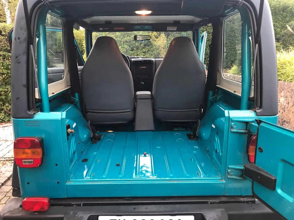

We gutted the interior carpeting and all rear bench and seat belts assemblies. We will create some kind of shelf/platform there.

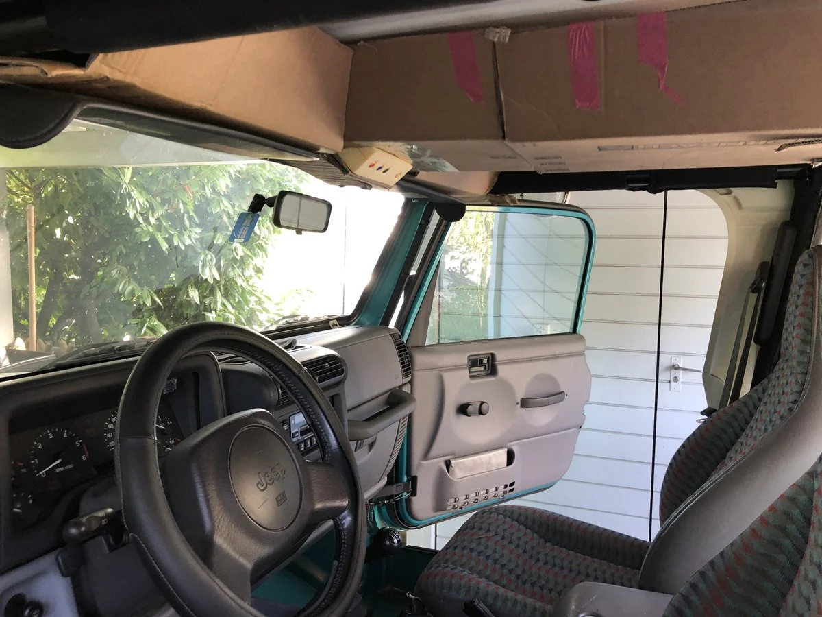

Also mocked up a cardboard overhead console to give more storage and house the compulsory IRITRACK system.
Will have to check with helmets for the exact size but it is pretty close ... and decide what material to build it out of.
The other question will be ... do I secure solely from the roll bars and windshield or do I secure it instead/also to the hardtop itself. Anyone built something similar? If so, what material did you end up using?

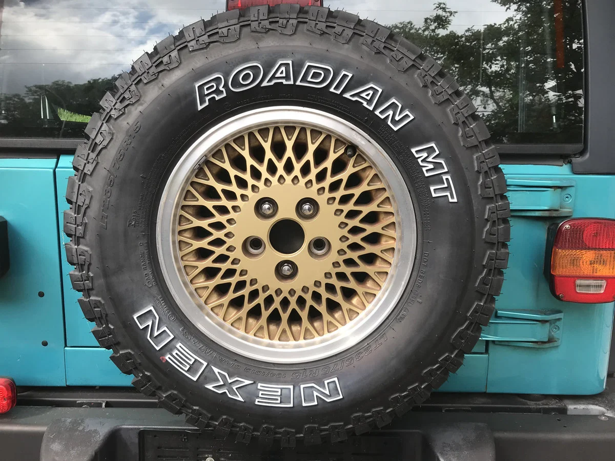

I was just trying to find the right balance between rim vs tire weight and sidewall height to get the lightest combo possible. I'd have to check the tire weight specs.
Consider sticking with a 15 inch wheels & tire setup as they tend to be lighter. I'm no expert but I have done a little research trying to reduce unsprung weight on my TJ and the reps I've spoken to tell me, 15" tires are constructed with lighter compounds that flex more at higher pressures than a 16" or 17".
Thank you Wombat,
We came to the same conclusion. 15" is the size we have settled on with and we may actually stick with the current 235/75 15" (~28-7/8") NEXEN MT tires ... they are supposedly also descent in the sand ... and we can always swap at the last minute.
The rims may have to go as I am not sure how well they would fare in a rally ... anyone know if they are worth anything in terms of strength?
