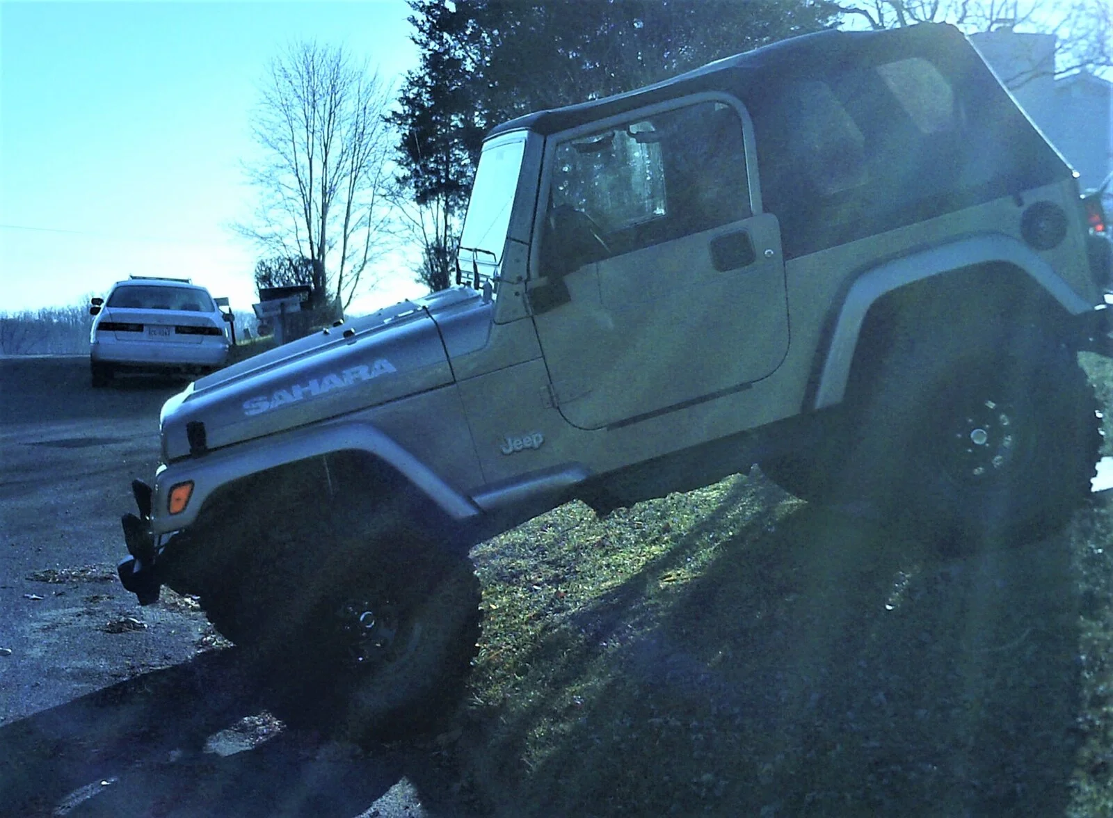

I would never add that. I used to do this to fill it properly.
He is talking about the Dexron mercon transmission fluid I believe... Adding like a cup but it's pretty weird but I'm just wondering about the value of overfilling the differential for an upward pointed pinion.
