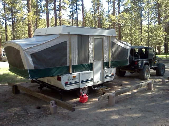

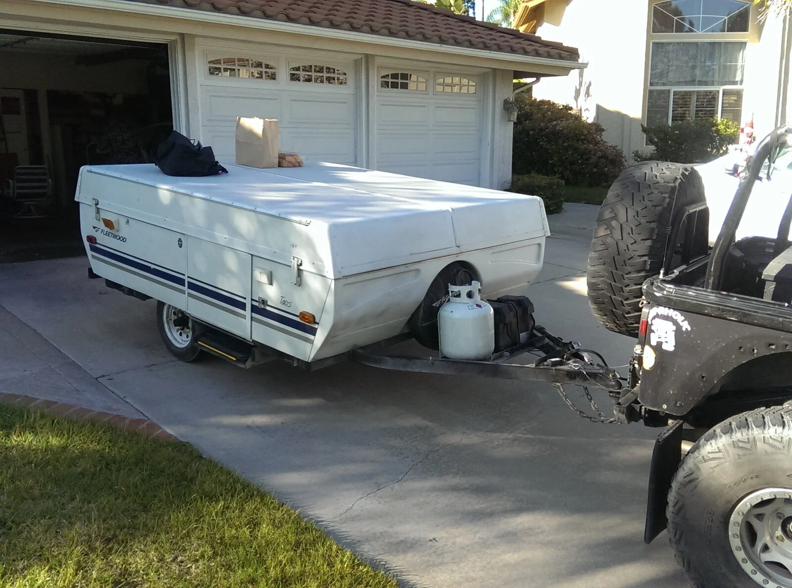

This was mine, a Fleetwood Taos, it towed really nicely. I barely knew it was back there, I kept looking in my mirror to make sure it was still there when on the highway.
Reactions: NashvilleTJ
Jerry - is it worth installing an auxiliary trans cooler to tow a pop-up?
Probably for most of us, though it depends on where it's towed. I had to regularly tow mine up and over my local mountains which would be a strain for any transmission. If it was always towed on mostly flat terrain maybe not needed.
