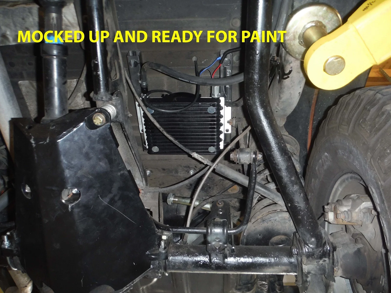

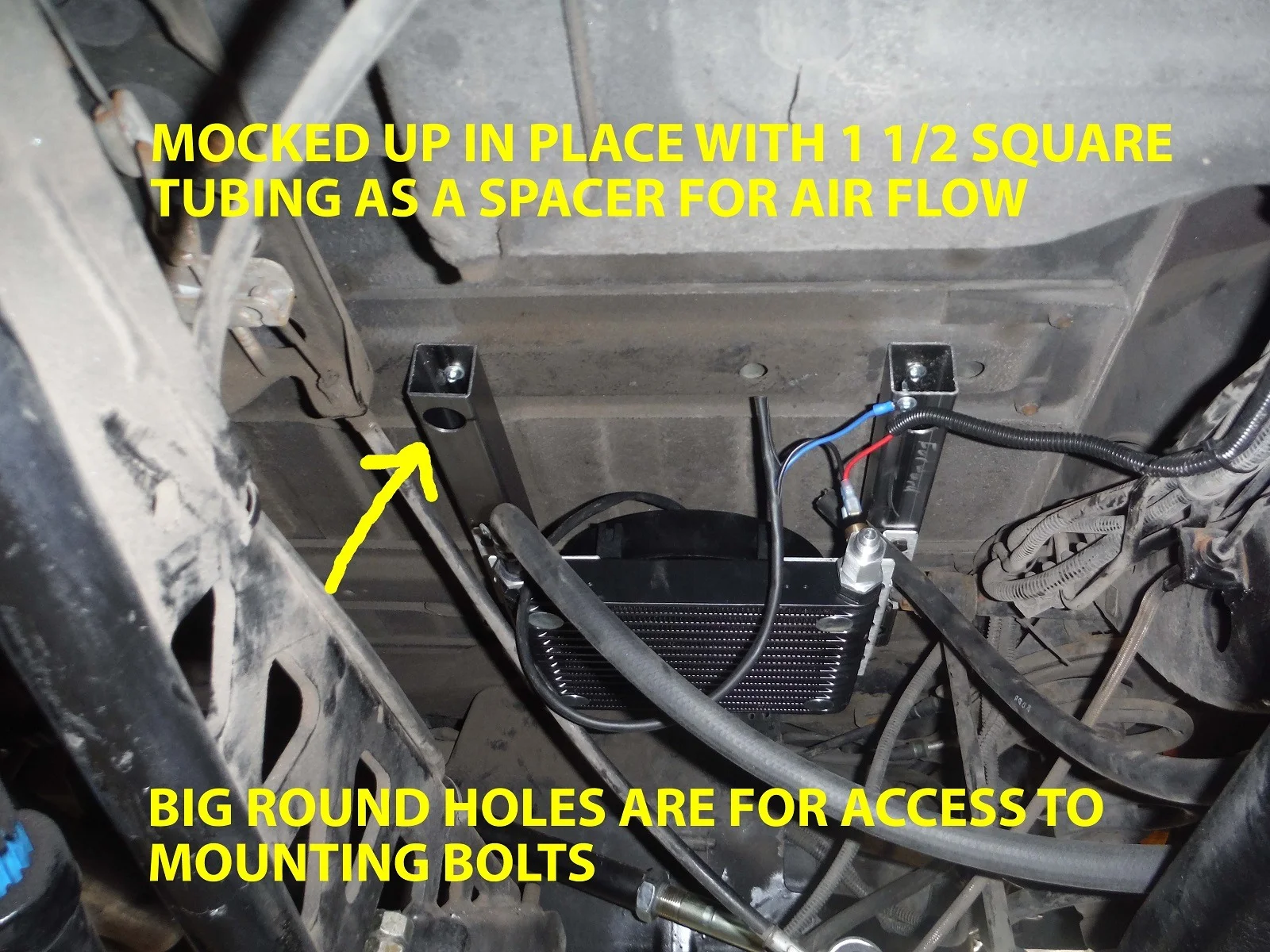

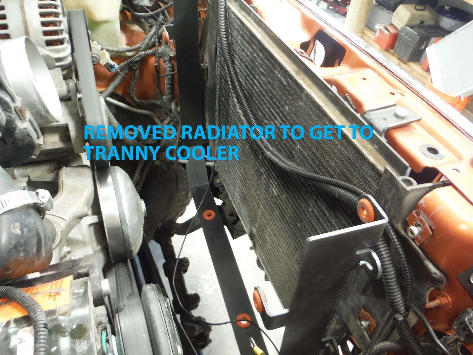

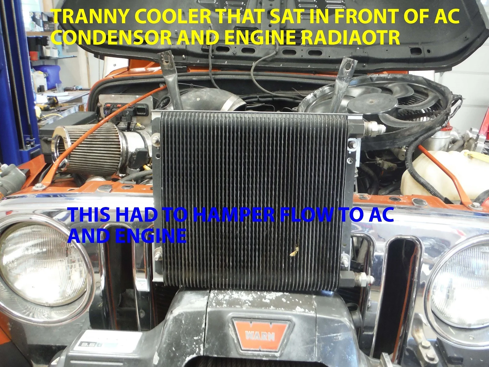

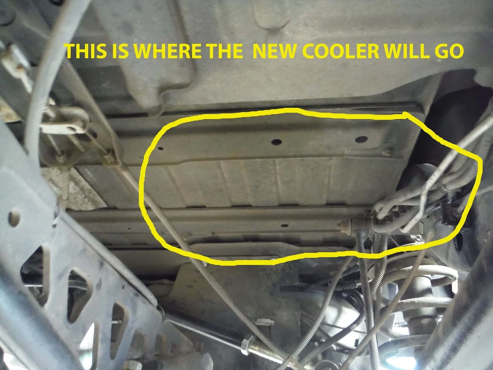

In regards to the post about Derale 20561 cooler by Jerry and others I ordered this kit. I knew from critiques on Amazon that I probably would have issues installing it on Stinger. However, I have heating issues with Stinger. Having a AC condenser and a transmission radiator in front of the main engine radiator probably does not help. So I decided to take a chance. I received the cooler/fan today and was really impressed. It had everything to complete a trouble free no problems install on a non modified TJ. On Stinger, well that's another issue. I have found a place the main items will fit and work in front of the gas tank and above the rear axles. I will follow up with photos on my install. Understand--I have a 6L90 GM transmission and a ton of other-than-stock stuff under the body so apply as it may fit your application.
