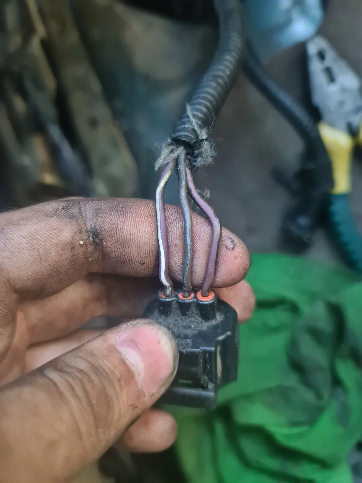

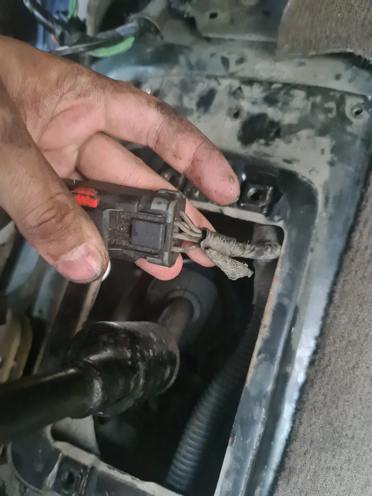

So i did all the mechanical stuff regarding to 32rh to ax15 swap. Now the only remaining thing is wiring. I am not an electrician. Know nothong about it. So here are the wires from nss and tcc. I want to start the car. Which wires should i connect to each other(splice???) Which wires should be connected to rear lights sensor on ax15?
You need a wiring diagram for both harnesses and the vehicle or else this could get time consuming and expensive 🤔

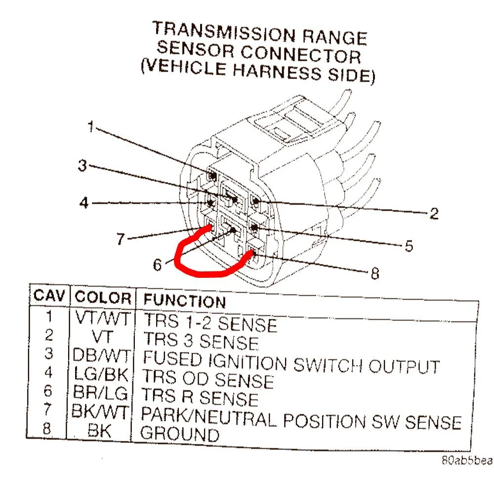

I found this image from other auto to manual swap thread from other forum. I wonder if its same with mine
