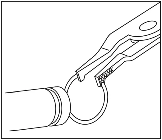

You'll need good lock ring pliers.
And a 1-1/8" socket for the yoke nuts.
If you remove the mode ring, be sure to put it back in the right way.
Yeah, I've watched a couple of videos and they all seem to be using snap ring pliers on the order of a foot long. The description of these shows 11". I may have to pick some up. My plier selection is of the "normal" 6" type. Thanks for the confirmation. Been working on motorcycles and airplanes too long :-)
