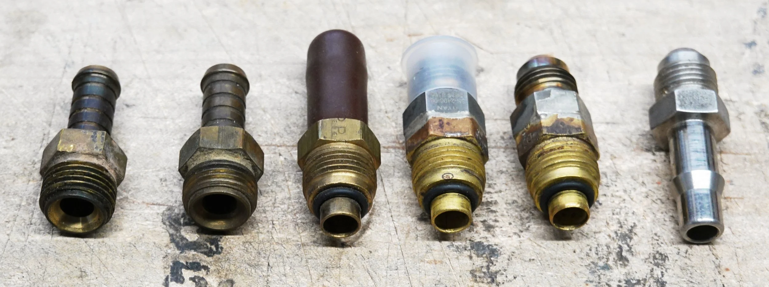

To help with future ID, the below are the 3 styles of OEM trans cooler fittings.
Inverted flare for early
Oddball inverted o-ring flare for the middle years, I've converted 2 of them to have -6 AN Male flare.
GM style quick disconnect for 05-06
