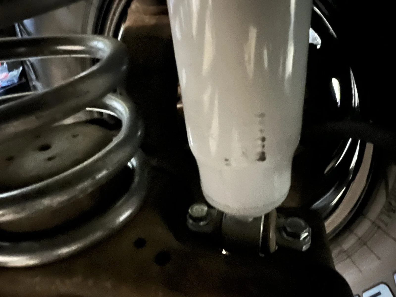

I installed these recently (well, I used the stock-height ones). Do you have a pic you can share of how the one front shock lines up fine but the other one doesn't?

Yeah, they are installed on the Ranchos. I'll post photos later after work.

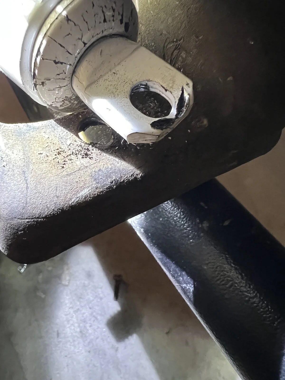

@SSTJ here are the photos. The hole is completely off from the mounting side. The other shock lined up perfectly and is currently installed on the passenger side, however I've tried it on this side and it works here as well.

Wow, so the shock that is currently mounted on your passenger side fits there perfectly, and also fit perfectly on the driver's side? If that's what you mean, then I'm afraid I have nothing to offer. I'd say it sounds like there's something wrong with the shock, but you already returned it for another.
It's hard to tell from the pic, but of course I'm tempted to say you could twist it into position, but I'm sure you've tried from every which angle already. Is the other mounting bolt already tightened down? Maybe try loosening it to get some wiggle on the other side, and then when they're both lined up tighten them at the same time?

Yep exactly, the good one fits on either side. I'm starting to question my sanity now :D The other bolt isn't tightened down but I can't seem to line them up. I just measured the old rough country shock I took off for good measure and the mounting holes are about 2 1/2 center to center. These new ones are more like 2 3/4

Ok, and did you measure the holes on the new Rancho shock that's currently on your passenger side? I think that'll be the real sanity check!
Ok I got these installed. What a pain in the rear. For others, I inverted the bottom bolts, putting the nuts on top figuring I’d rather deform the bolt and the pins rather than the body mounts.
For the top, after struggling with the spinning rod with an impact socket and an impact wrench, I had good luck with switching to a standard socket and grabbing the shock shaft with my hands and holding in place.
