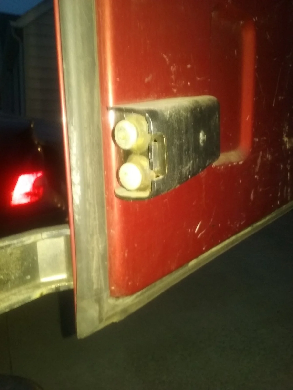

Any thoughts as to where an issue may be with the 3rd brake light not working? I've done some pretty mild searching and can't come up with anything. Other brake lights are fine, fuse is good. Changed the bulb. Nothing.
Typically it's an issue with the tailgate contacts and sometime it's just because the contacts are blocked or cruddy. Take a volt meter and test your contacts on the body side for starters. Just have someone step on the brake while holding the meter across the 2 contacts to confirm power when the brakes are applied. If you not familiar with the contacts they are located on the passenger side to the rear of the cargo area near the floor.
Sounds good. I did try to clean them with a bit of sand paper over the weekend. I'll test and see if theres any power going to them tonight though and go from there. Hopefully it's an easy fix!

My third brake light was not working either. Replced the bulb and still nothing. Checked the contacts and they looked clear, removed a bit of carpet to clear the way 100%, still nothing. Finally after reading a bit more someone said that even if the contacts appear completely clear hit them with sandpaper anyway. I did this to both sets of contacts and the light now works perfectly.
