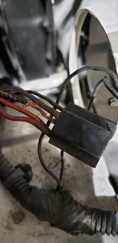

I second what @CharlesHS said. Check the existing connections. The headlight plugs are especially notorious for corroding and shorting. Literally every Jeep I've looked at or worked on had headlight harnesses that looked like this. I've seen similar things with the side marker lights.
Also, you could try unplugging everything you installed, put the old stuff back in, and see if things go back to normal. If it works, plug one item in at a time and see what changes.
